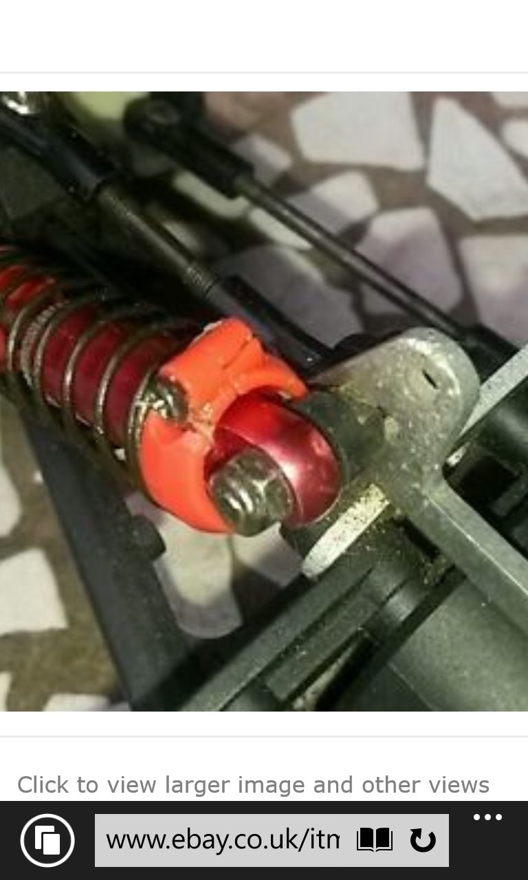

I've recently purchased an chain driven optima and was told in the description that the seals and the clips on the shocks were broken?
Does anyone know where I can replace/rep as it these shocks.

Pargu makes nice aluminum clamp collars for those shocks, but they're a bit pricey. They'll never break though. Those red plastic ones are almost always cracked, it's practically impossible to find those intact anymore.Skiddy wrote:Hi, can anyone help?
Regards
http://www.pargustore.com/kyosho-red-shock-clamp.html
You might have even more trouble finding those little clear plastic ring seals, though.

I believe the clamps from the Re-re Scorpion shocks would work as well. Those can be had either directly from Kyosho or various sellers on Ebay.
