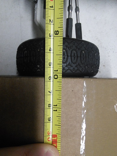

Re: The start of something new (Quadra car)
I installed B4 caster/steering blocks on my mid-quadra car. This is with the factory team 5mm clamping hex's. I set camber and toe near zero and measured the width by a crude method which was two boxes and a tape measure. It would have been prudent to measure the base quadra setup with b4 wheels first using the same method, but I forgot... and I'll have to do that when I have more time. I did check it with the tape measure after building and it was right at 250mm. The tricky thing about width is it varies slightly by wheel/tire. How did you account for this Niki?Niki wrote:I can easily make slightly shorter front arm. How much shorter you want it?
Measured B5M width: 246mm Published width: "varies"
My Rc10 Quadra w/ B4 caster/steering:257mm (7mm too wide)
Joey, you said 1/4" which is 6.35mm
I think it's safe to say it would be legal with the arms being 3.5mm shorter, making the width 7mm less. Maybe 4mm shorter to give a small margin for error and still keep near maximum width?
