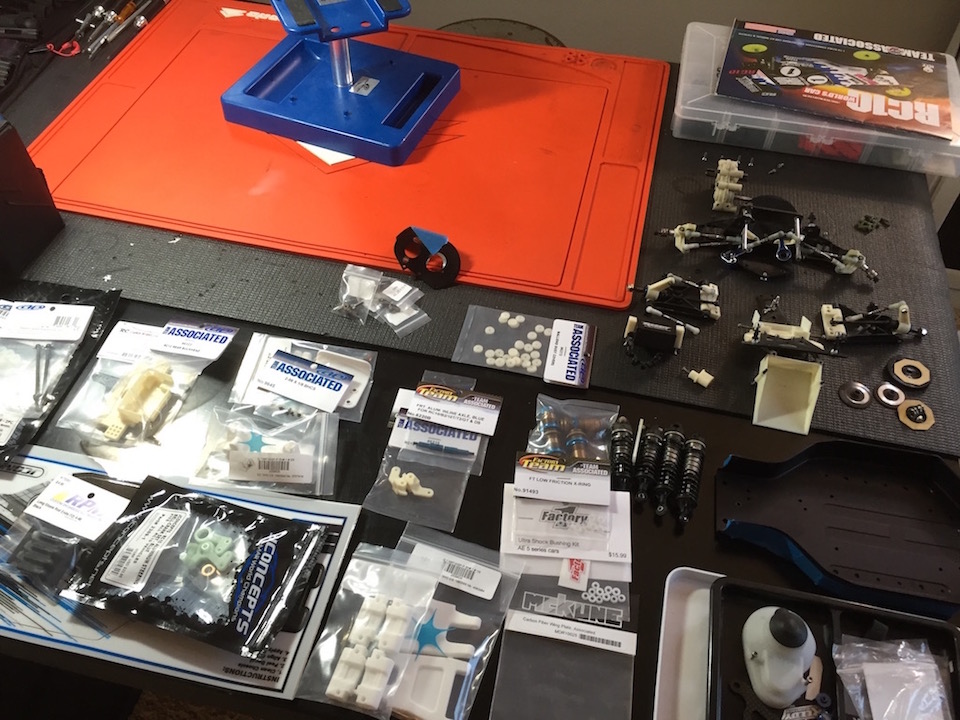

Build plans were laid out, parts were ordered, bourbons were imbibed....
Goals for this build:
- Get 10-15g under the 1499g weight limit of the 17.5 class. This would allow me to add weight where needed for final corner balancing and handling. This will be done with full ti hardware, B5 ti ballstuds, ballcups, and turnbuckles.
- Electronics will consist of Reedy servo, esc, and Schuur Speed 17.5 with a Trinity D4 1S Certified as backup. (it's ~ 20g lighter but revs like a madman. Perfect for open layouts)
- Run full Big Bore shocks from a B5MCE (Kashima)
- Increase the tunability for my local med/high bite indoor clay tracks.

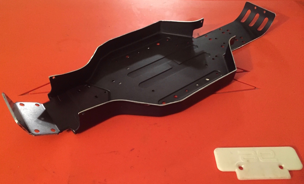

Below are pics of the parts layout on my work station and my first step... trimming the chassis.

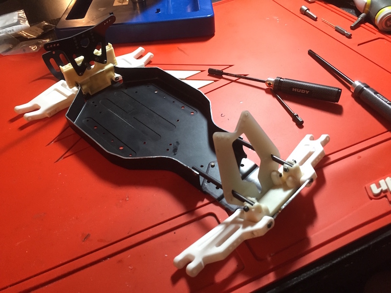

Not too much done tonight... Got the arms/bulkheads taken care of.
I was too busy playing around with this:
