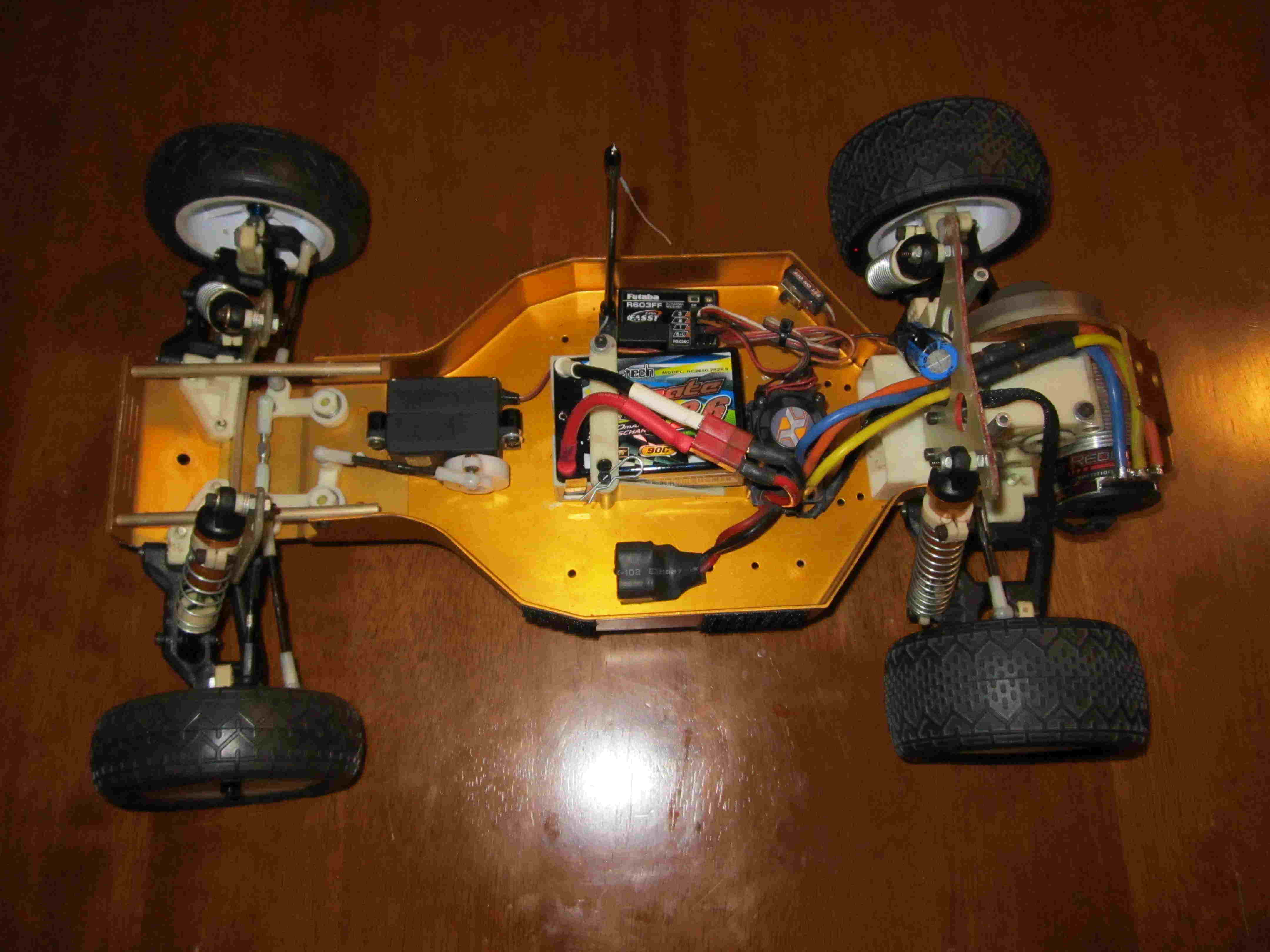

I just thought of something...... Those front wheel adapters are to convert the classic to the world specs. I'm running world style arms on mine. Probably moves them out too far.

The worlds axles are the wide gt axles . Those axles were used with the long arms to run current production B4 rims. The B4 rims have a deeper offset than the stock CE rims or B3 rims. Yes they will be to wide if your running the stock CE rims.

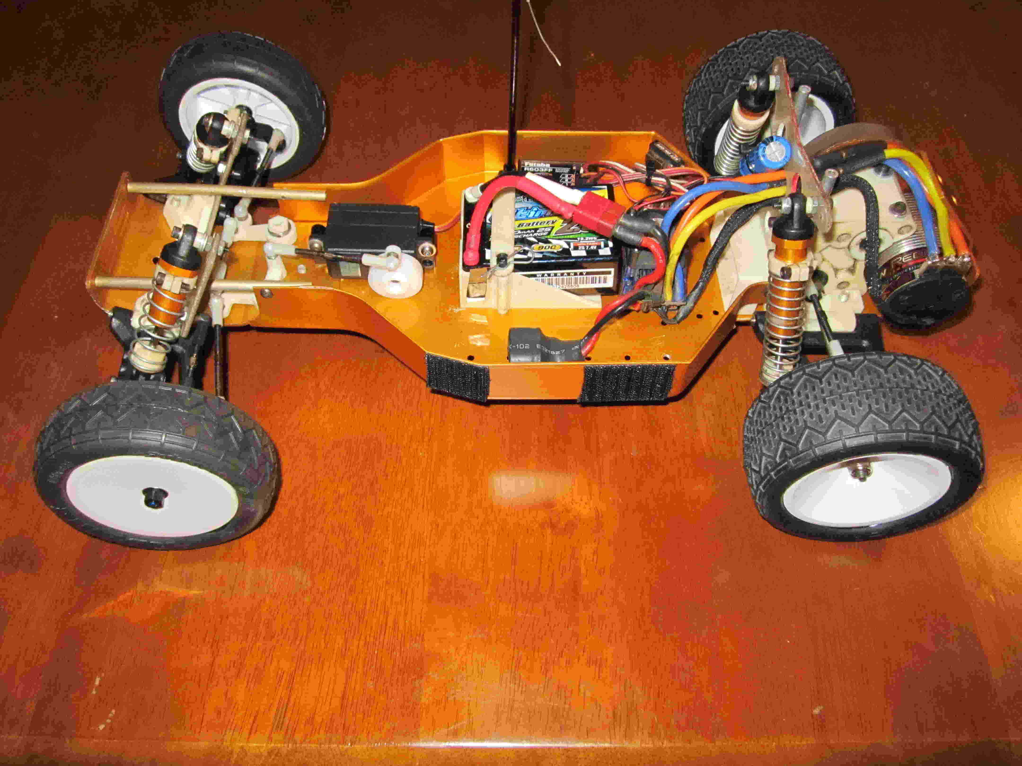

I normally set mine with drive shafts level and front arms level or just below.

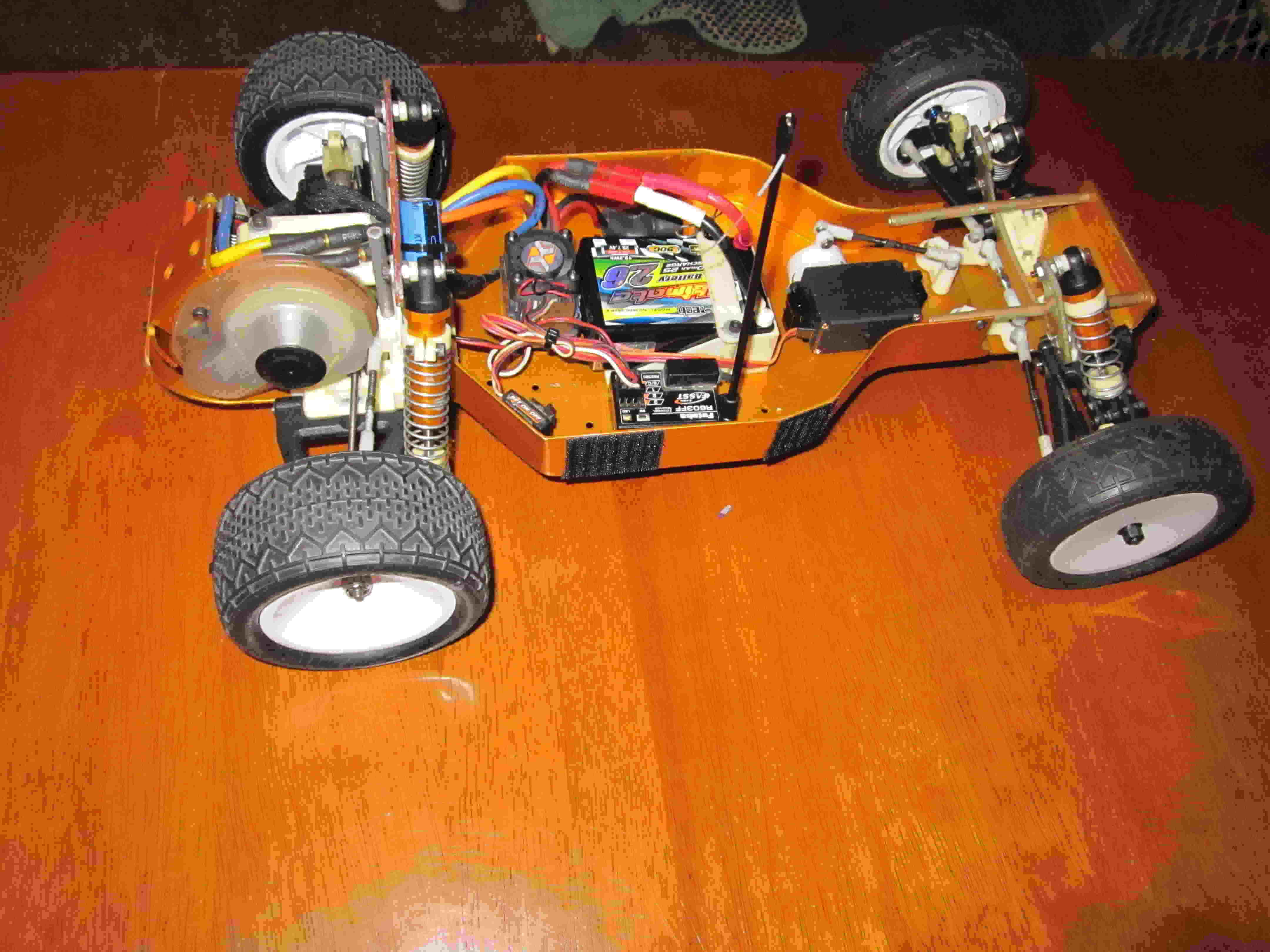

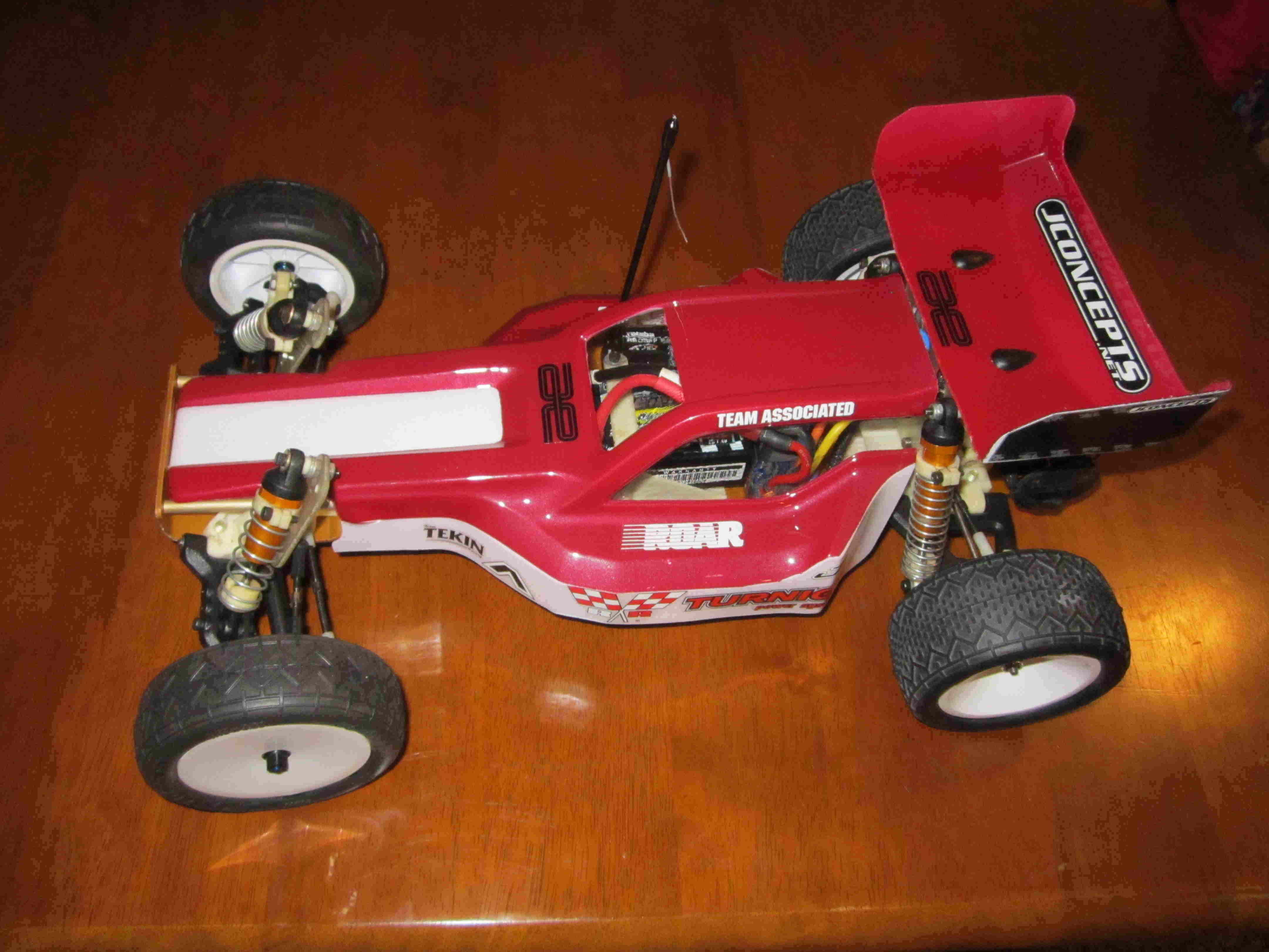

Just finished the b stamp. This will be my box stock class race car. If any of you spot anything I overlooked please let me know. This is my first rodeo with an original rc10. Basically a stock 6 gear champion edition car for a base. They are allowing me to run RPM a arms, and updated size wheels. Only running gear requirement is a Tekin gen 1 17.5. I put a solar d770 low profile servo in it, hobbyking 60 amp sensored esc (I know its a cheapy, but it works great), the battery is a 2600 turnigy 90c rate 2s super shorty, futaba radio. Running a 30 tooth pinion, 78 tooth spur (48 pitch). I also put an extra radio capacitor on it, I really don't think I'll need it, but I had one sitting here. J concepts detonator worlds body and wing. I went back and forth about cutting an antenna hole for an external antenna, but now I'm glad I did it. I'm even considering putting a full length antenna tube on it just for the look.

Suggestion: Black front springs, Green rear springs.

The original CE came with green springs front & rear, maybe the worlds came with black/green, would have to research that. Original short arm car came with full set of silver & gold...re-re's come with silver all around.
