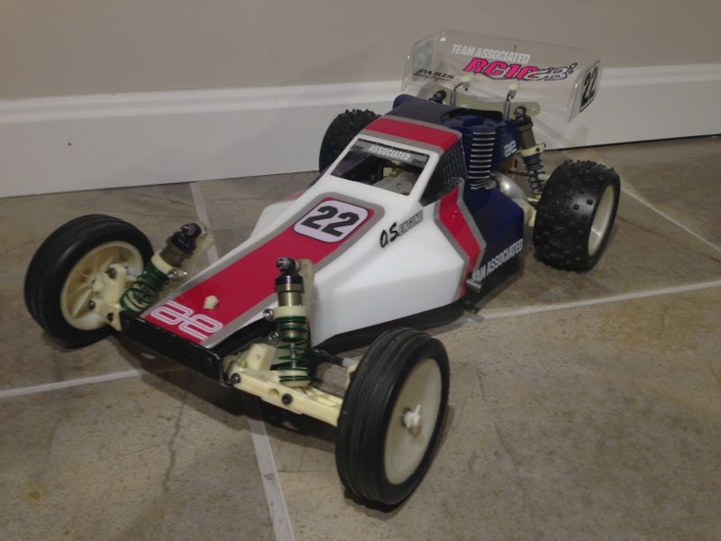

I only have a couple pictures left of the one I built. Here is the one with the body to give you an idea of the fitment I achieved on mine. I don't believe you'll be able to hide a PS exhaust very well under a buggy body as the manifold exits at a much higher angle.

There you go! That looks perfect. Is that the DS chassis? Also what motor were you using? Also how did you mount those wing tubes? It really looks good. Oh and sorry I got confused earlier I meant you when referring to those mods.

I used a reverse mounted electric bulkhead trimmed camber ears like the worlds. Made a carbon brace that mounted to the top forward holes of the trans and mounted my rear body mount to that. The engine was a CZZ and the chassis was a GT.

Thanks, I'll probably follow suit on the gt chassis and the czz engine. I'd like t0 keep the ds/gt bulkhead if i can but reality will probably dictate different.
