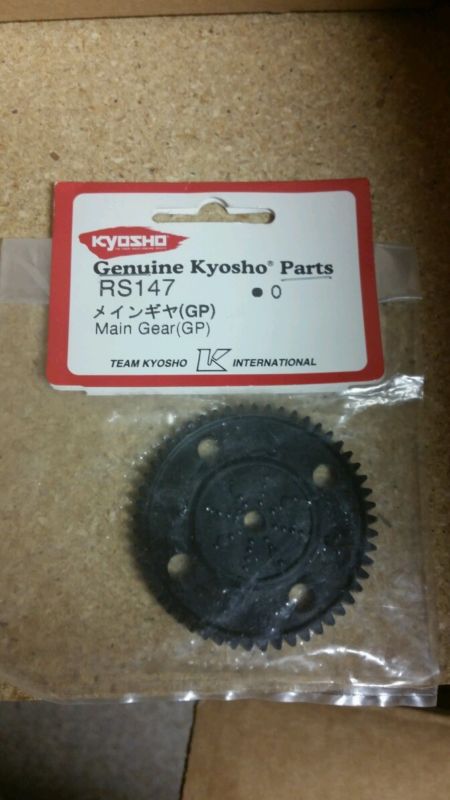

I have a kyosho ultima st gp. As soon as I bought it about 10 years ago my motor mount slid and stripped my spur gear tower hobbies split with kyosho and parts were hard to find. Right after I found a tunnel hull boat at the pawn shop and I swapped my radio gear into it. Now I have a son who really likes watching rc on you tube. I'd like to get my little truck going again. From what I under stand part number is um-219 its a 67 tooth. I still can't find a spur. I saw an old post about a dura trax one that could be dremel d down but its discontinued too. Is their anything out there I could make work? i dont mind if i have to change some things out or go to a different ratio .I also emailed kyosho usa and haven't heard anything back yet. I almost feel abandoned by kyosho for discontinuing the parts soo soon after they quick making the truck. its a really cool truck and I've always really liked kyosho. I hope there is a way to get it running

Is it a 48 pitch? How many teeth could I go up or down with out really affecting it too much?
Would the associated 3924 48p 66t work? Outer Diameter: 1.61 (41mm) Inner Diameter: .378 (9.6mm
I'd rather go down a tooth but if I wanted to go up I found
Um730 -69 I think this will be a direct fit! So excited here

Going by the pics it sure looks like a standard associated bolt pattern. The .8 module is closest to 32 pitch. For the $6 or so that the kimbrough or associated would cost I would give it a try first. A couple teeth on the spur make very little difference.

So the um 219 is .8 module pitch? I tried researching but couldn't find anything

Just figured out my stock gear is an rs 147. I was looking at a type r parts list.

Re: Kyosho ultima st parts
Wow that's a strange one. Not sure if an associated dual slipper style gear would fit with their own pads....maybe

Yeah ikr! I was on ebay only one left like 25$ shipped. I was hoping to find a long term solution so I can enjoy it. Could it be converted to get rid of the slipper and find a easily accessed gear? What are the disadvantage s of ditching a slipper set up? Or maybe like you said a dif slipper spur with the slipper disk to go w it. I know there has to be a solution somewhere! Is that geat a .8 pitch? I couldn't find out

Kyosho said I might be able to use spur gear clutch bell and slipper pads from a sc 10 gt. any thoughts?

If the AE and Kyosho clutch bell uses the same bearings, either Metric or SAE, I don´t see any problems.
Otherwise, You might need a new pilot shaft.
Edit:
There´s a spur on ebay now - expensive but.....

Yeah I saw that one like 30$ shipped almost went for it but figured if I could convert it over it would be a long term solution if I need another gear later down the road plus if the rc10 bell works I could probally go with Robinson gears. I wish kyosho was more open with their specs... i wonder if i would need new clutch shoes and if shaft soze is the same. Thank you for checking ebay for me! Whats your model in your aviator? Looks pretty cool
