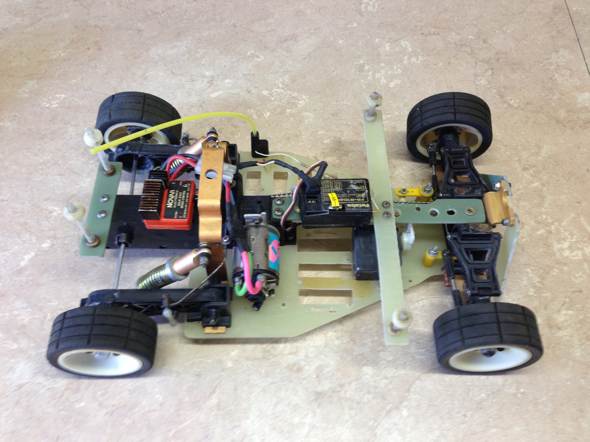

Hi yokomo fans, i just bought a beaten up yokomo 834b SE, the buggy hasn't arrived yet so i don't really no how bad it is but i am not to stressed because i justb bought a huge ebay lot which contains a whole heap off Vintage Delta Yokomo Dogfighter 834b Hop-up Parts which consists off a normal chassis and a Optional Long Chassis, 2 sets - Hardened Steel Diff Halves, Rear Crossbar, Roll over Bar, Alum. H Braces, Fiberglass Rear Arm Stiffners, Rear Anti-Roll Bar, 2-Rear Shock Kits, Front Shock Kit, 5-Front Shock Bodies and Rods, 5-Rear Shock Bodies and Rods, 5-Shock Spring Adjust Collar, 10 each- Shock O-rings, Cylinder Nut, Pressure Spring, Pressure Spring Guide.
Once the car arrives i will post some photos to try and get some advise on the best way to clean and restore the buggy, some people might think it is beyond saving but from the first time i saw it i just had to have it, even in its severely beaten state lt still looked awesome and i knew i had to try and restore it, Ever since i was a teenager i have always loved the 834b, i remember when Gil losi won the world championship i went straight out and got my first job to try and save the money up to hopefully buy one which never eventuated , and like a lot off vintage RC collectors i couldnt afford one so getting this one closes a 30 year old chapter for me.

Actually, it doesn't look that bad tbh.
I suspect you won't need much to fix it up.
You have hot laps wheels there. They are not so common.
Good luck.
Pargustore does alloy wheels.
Good luck.

Thanks for all that info tamiyadan, the bloke i bought it off speaks very bad broken english so if i ask him if anything is broken or craked he wont no what im saying so i guess i will have to just wait till it arrives, I know this restoration will take a while but im not to stressed cause i dont plan to run it thats why i am looking for new wheels and yellow battery brace, i suppose if i cant find any i can always clean and re dye the originals.tamiyadan wrote:ah you took the plunge on that one.
since you will be using the delta parts the only stuff to worry about is the plastics.
the gear case and the rear arms are kind of hard to find since they took beatings.
the gear case is usually broken on the bottom motor mount bolt.
the rear arms can be damaged or cracked.
in the end it depends what you are trying to restore. many times the parts can be broken but not effect the ability of the car to run.
the zip tie on the back holding the rear guard could mean nothing, could mean the guard is broken, or the gear case is broken.
functionally that part is basically a rear bumper. the second job is it holds the zip ties that help keep the rear trailing arms from spreading under load or shock
getting a new Guard is very easy you can go stock or aftermarket. the issue is if the gear case is cracked. if the zip tie is just there to stiffen it up then your fine otherwise you need a new gear case and they go for like 60-150$ a pop. usually that new gear case is used as NOS parts never come up.so you want to ask the seller if anything is cracked on it. i got burned on a gear case replacement because i failed to find out if the lower motor mount was cracked or not. looked correct in the photos but once you put a bolt in it the plastic was obviously split. Functionally it would not stop the car from working, but from a collectors standpoint it wasn't good.
most people that installed the delta stiffeners for the rear trailing arms, then modified the rear arms to make them lighter and would cut off or drill holes in the original parts.
again doesn't hurt the car from running but looks bad on the display shelf.
other then the gear box and rear arms being expensive and rarer to find everything else you can get, now the shocks are another story and you have options if you need to get replacements. the one you bought appears to have the original shocks.
tires are easy to get depending on how you want to play it. the hard to find expensive tires are the RPS 1.75" team losi branded tires that came with the RPS kits.
team losi either copied proline or ripped off proline for those tires. so you can get the same tire as the rps car from Proline they are the 1.75" champion proline tires and they are reproduced because of the Rc-10 re-release kit. so you can get tons of them cheap.
i'm running proline tires on my rps because team losi ripped them off from proline anyway.
otherwise you can fit any tire from 1.9-2.2 on the car using different yokomo rims and offsets for the rims.

I hope your right i cant tell by the photo if they are black marks or a bad photo, im hoping that its just dirty, and a good clean will be all thats needed but i doubt it lol.RC10resto wrote:The battery tray looks ok?

tamiyadan wrote:yes one in the same..$553.00 on ebay BIN
The body is called the Space capsule . it is a rare body and nobody is currently producing it.
rumors were it was a japan only body.
last auction for one
http://www.ebay.com/itm/Vintage-RARE-Yokomo-834-B-Space-Capsule-Body-/291643500180?hash=item43e74ea694:g:Ez8AAOSwbdpWbd4u
Unfortunately the body in the eBay auction is just a Bolink Funco body and has a air vent cut in front of the cowl but the real body has formed scoops in that same spot in front of the cowl and also on the top.
