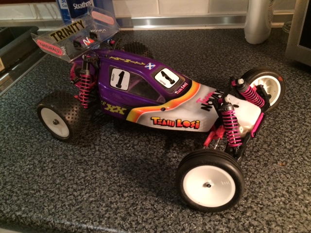

I fitted xxx wheels front and rear to this xx. The fronts should fit just fine. I used trinity xxx rear hubs as the standard ones rub against the wheel as you mentioned.
