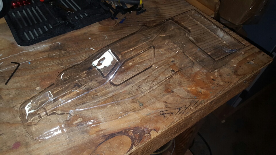

Body and wing showed up today. I like this first version better than the hot weather version.

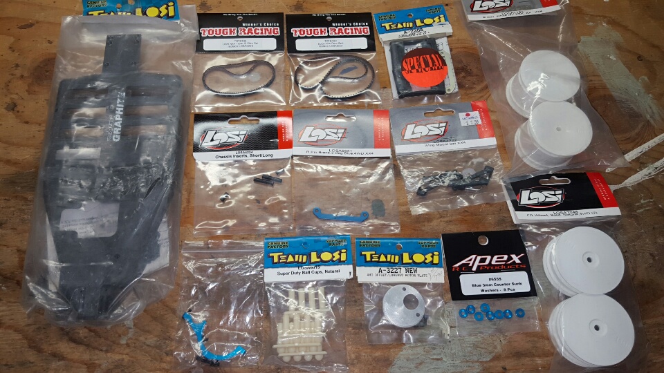

So i have new belts coming, new graphite LCG chassis, and natural white ballcups.

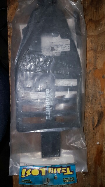

Got my new chassis in the mail today. :D

I think I have most of the parts now to start on this.
