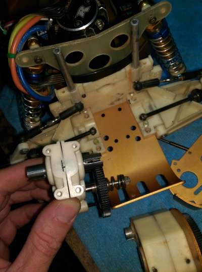

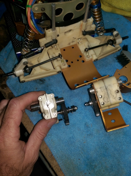

OK....here is how the story ends. Well kind of.
So I get a box in the mail yesterday and it has Associated packing tape on it. Great! They sent me a built and "certified" Stealth to finally install in my old Championship car. Good thing too, because I'm getting tired of rebuilding the old 6 gear ball diff every other day. I didn't look at it to closely but I checked and it spins smoothly.
So tonight I decide to install it in the car along with a new chassis (another thread explains why) and wait....something is not right here. The spur is on the wrong side. Maybe I'm just retarded but I'm pretty sure what I'm seeing is in fact true. Yep, I just looked at my World's car, it's wrong.
I have no idea what they sent me. So far I purchased a brand new Stealth, a brand new ball differential, idler gear and slipper assembly. Throw in the certified shipping out to California. Add the fact that I originally ordered the transmission in the middle of September. I STILL do not have a working Stealth transmission.....

Re: School me on the stealth #6560
Not sure what was happening that day at associated, but someone put the top shaft in backwards. Simply pop the clutch off, open the case and swap the top shaft around and put the little cap on the other half of the trans case.
The stealth can be coverted this way.
Looking at it more carefully, yes, there is a little cap that does in fact pop off on this case. Thus allowing me to disassemble the slipper assembly and switch it around myself. It was not very obvious and was even missed by a few other people. It looks moulded as one piece. So I stand slightly corrected. I do not have to buy another case.
Build a mid motor RC10.....
I'm a bit surprised they managed to assemble it that way and send it out like that. When you flip the top shaft make sure the head of the diff bolt is on the right side of the car. If not the diff can loosen and you "could" end up needing to rebuild the diff prematurely if you run it with the head on the left side.
Also, when you reassemble the slipper clutch make sure it slips before the diff.
