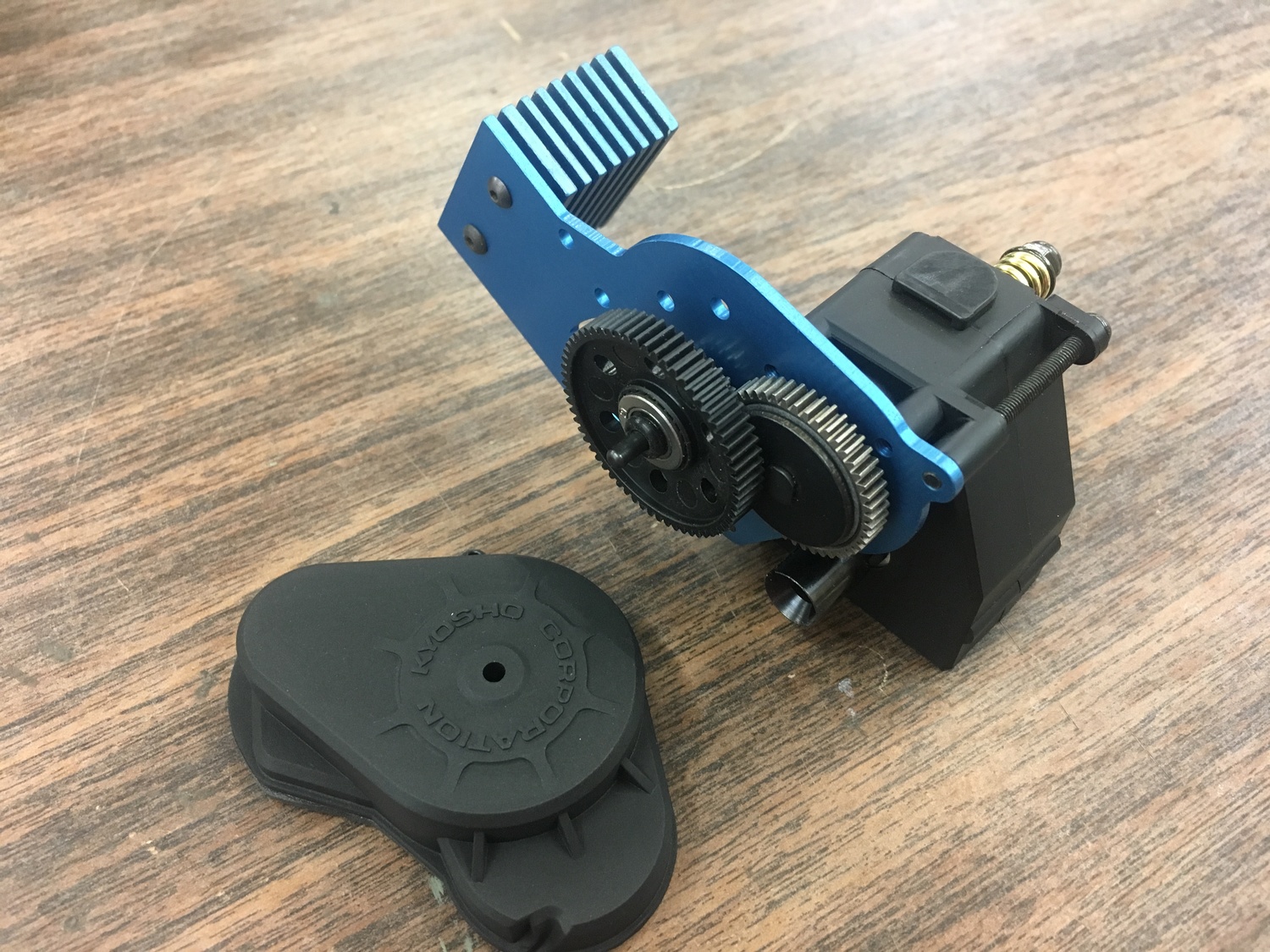

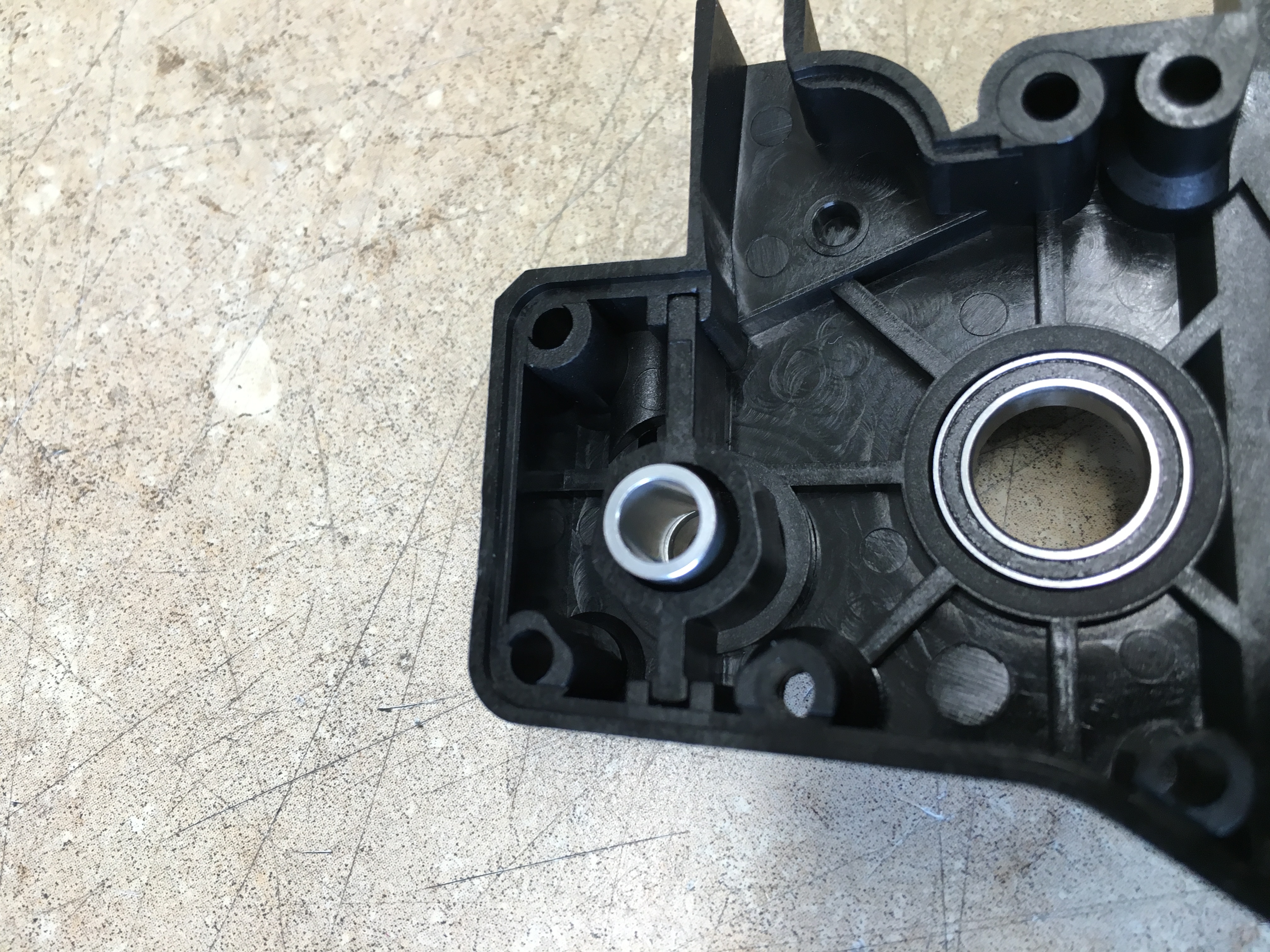

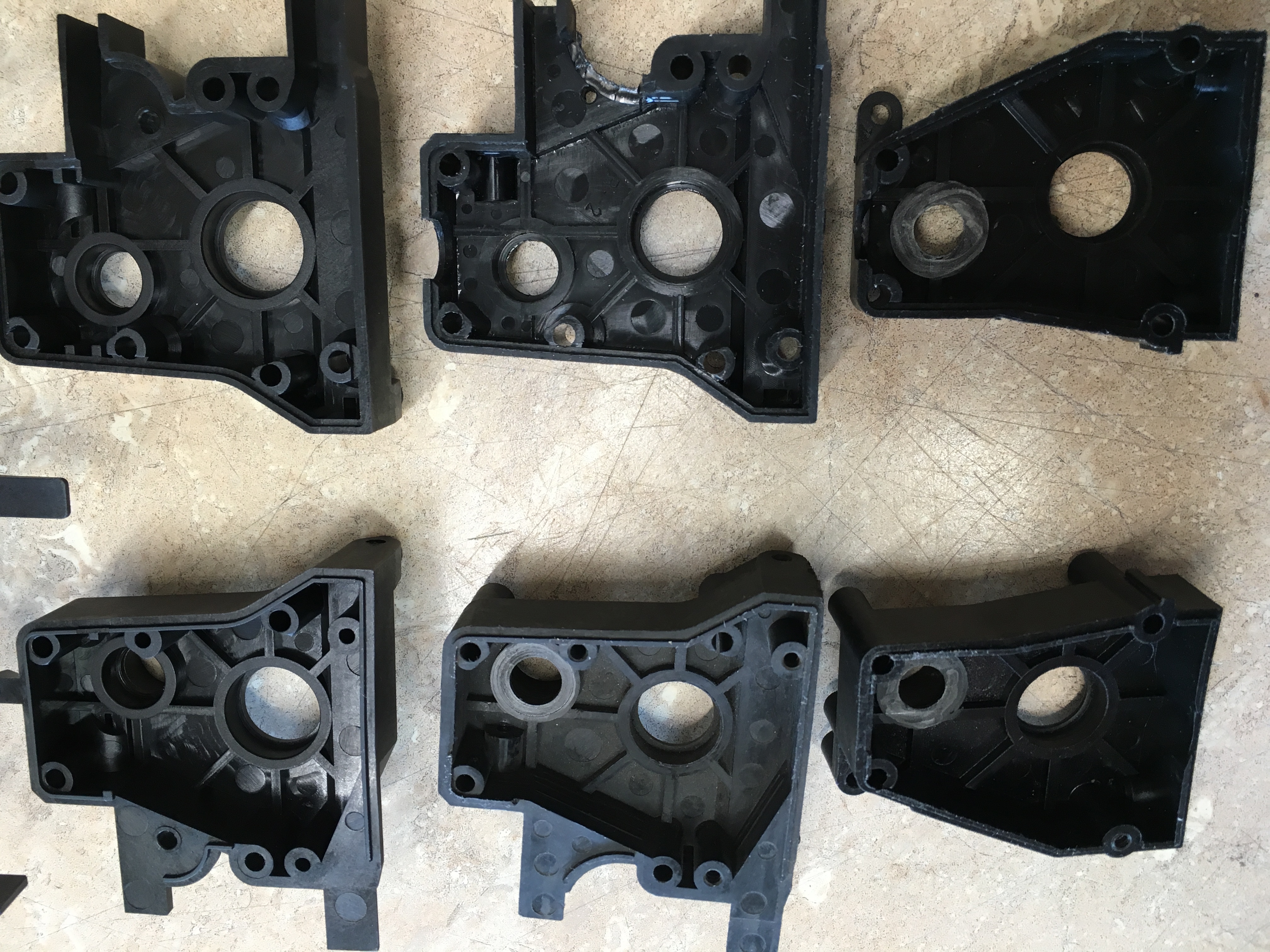

Ok so I opened my fresh kit and built the important parts. Come to find out they are not compatible in either for some silly little reasons.
on both, the bearing on the motor plate side of the case presses in to the outside of the case. Because of this, the gear rubs the case when put on the shaft. On the ultima, they also press from the wrong side on the left side of the car. The diff is also supported by 10x15 bearings now instead of 8x14. A 10x14 bearing would fix this if it were available. I haven't looked into it. The top shaft issue isn't really easily overcome. It would take some custom spacers and a shorter slipper spring to get it in there
