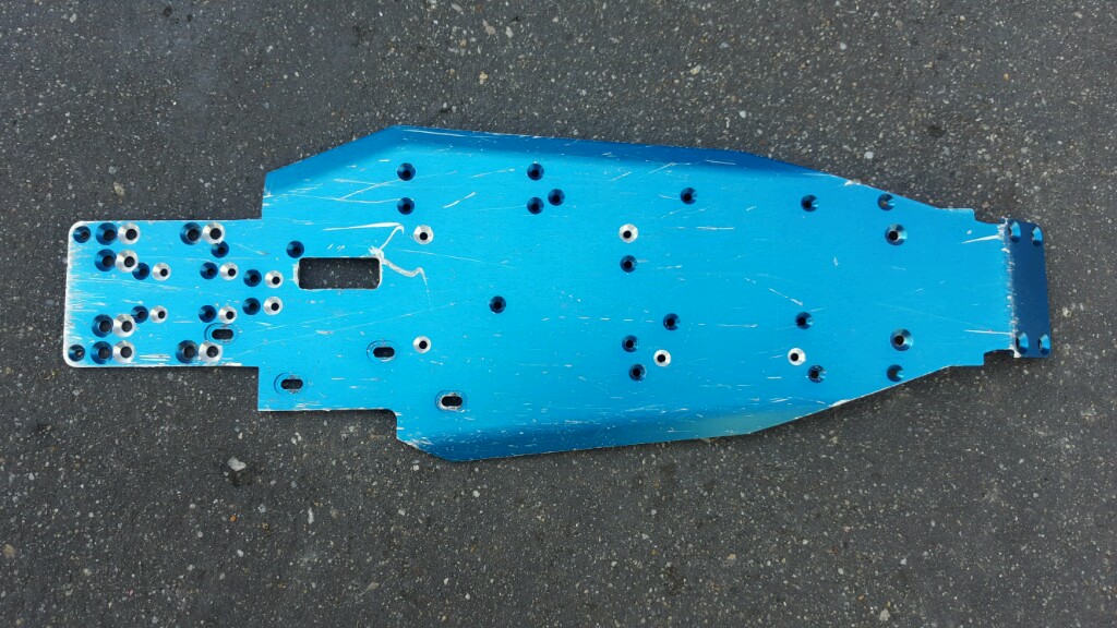

Re: B Pan Chassis or RC Carbon Works for "new build" RC10T
I've had the best luck with fiber chassis (or any chassis for that matter) by laying a piece of tape over the chassis, tracing the holes with a click type lead pencil, marking the center, measure symmetry, using a pin vice to start a pilot (alloy you use a center punch) put tape on back side of chassis. Place chassis on a block of wood and drill your hole from the top side. It doesn't really matter if you tear the hole out the bottom as the countersinking will clean it up.
Edit, I use the pin vice pilot as it's extremely accurate by hand. I dont clamp my piece down, I hold the piece loosely so it centers itself as soon as the drill touches the material. Don't burn through the material in one shot, several short bursts of light pressure followed by pauses let the chips clear and prevent overheating the drill giving a cleaner cut. Go slow as your about to break through the other side to prevent splitting the carbon.
Here's an example of an alloy chassis I've done using a similar method, everything lines up perfect.
