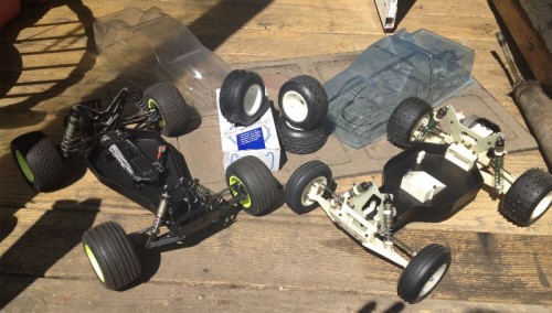

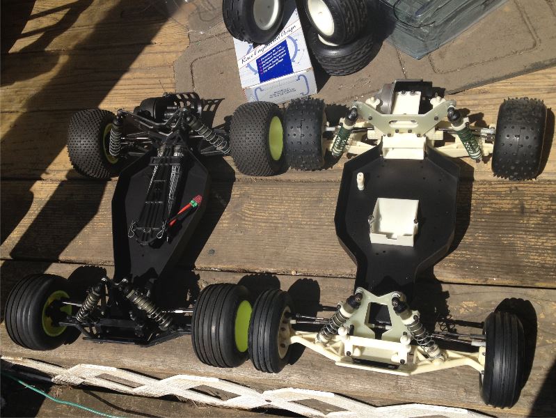

Piecing together the 'runner' It looks like the t2 rear bulkhead needs replaced as there are ballstuds broken off in each side. The chassis does have a slight case of swiss cheese syndrome so it will never be a nice one, no real point in re anodizing it, if it were a bit worse I would just cut the motor guard off for the b1.5... maybe if I find a rough one not swissed out.
I need to cut a square in the chassis for the transmission as well as drill 4 holes to secure the bulkhead and transmission.
The diff needs the thrust bearings rebuilt and some lower bearings that I stole for the Edinger.
This is likely going to get my blue t4 rtr shocks as well.

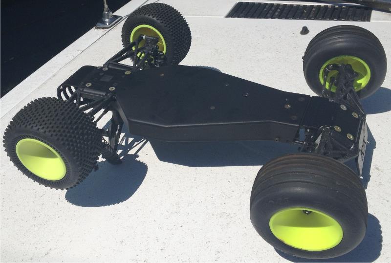

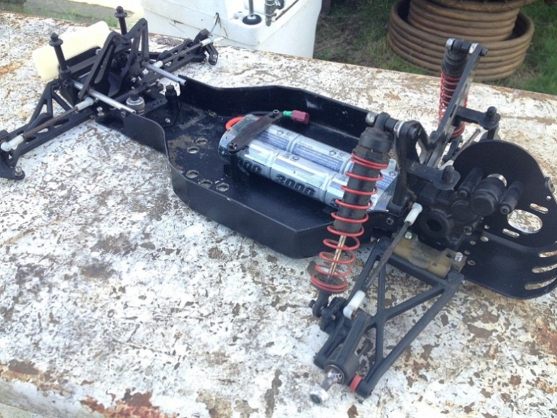

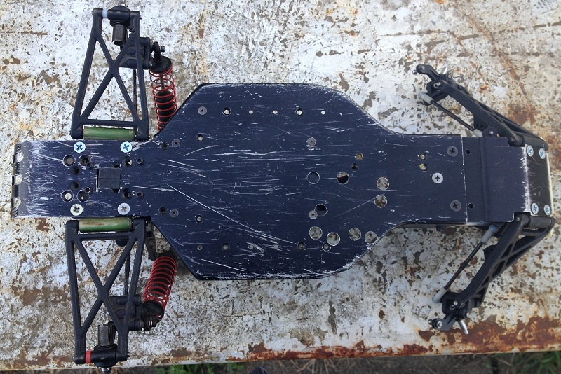

Lol good thing YOU like those red shocks! They were a PAIN to clean up... and the springs are basically ruined! Good old teflon brobably not the best surface to paint!Asso_man! wrote:
OMG that ought to be the most fantastic RC repair pic I've ever seen. The guy was for sure determined to end the race. I also loved the red painted hard coated shocks on the T, geez! Nice projects and restos there!
Unfortunately neither of the front arms on that 10t parts truck were savable but most of the other parts survived. Most of the white parts are destined for the t2 buggy project that ended up leaving me with both a pile of mostly worthless T2 parts and a 10t tub... oh what am I going to do with a mess like that?
Lets combine them!!

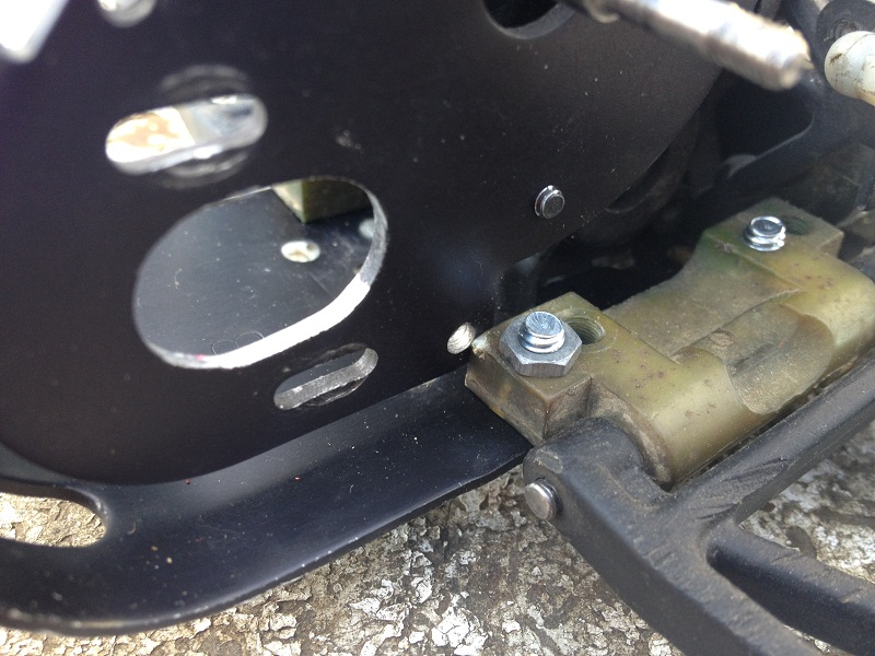

To do this I ended up having to drill 4 holes in the back of the chassis and cut a square hole so the diff could sink down, the 4 holes are not countersunk yet.
Probably the biggest issue I have ran into so far... is my motor plate hits the rear arm mount. oops! A bit of clearancing on the mount should clear that up.
This is not going to be a pretty truck by the way, and I plan to install waterproof electronics in it for the run and hose off ease

It all assembled in that fashion to keep the outdrives centered in the arm mounts, it's being built with the leftover parts from a couple of builds so it is getting the complete t2 suspension components aside from the axle mounts so I didn't need to drill those holes as well
If I moved the arm mounts into the rear most position the lower gear cover retainer screw will be impossible to access without cutting the ear off the arm mount which I am reluctant to do quite yet. It is going to get a pair of lowly dogbones as I have them already. I also need to assemble the shocks for it and pick up a diff rebuild kit and outdrive bearings.

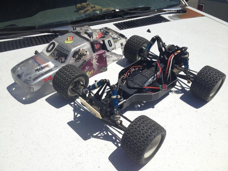

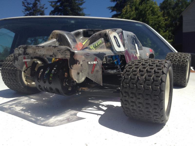

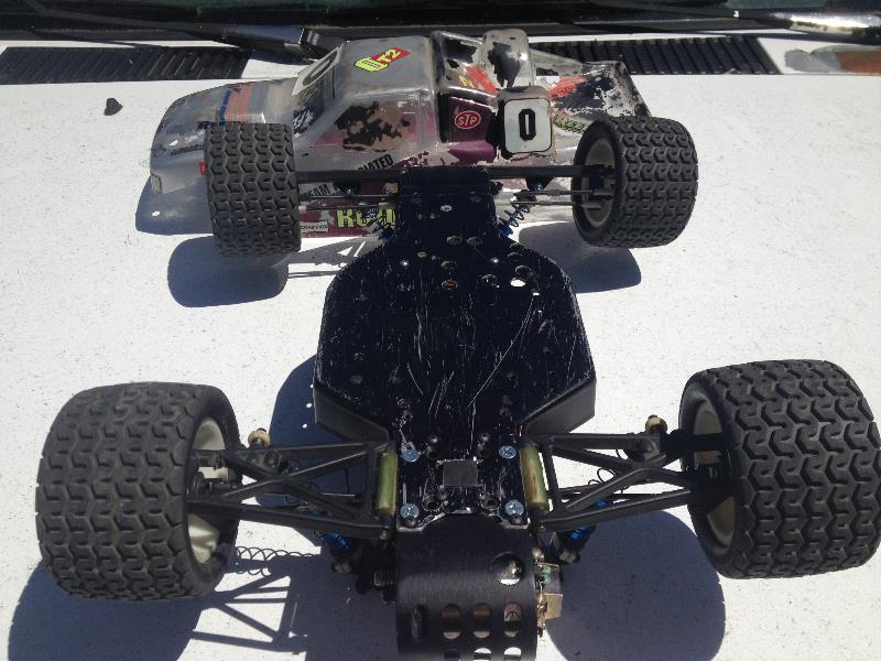

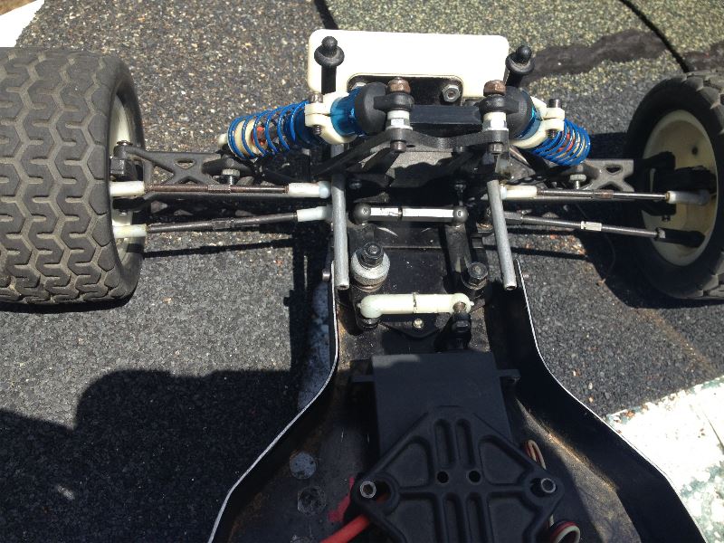

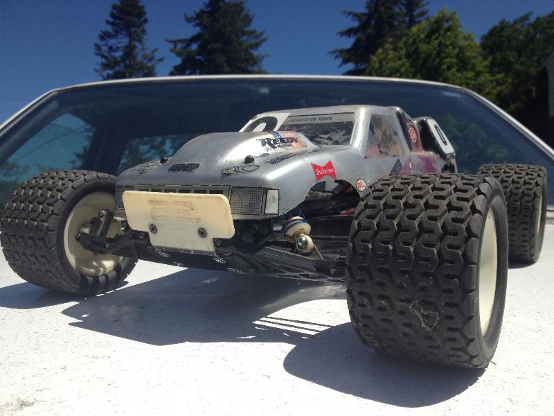

Well I was bored on the 4th and I had a t2 that had most of the parts and 'The Kid' has long since moved away... So I decided I would just build it. It still needs it's diff rebuilt if you are eagle eyed and notice something missing in the pictures...

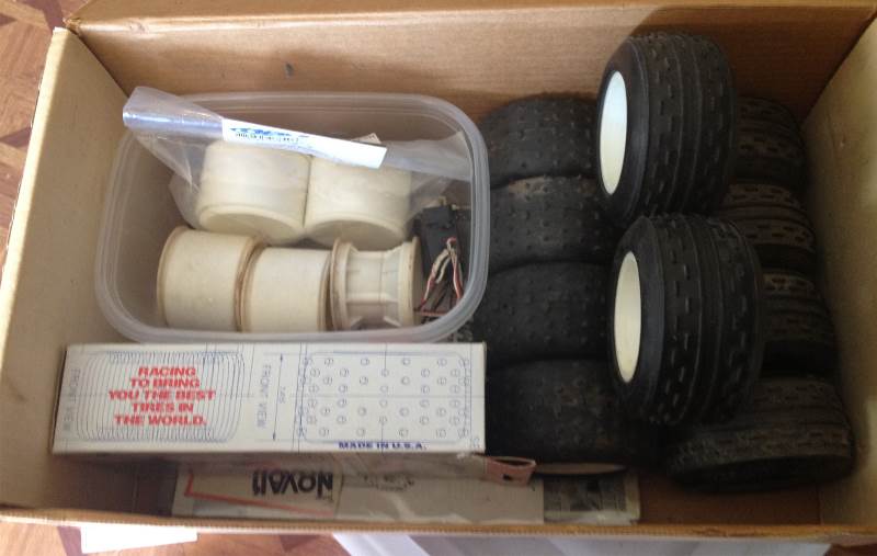

The tires on it are almost new, they were badly glued to a set of wheels. I spend a couple days a week ago carefully ungluing them from the wheels after seeing another forum member who did the same. I am VERY surprised and happy on how it worked, it took some patience but the tires are now basically superglue free.. unfortunately the tire foams deteriorated from it and need replaced now.
On building it I noted a few areas where I am missing parts so noted those down to get, and after it was totally built when I went to go mount the servo mounts I learned the only difference in a 10t and t2 noseplate... and now I need to swap the nose plates between the two trucks! DOH!
On the 10T I game across some ad/box art tires new in box a week back, when I received them I mounted them to brand new 3 piece front wheels and put them back in the box... I have no real idea why I have them heh. I also realized I seem to be hoarding 10t wheels and tires 3 sets of kit front tires, 2 sets of worn kit rear tires (a third set on the truck..), the proline box art tires, 4 pair of kit front wheels in the box with a fifth pair on the front of my XXT, Almost 1 and a half pair of rear wheels in the box with both the 10t and XXT with a pair, and one set of narrow wheels and tires... Maybe I should call hoarders?
Both of those trucks are in much better shape then when I got them... and I need to swap the freakin noseplates between them... >.<

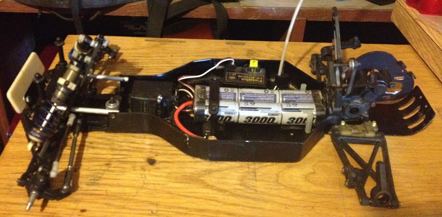

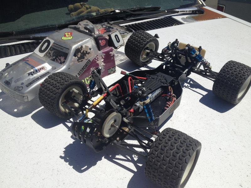

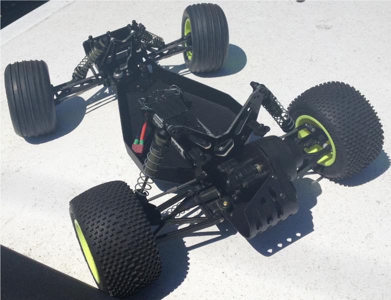

Well the t1/2 hybrid.. t1.5? lol It is a roller and I am starting to plan out electronics.
It looks like I will need to buy a b2 bell crank kit to allow me to mount the servo in this orientation but they are cheap.
It is looking the part of a beat up scrap built rc car though
And the body... it is going to require some creative shoe-goo and lexan repairs at the back, but the truck does not deserve a new one

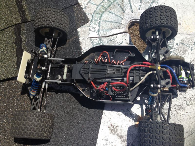

I managed to get a set of b2 bellcrank parts in and as I had guessed I was able to merge them with the 10t style bellcranks. With that I was able to do an inline servo mounting setup, I just have to figure out what radio to use and I should be able to make it a beat up runner
