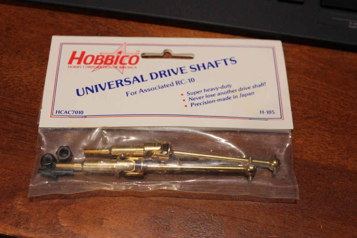

Hobbico made a set of gold universal drive shafts in gold. I bought two pair a long time ago, used one in a custom build and was planning on using this pair for a future build. part number is HCAC7010, you might be able to do a search.
