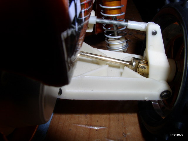

I know this doesn't really help but sometime way back when I picked up a pair of gold CV's. I guess the only plus to this post is there are some out there I just don't know where or who made them. I see that they look towards the silver side in the pic but that's due to the flash. They are a nice gold color in person.

How come you don't have them on all your builds then?scr8p wrote:Kyosho made the gold uni's for the rc10.

Hobbico made a set of gold universal drive shafts in gold. I bought two pair a long time ago, used one in a custom build and was planning on using this pair for a future build. part number is HCAC7010, you might be able to do a search.
