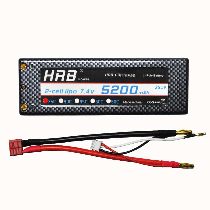

The bullet connectors eliminate the EC3/Deans/Traxxas/whatever connector you are using. They are wired to the ESC and eliminate the extra connection (like soldering in a NIMH pack). Look at the picture below.
The "communication" plug is a JST XH3 balancing connector. This is used when charging a LIPO to balance the cells. This is a must, I balance every time I charge, prolongs the life of the battery.

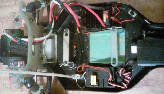

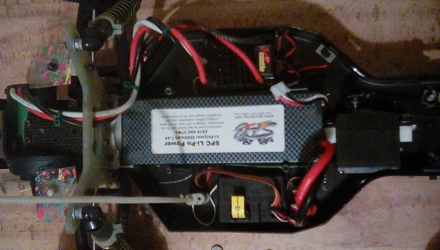

Here are 2 pics of the re-re Worlds Car with LIPO (one standard pack and one shorty pack) and 2 pics of my truck. The re-re has a different rear bulkhead and battery cups to accommodate the bigger lipo packs. As you can see, I had to trim the rear bulkhead and cut the battery cup up front. I recommend cutting the bottom of the rear bulkhead, the top of my cracked so that's why mine is that way. Here are the part numbers for the newer style if you don't want to cut (the new style has no material on the bottom where the battery sits). Pretty sure the rear bulkhead is the same on the truck, someone else verify? The original manuals (10T and Worlds) list the same part numbers for the bulkhead.
rear bulkhead - 6323
battery cup - 6333
That charger should work just fine.
battery cup - 6333
