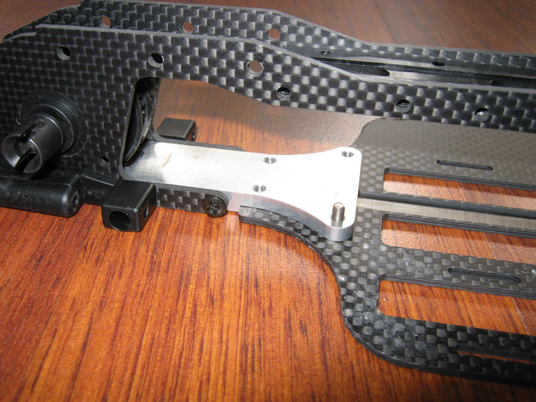

Close up of the parts included with the Tech Racing High Torque front one-way:
It uses much larger one-way bearings than most one-ways and comes with machined bearing holders to replace the plastic stock ones.
I also assembled the 2x3 chassis as far as I could, using spare screws to keep things more or less together. There are a few screws missing, and some are the wrong size or not countersunk as they should be.
Pictures:
What is curious is how all the alloy parts are not actually anodized or otherwise nicely finished, which is very unusual for Kyosho, although it might fit in with the rumour that this chassis only saw very limited distribution with pilots affiliated with Kyosho.
Belt access is somehow even worse than on the stock KX-One, with the belt sandwiched between the carbon lower chassis plate and the front bulkhead:
The part of the carbon side plates between the motor and the battery is a bit wider now, and also uses a sturdy alloy piece to keep everything together:
The rear end now uses two alloy lower bulkhead halves to connect everything together. The rear bumper has been eliminated:
Also eliminated is the alternate mounting point for the front belt tensioner and some carbon above the steering servo. It appears the KXW-11 alloy hinge pin mounts were actually designed with this chassis in mind, as the stock plastic parts need modification to be able to use the included 46 mm long rear hinge pins.
