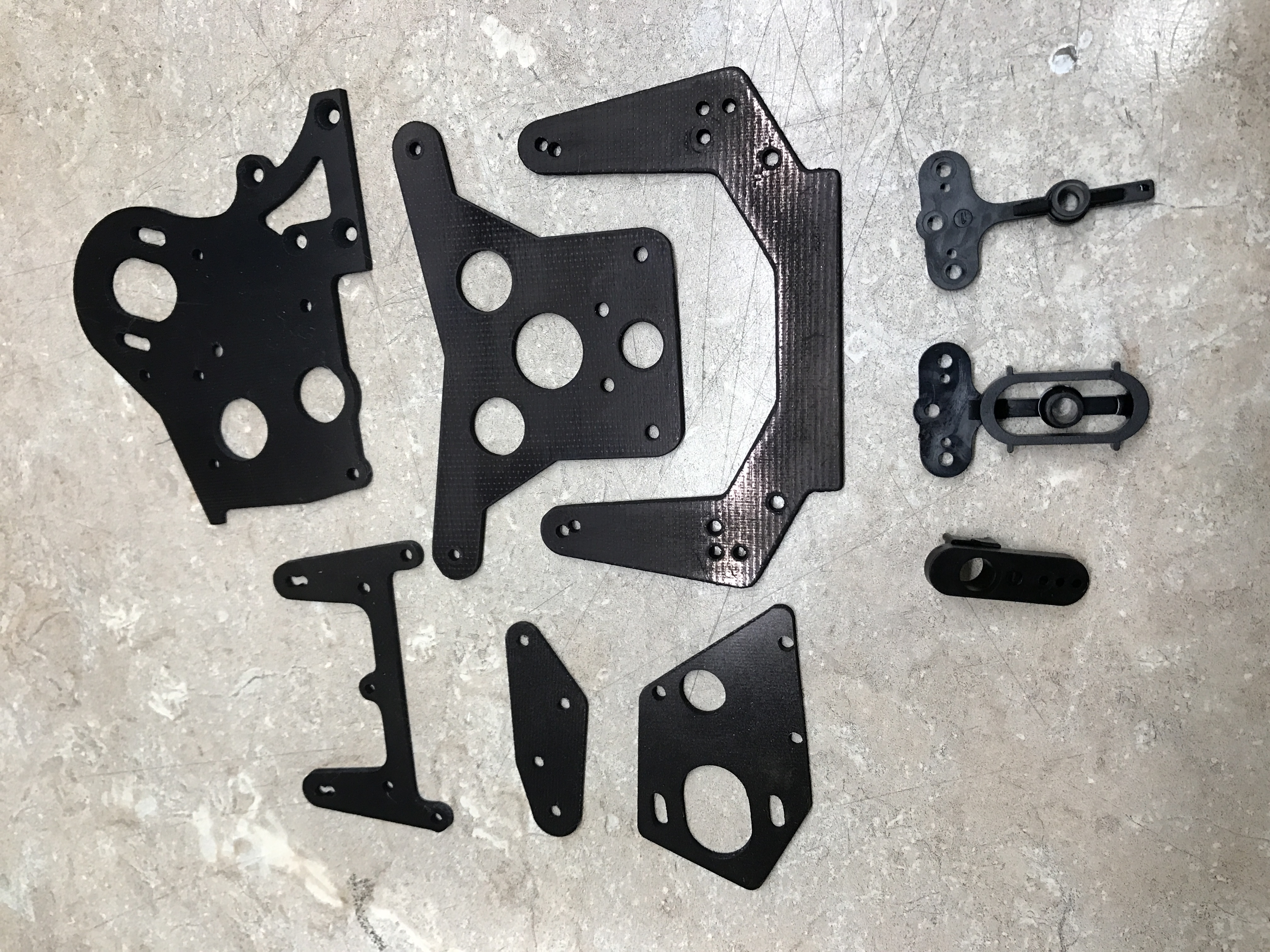

The problem is the "new" RIT dye. It's not the same old formula. The Dyemore is more like the old stuff, it dyed some towers that wouldn't take standard rit at all. The bellcranks also took it just fine. Even my new G10 material took it, and I've never been able to dye the new stuff
