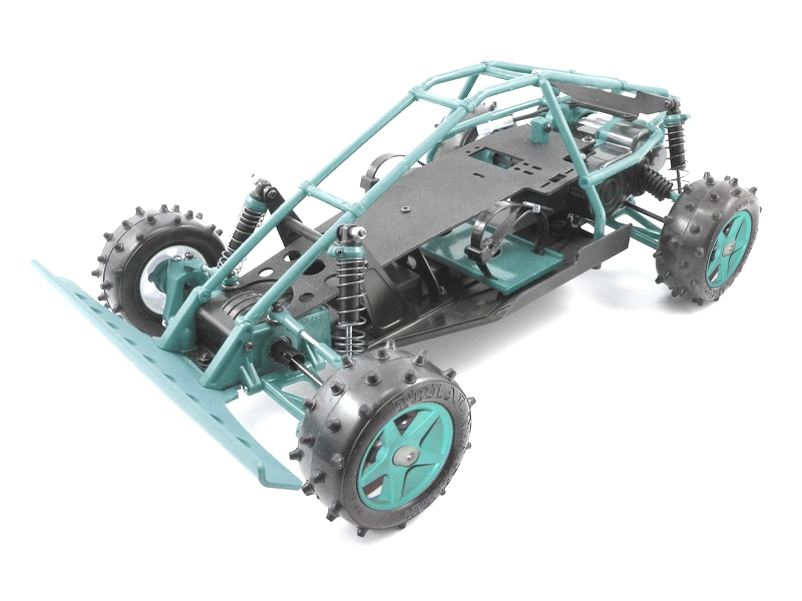

Actually, I have too many red roll cage cars (zerda, gallop, samurai), so I decided to dye my zerda green to match my HPI wheels.
I used a special dye called Photoshop

Thanks for the help guys. Wow Roger, your 'green' caged ZERDA looks fully kustom mate.....
Im pressive job with photoshop I might add. I realy had to look twice (well maybe 3 times).

Oh crap!! Photoshop??
I just get a bunch of dye boiling and have been dipping my parts the whole of last night wondering why mine did not turn out green!!
