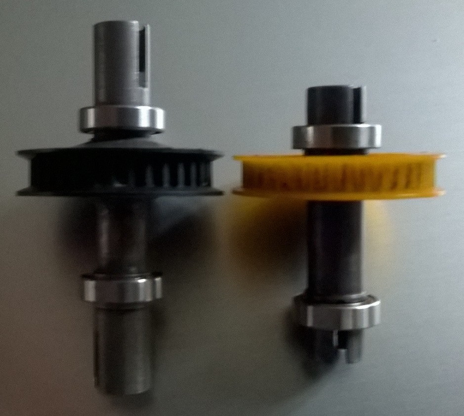

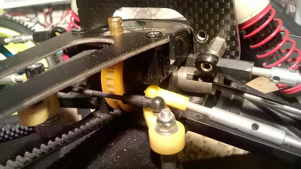

The perspective makes it look different but actually the Academy Wyvern diff fits almost perfectly in the YZ-10 bulkheads.
The pulley has a tooth less, so I put the YZ10 pulley between the wyvern diff halves. And put everything back together.
Result: I can now use the shorter 870C U-J's

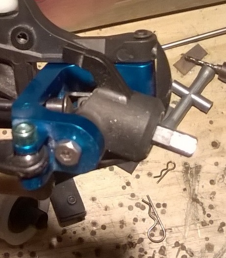

The set screw in the hub didn't meet the flat area of the axle, so I ground off a bit to make a bigger flat area
And here it is with the hub mounted... not sure if it is the correct one but it works for me.
I like the result and will do the same for the back.

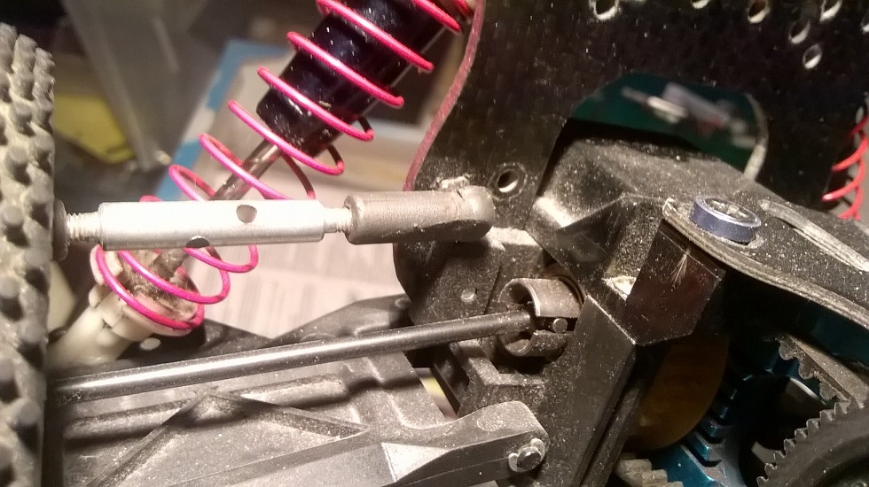

This is as it sits now (ie the 'before' shot):
Once done I'll have the original shafts available for another build with my design of arms 8)

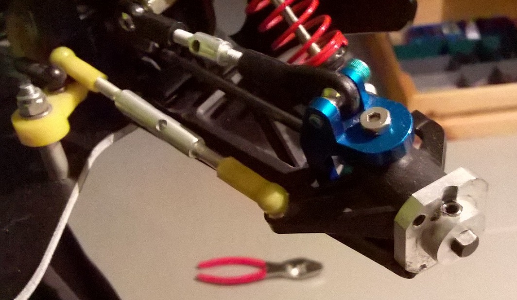

These are the Yr-4 arms, carriers and shafts. No question the shafts have to go. I know we've gone over this but for anyone seeking this info. These carriers should handle 870c or any other iteration Yz10 wheel shaft / hub set up correct?
