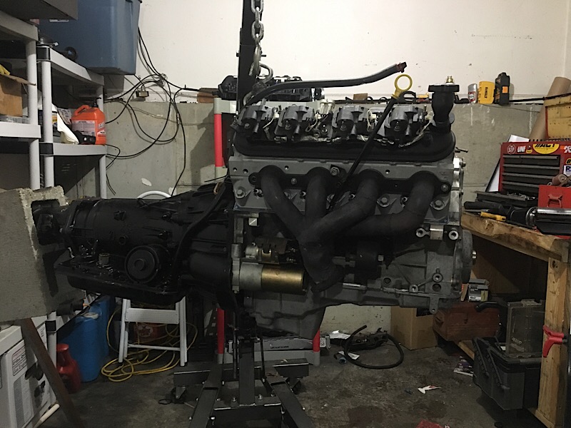

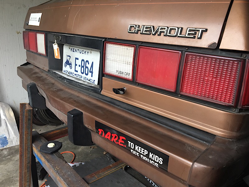

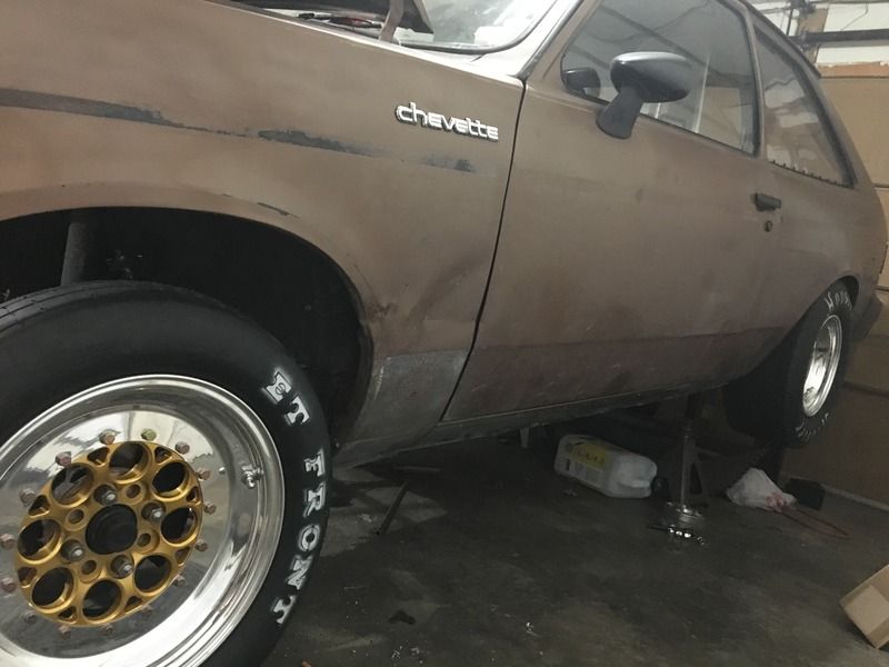

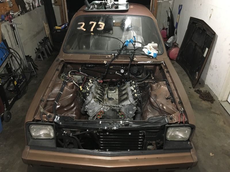

Re: Project: LS1 Chevette
Might as well picture update this one last time before my Photobucket account goes down.

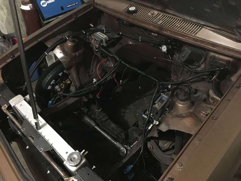

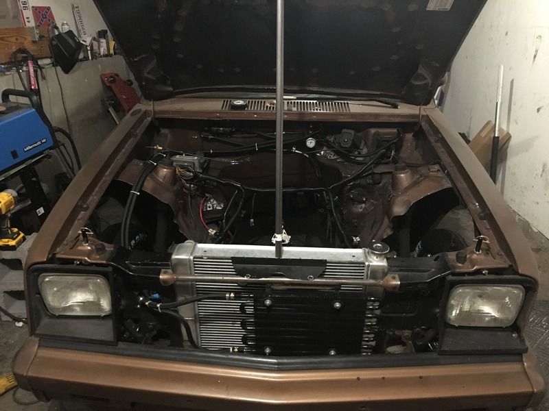

Engine is almost done so I'm tidying up the small things.
I cleaned and and made a removable core support/ radiator mount. Then added alum hood pins to hold the hood down.
Then I cleaned up my harness. Not perfect but worlds better than it was. Also you can see some of the nose job weight reduction I did.
Then I purchased some new wheels to get rid of the cheap non balancing steel wheels I was using. Between the front wheels and the weight reduction off the nose and front sway bar. I've removed 48 lbs from the front end alone. The street rear wheels are still in the mail. There was an error in shipping so I had to return the wrong ones but the street wheels are the same weld wheels but they are now 15"x8" running a Hoosier 225 drag radial.

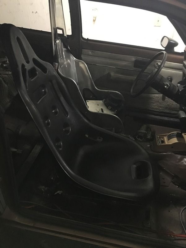

Lastly I mounted up a seat so my tuner won't have to sit on the floor again.
The engine should be done soon. Along with all the new gaskets, seals, bearings. I'm running PRC stage 2.5 heads, Brian Tooley Racing stage 3 Cam, and a Fast 102 intake with 102 throttle body. I'm hoping for 450 whp but time will tell.

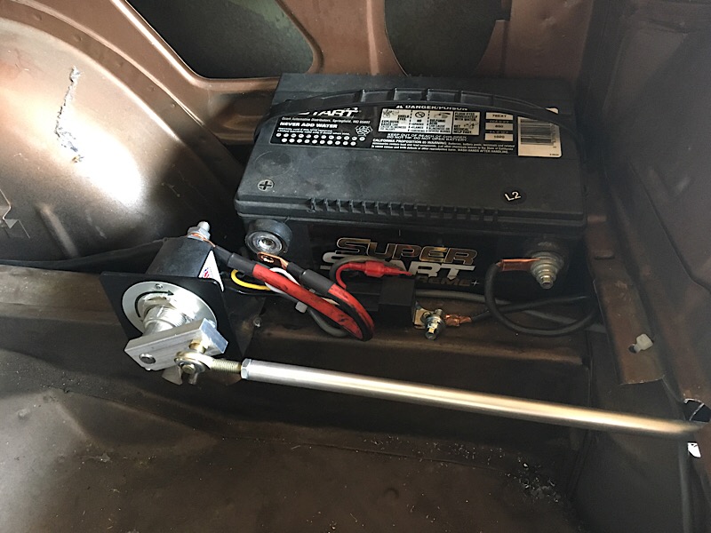

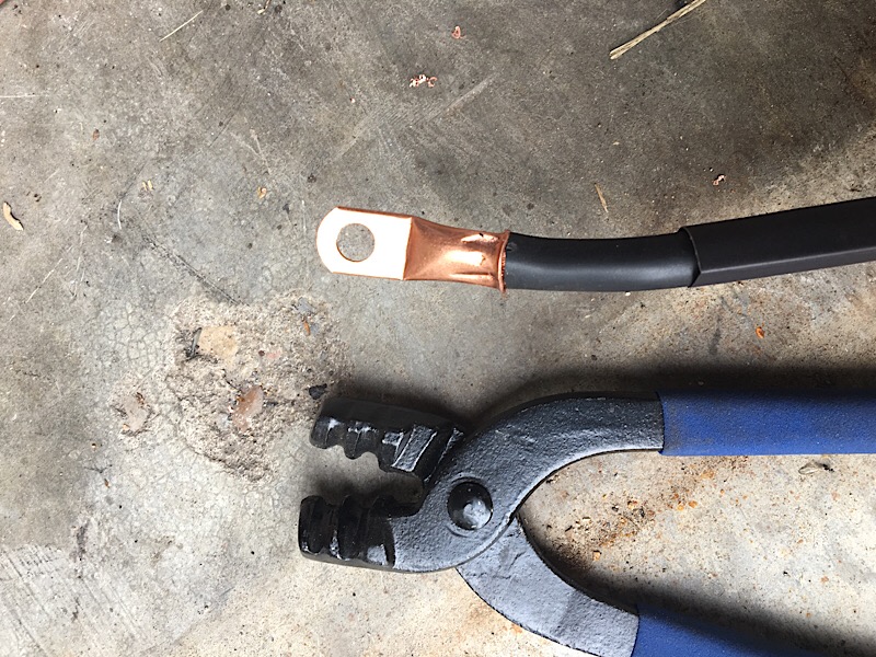

While I was looking at the general rules per times I mistakenly thought I needed a battery disconnect. Either way I now have one for when I break into the 9's. I found out one of those cheap hand brake tubing benders make great large gauge crimpers. I've added a rubber grommet since the picture so it wouldn't rattle too.
