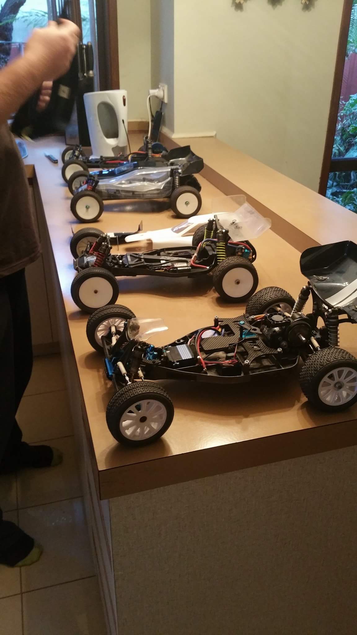

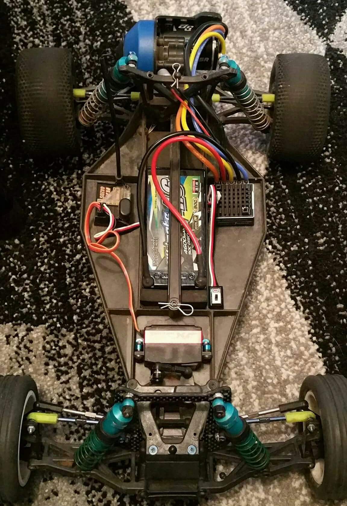

The beginning which started by my brother asking me if i wanted a b3 because it was cheap. So down under it came from the states ;)
It sat as a roller for abit then a lot of buggys came up which i stole some electrics from.
Waz

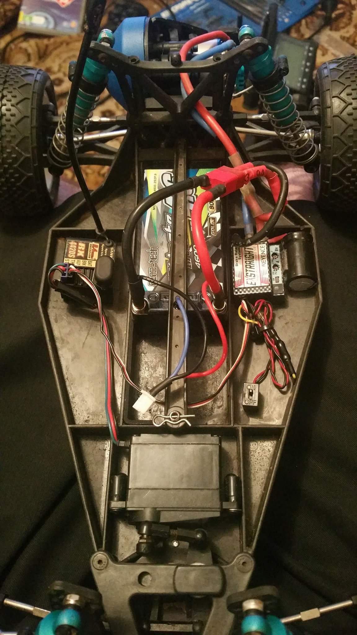

Eventually i toasted the 8turn brushed motor. Electrics from my b5m were later swapped into the b3.

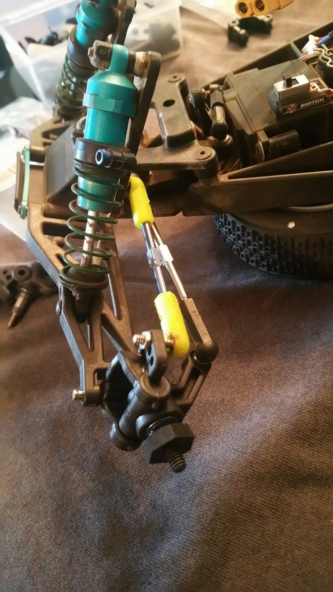

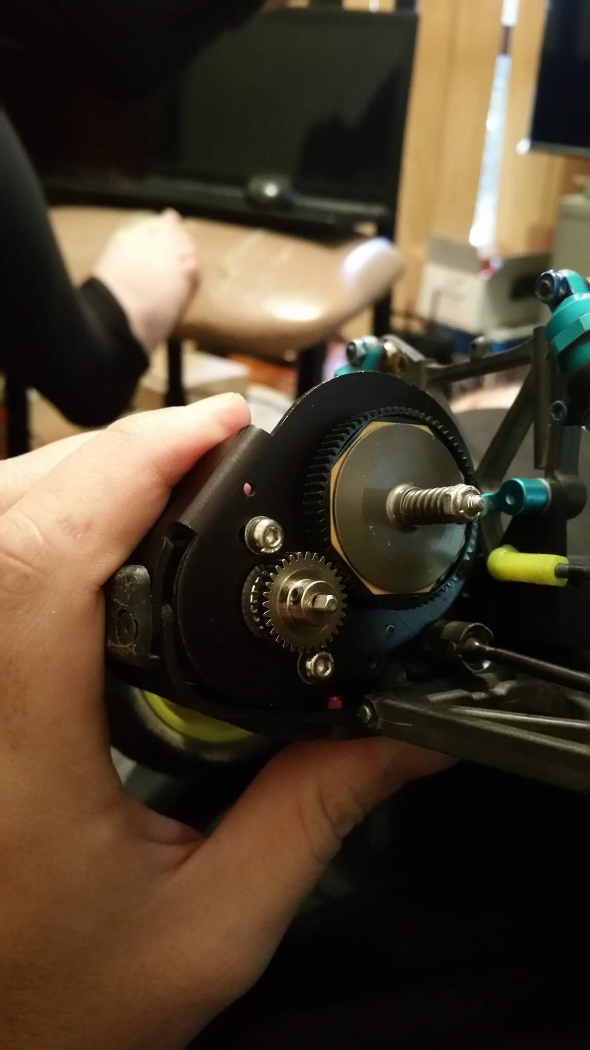

I did the b4.2 hex swap for more wheel options and also to try the wide front rubber. Pictured are some old cva b4 axles i tested, these were replaced with new mip b4 cvd axles.

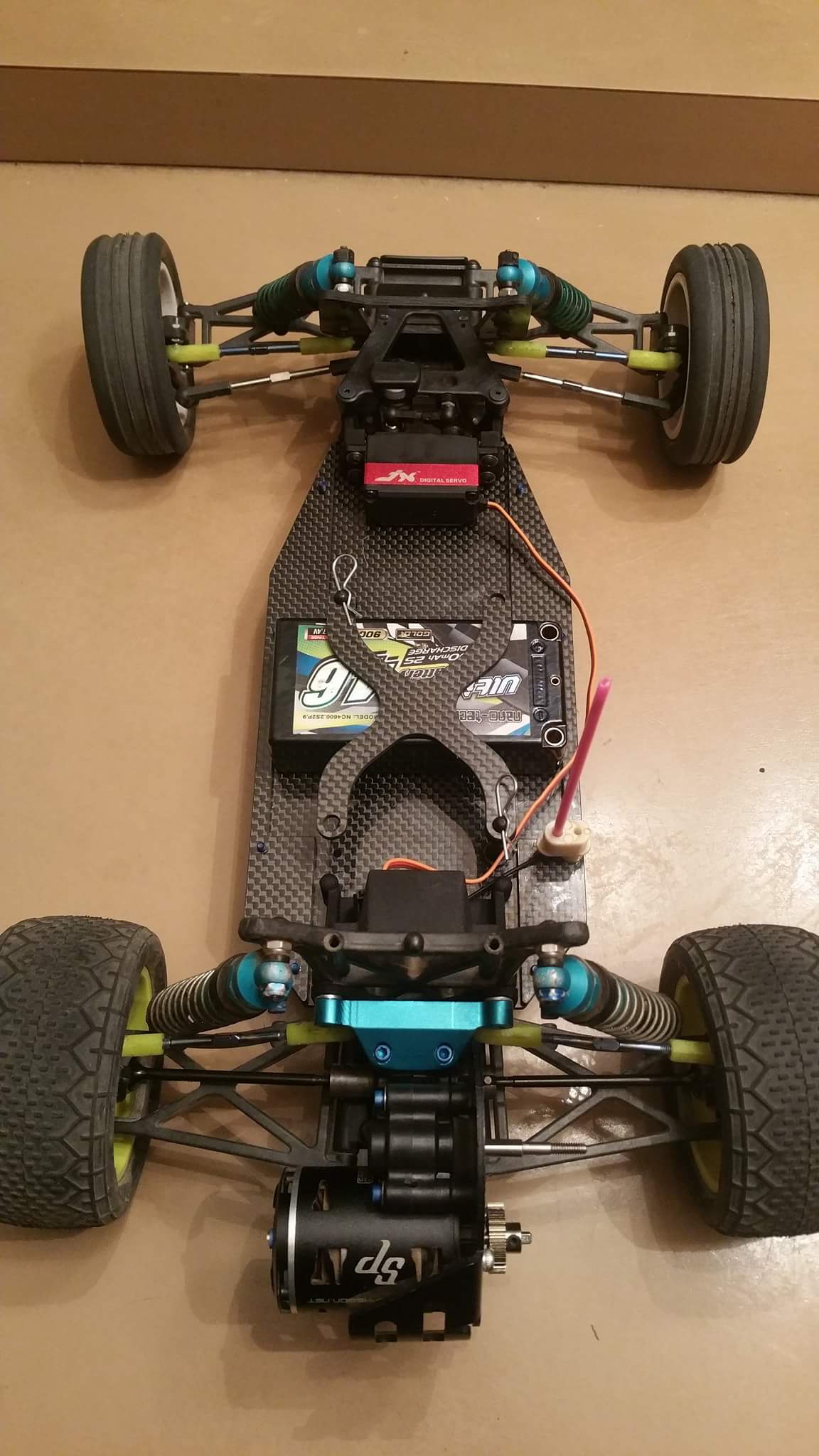

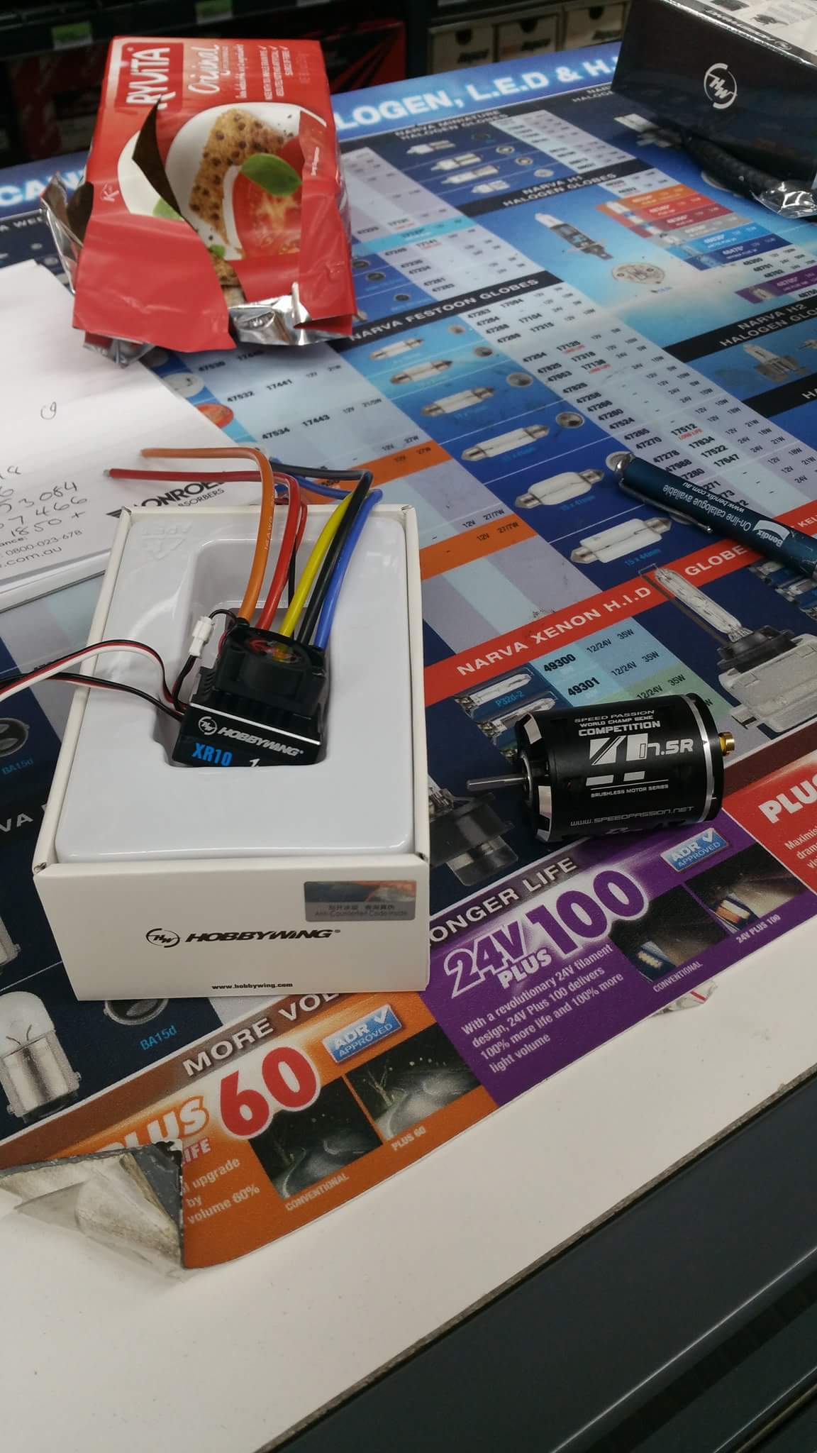

New 17.5t combo was next on the cards so i could hand my old brushless stuff down to another buggy. Also a new cheap low profile servo went in at the same time.

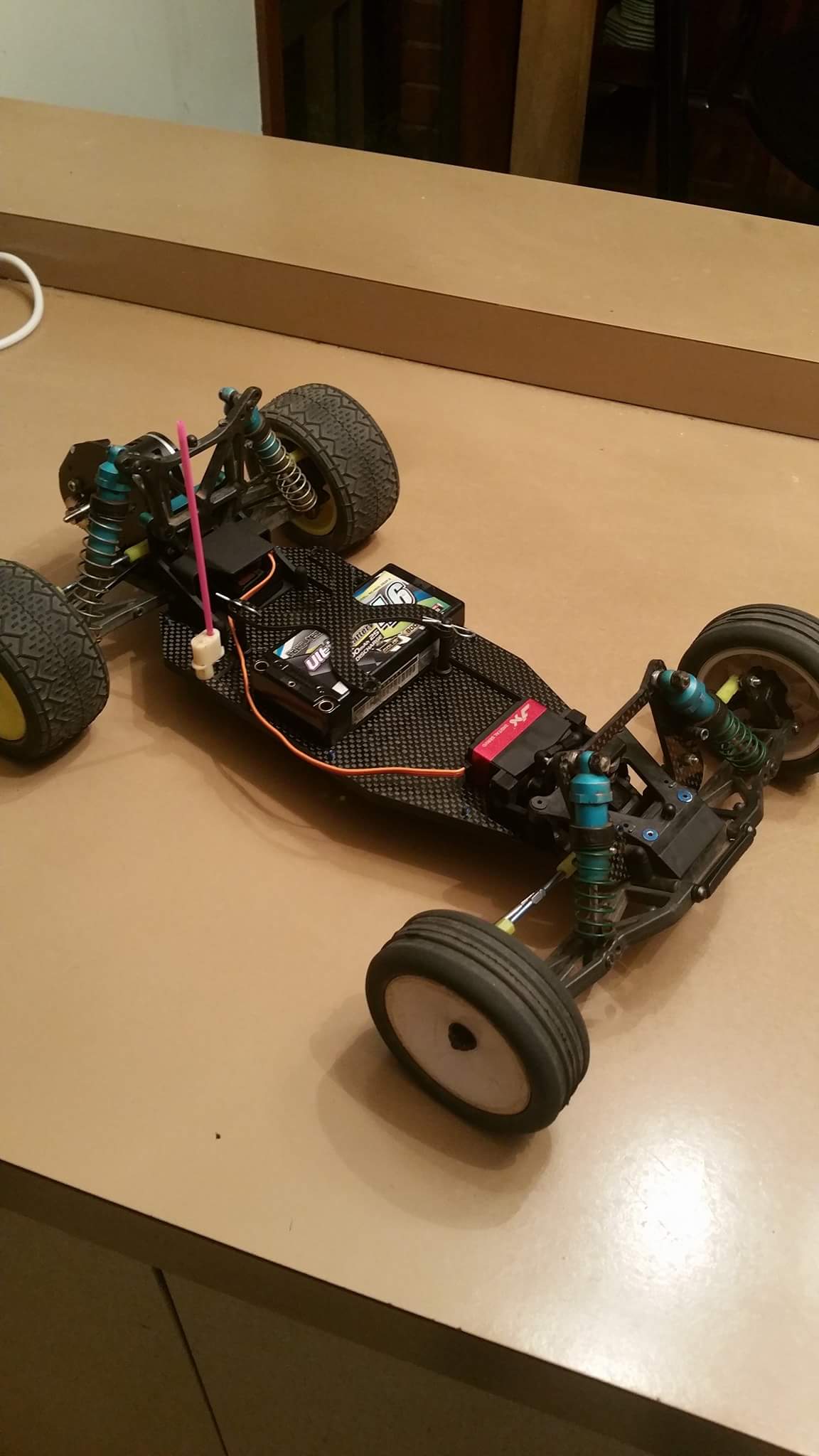

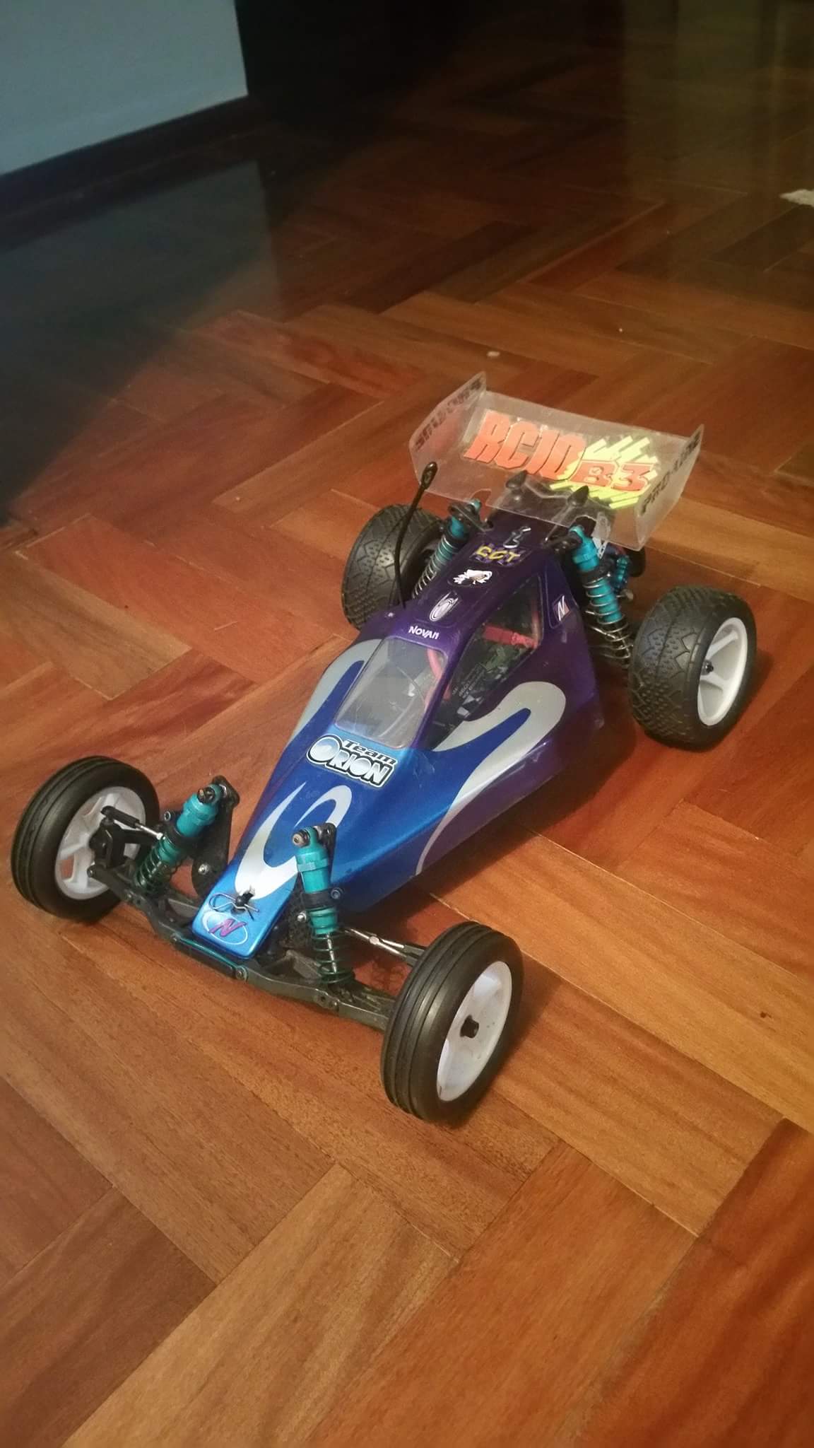

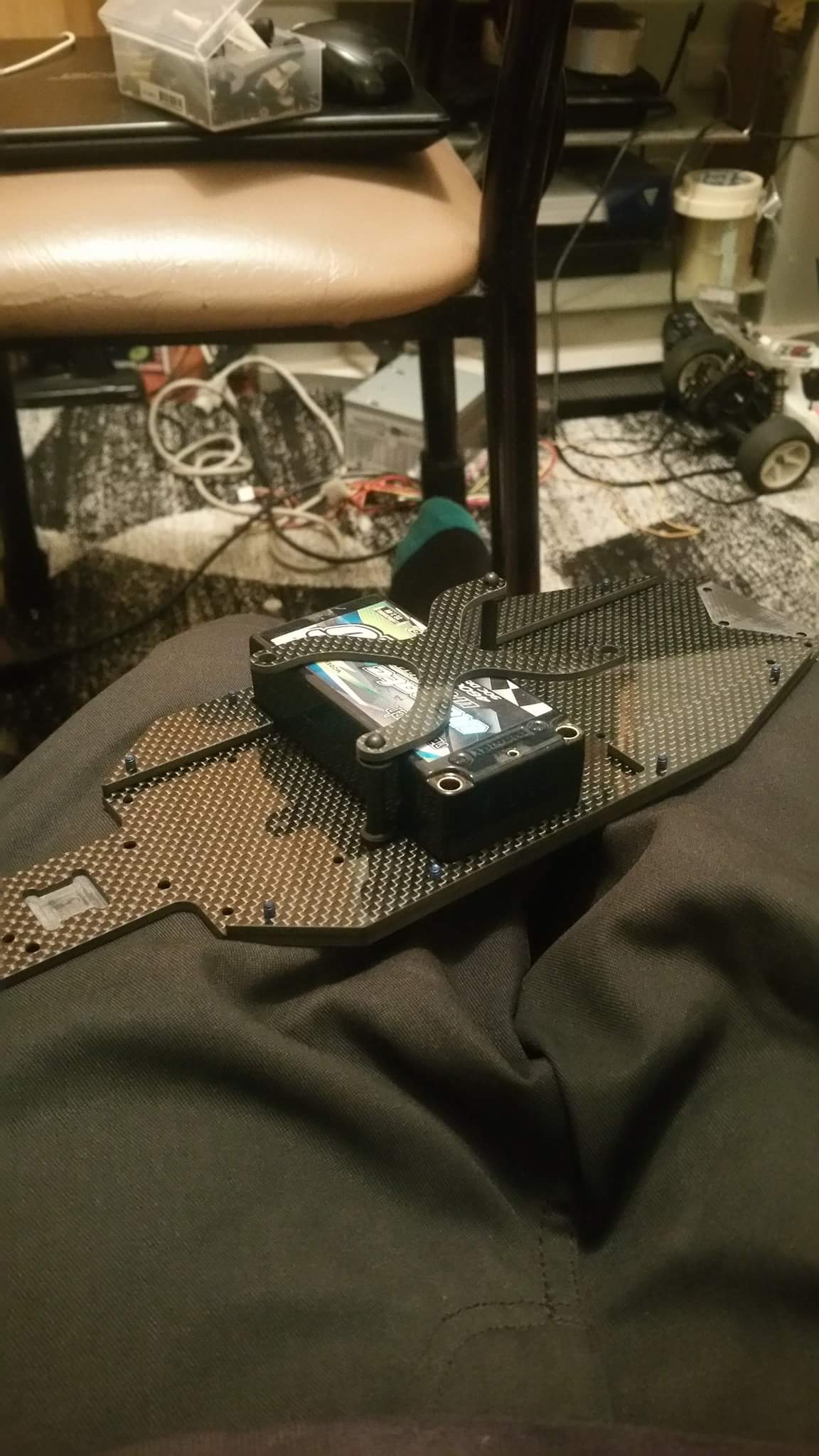

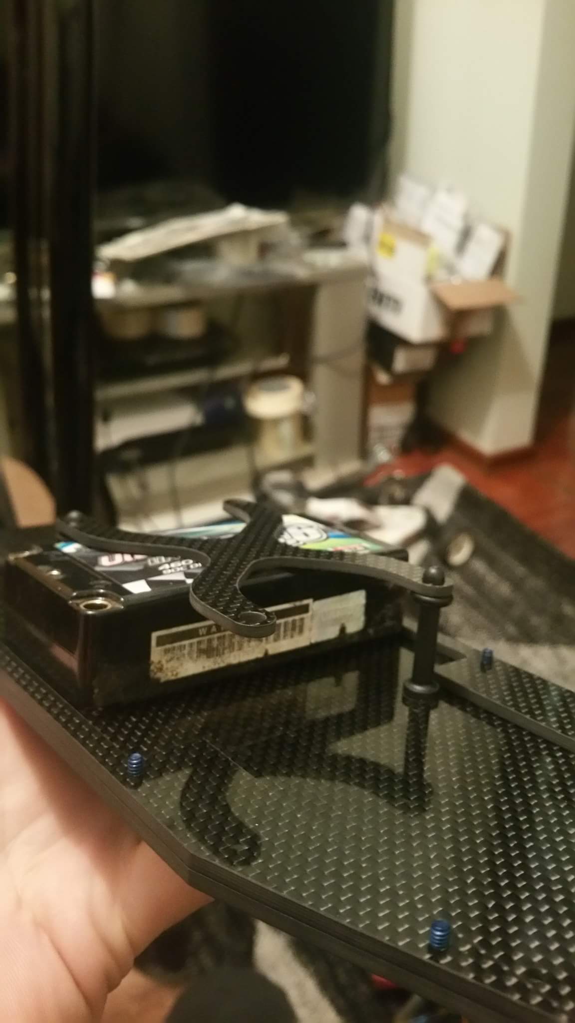

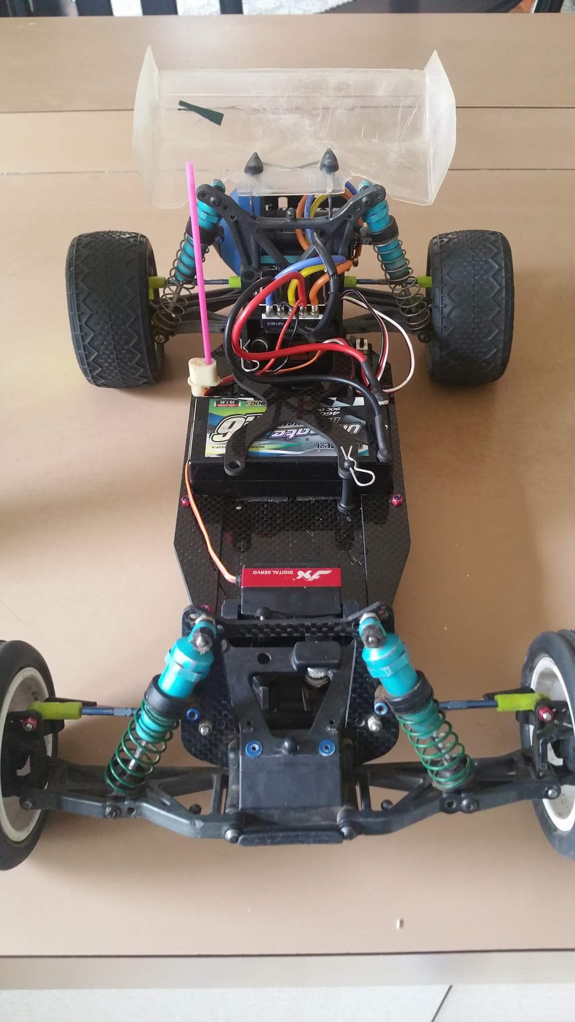

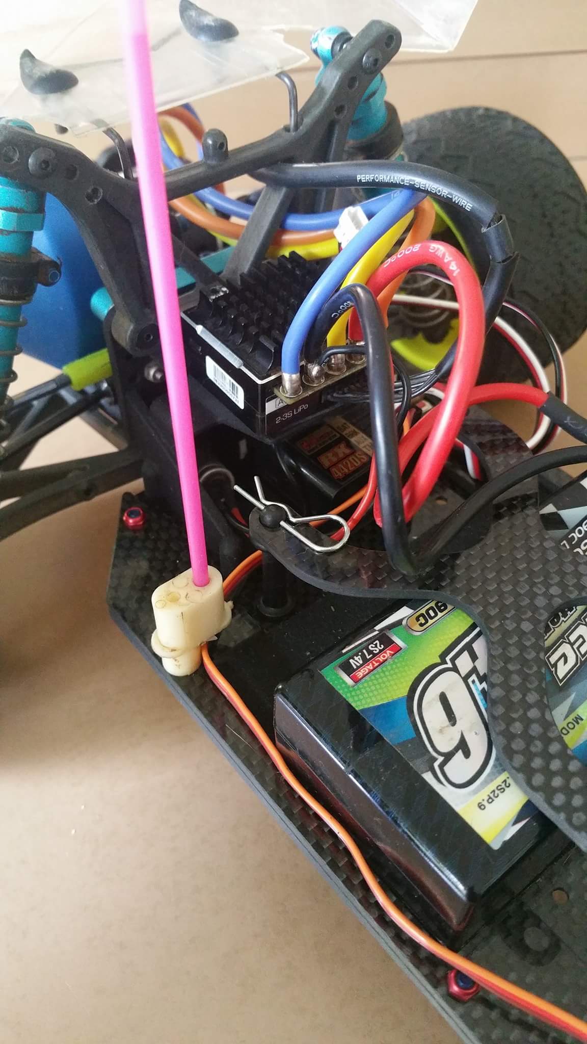

Now the fun. I kind of miss not caring about scratching the underside of the chassis.
Nix9200+6mm chassis with lipo trays. Also got a worlds rear tower to get the body fitting correctly. An aluminum trans mount was added because i was sick of stripping carbon ones. Got some new gears (69x31) and titanium motor screws.

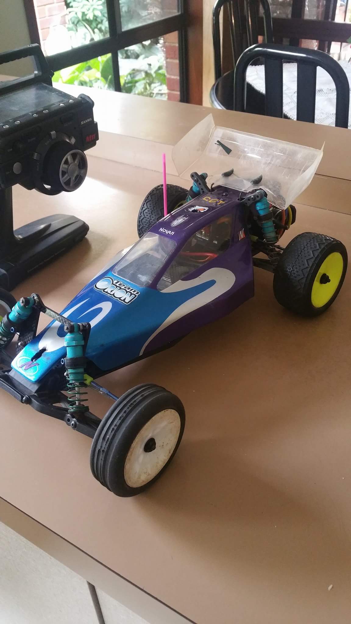

I'd say your related to green510?
Interesting use of the truck front body mounts. Keep up the good work and looking forward to action shots.

Looks suspiciously like this one: http://www.rc10talk.com/viewtopic.php?f=88&t=41706. 8) I really like simple paint schemes. Maybe because that's all I am capable of... :lol:

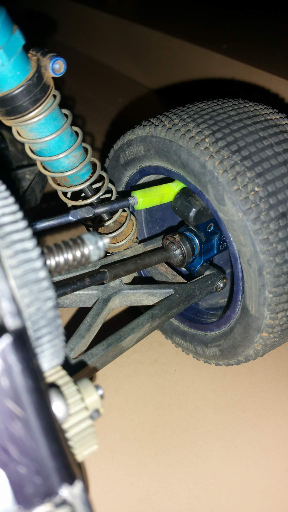

Didnt get any decent shots.
Managed to tear off some chassis protector and scratch the chassis. Also the rear 3d printed motor protector cracked.
