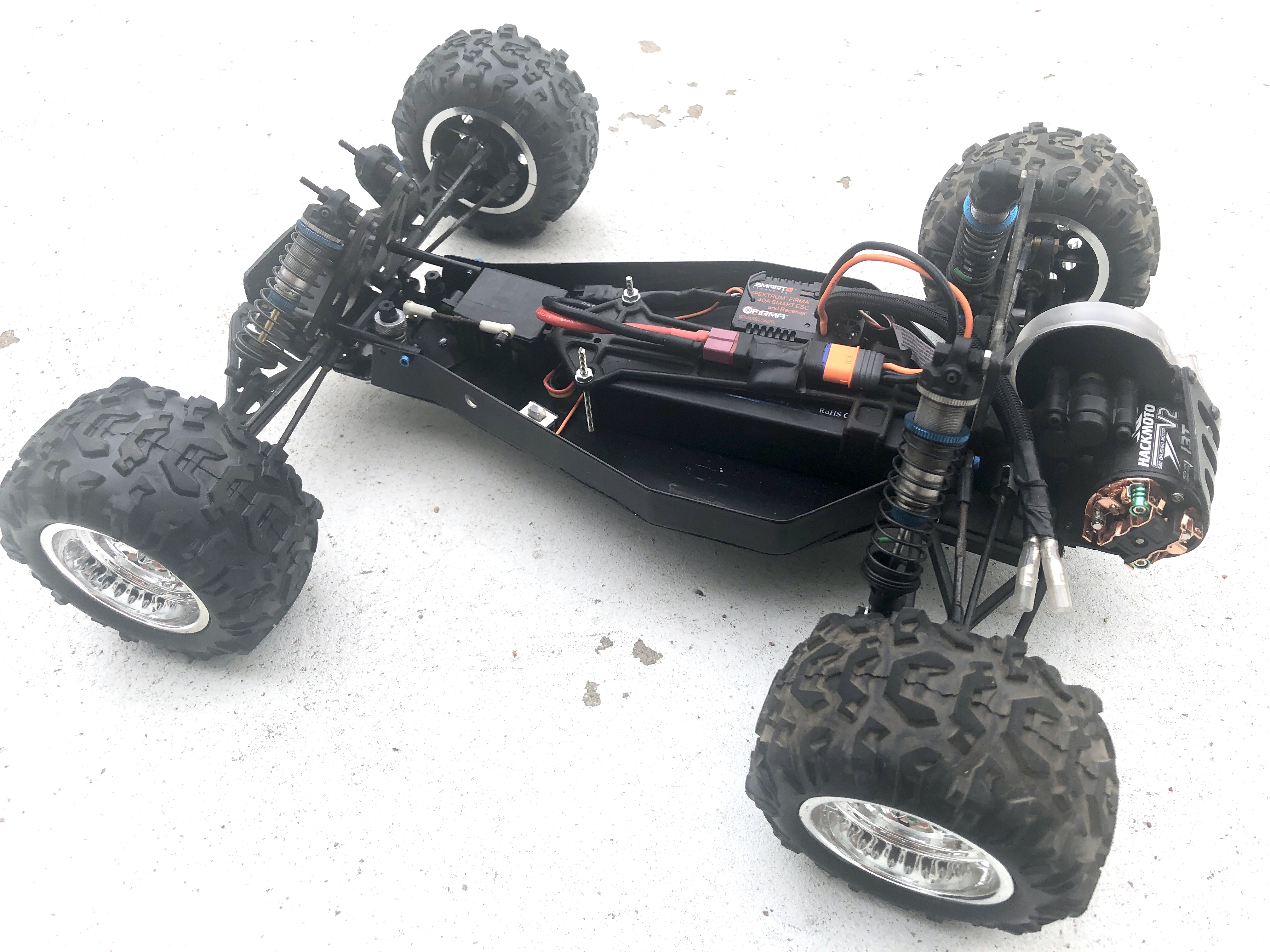

This project started out as a t2 pick up from ebay. I'm leaving the original pics up and post up below but here is the current configuration
Chassis
Handmade 3k carbon fiber with clear coat
puretech medium battery strap
fastener express screws
Electronics
Flysky Gt2b
Hobbywing quicrun 120
Savox 1258tg
Novak Ballistic 550 6.5t 3400KV rated to 4s
Wheels
rpm revolver 2.2" Rustler all around
Front end
13mm sc10 4x4 shocks
FT blue titanium camber links
lunsford titanium shock mount for t6
stock shock tower, bulk head,brace
RPM rc10t arms, hex blocks, mini bumper
rc10b4 20degree caster blocks
front spindles from traxxas rustler
j concepts ball bearing bell crank
associated molded center link
Rear end
Stock arm mounts, shock tower,bulkhead, and rear cover, rear hubs
rpm rc10t arms
MIP t4 CVD
rpm hex blocks
Transmissions
RPM gear cover
MIP carbide rebuild kit
Robinson racing aluminum diff
stock top shaft, stock slipper
nostalgia RC carbon fiber slipper pad
32pitch kimbrough 54 tooth spur gear
32 pitch rrp 14 tooth pinion

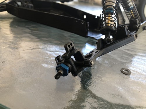

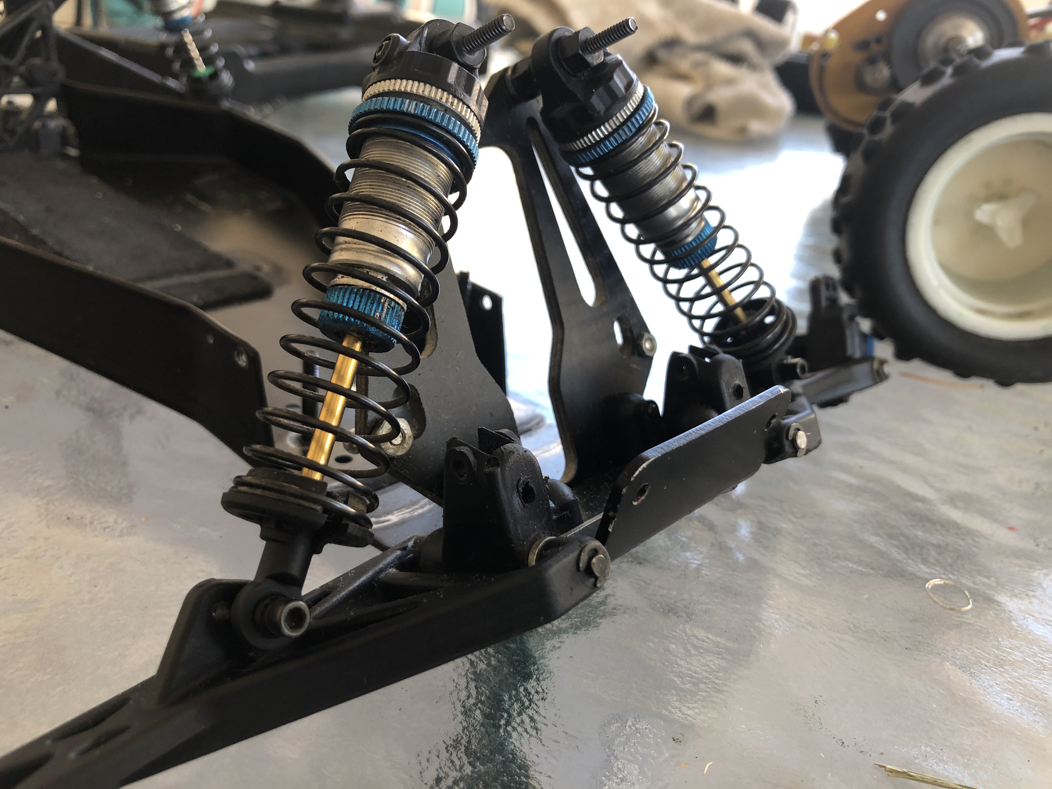

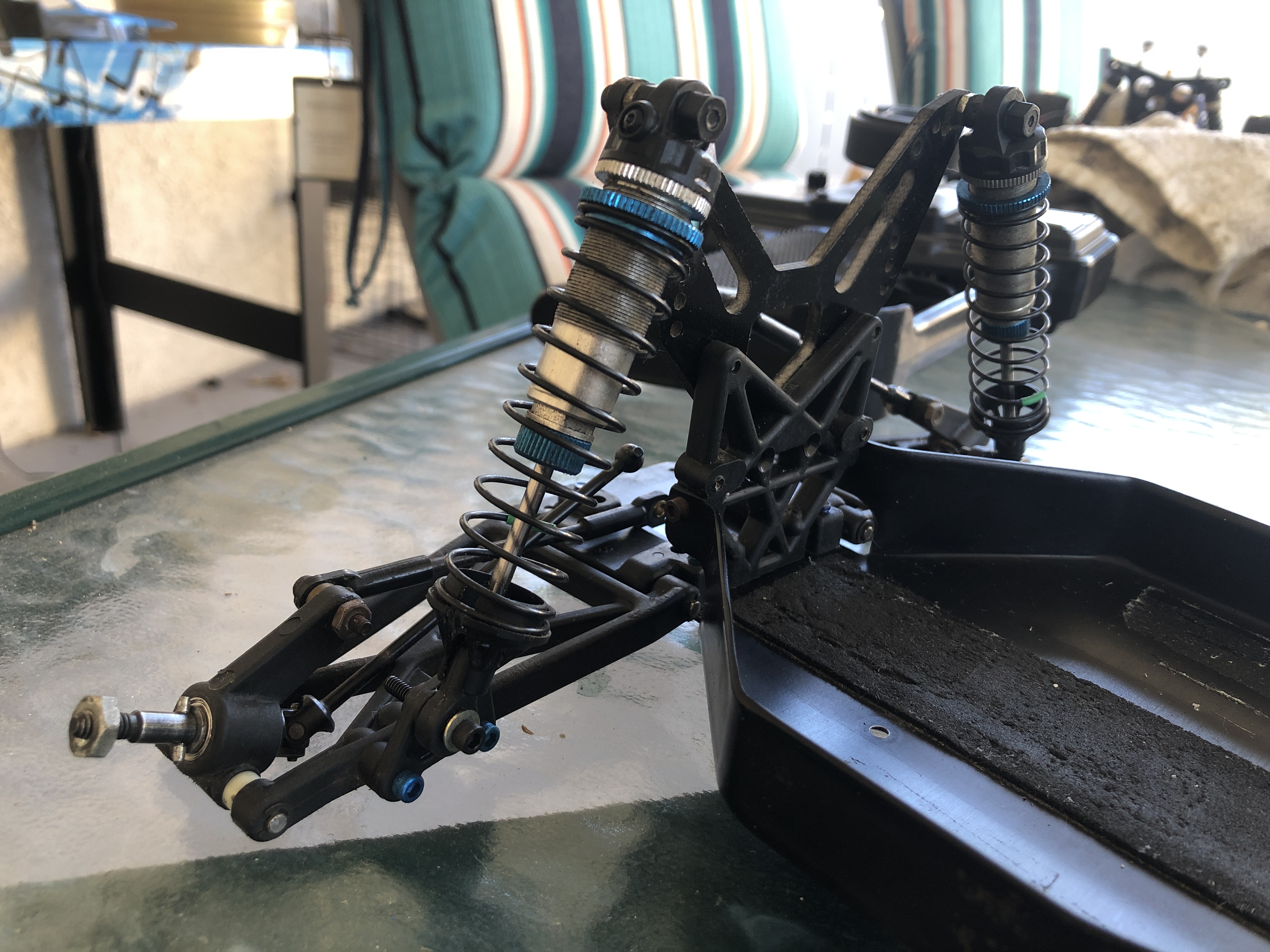

I am not sure why but I was compelled to get an rc10t2. I managed to be offered one at a darn reasonable price so I picked it up.
I spent the afternoon fitting it up.
So far I have 12mm front hexes on the b4 25degree caster blocks and some t5m big bores I got for a song.
Here it is so far.
The 4-40 nylon nuts are just right for spacing the big bores from the shock towers.
Here it is so far.

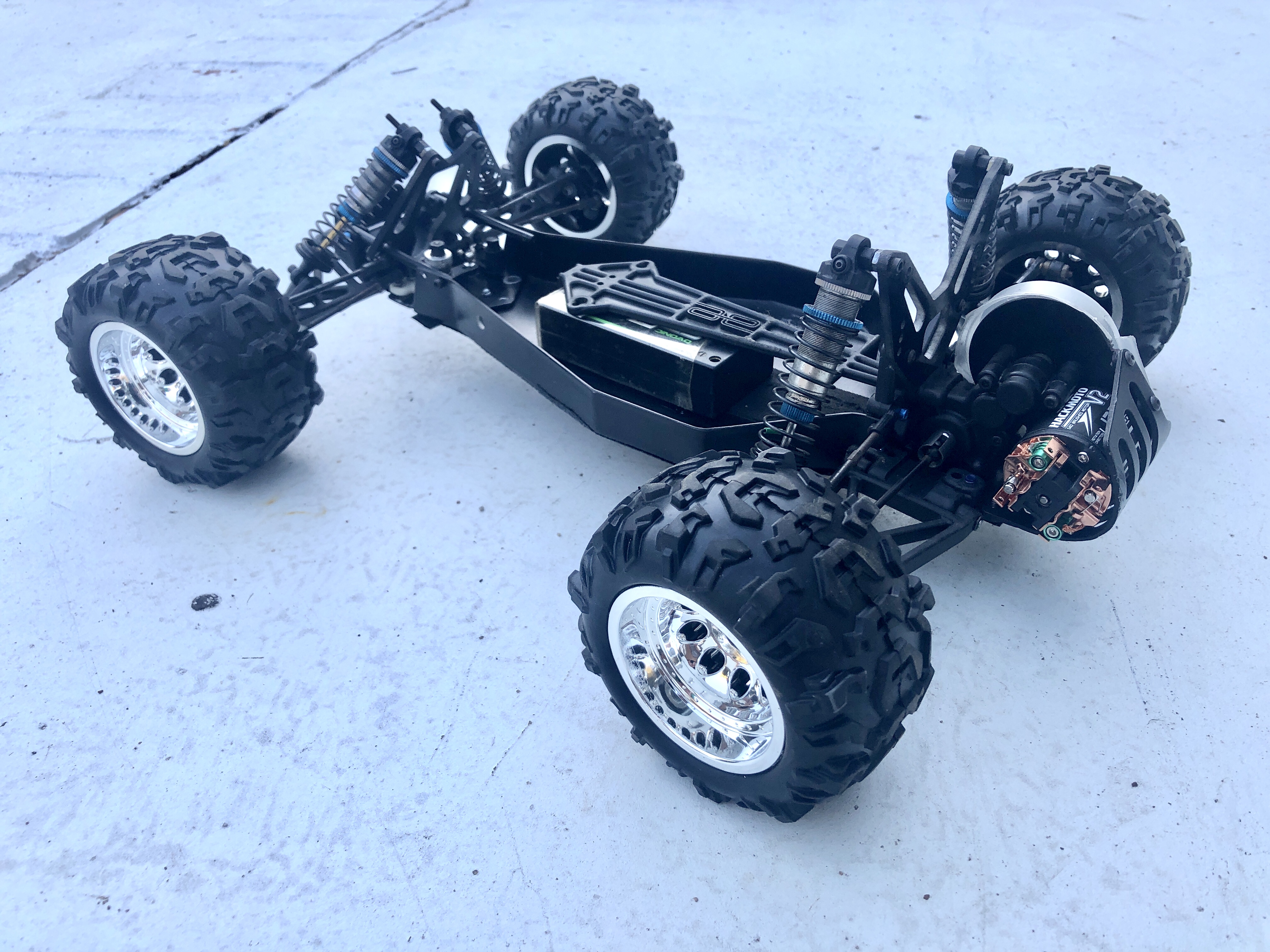

So the truck has been coming along slowly.
It amazing how much all of the small parts cost.
The diff was missing a bunch of parts once I opened it up. I got a MIP carbide diff kit. I ordered the custom works bearing for inside the diff. I also had to order some custom works ball studs to finish out the front end. The nose plate looks like it came from a gt/t since I had to cut threads in it to assemble it in the corrcet 10t2 position. I was able to get hexes on all 4 corners and hooked up the rpm revolver wheels with some traxxas tires.
I just really like this kit. Even in it’s condition it feel like a deluxe version of the Rc10t.
A bit to finish up on it. The big parts are electronics and a body.

Fitting up the electronics.
Futaba s3001
Spectrum firma 40a receiver/esc combo
Techflex clean cut wirewrap
Some threaded rod to extend the height for the lipo
Futaba s3001
