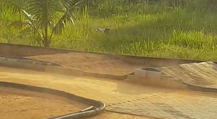

here are some videos of my tests. 1st 2 vids show test no 3 and 4, last vid test no6.
Ignore my brother he talks too much !

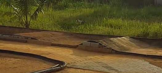

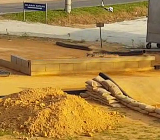

Todays run, with all 4 rear shocks.

Post by alcyon »
Screen capture
