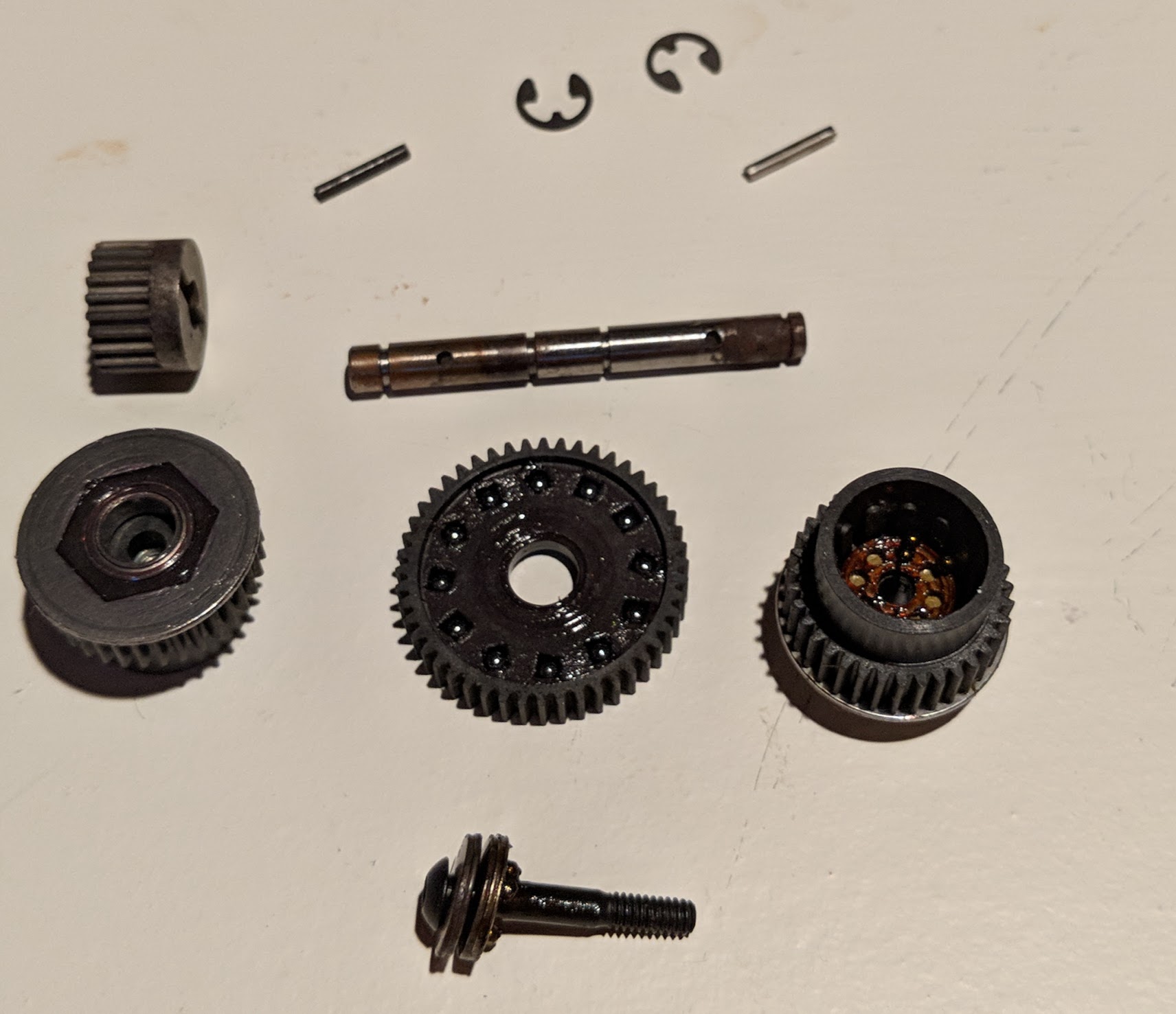

And, courtesy of Dan @ Sabula Tech, this is what a melted JRX-2 diff looks like.....matt1ptkn wrote: ↑Thu Nov 30, 2017 7:39 am For extra durability, you can always pick up a set of RPM outdrives and Thorp aluminum LRM gears, but you shouldn't need them. As I said before, just be sure that the diff is tightened properly. One weakness I know about the LRM, is that if the diff is at all too loose, the diff balls will melt into the diff gear. I've purchased many LRMs that have had this happen. Bandit slider axles are supposed to fit, but you shouldn't have any issues with the Losi ones. But if you want/need replacements, Bandit's will be a lot cheaper. I've had some issues with the front bulkhead and A-arms becoming brittle, but unfortunately, there aren't too many options other than watching for parts lots/cars on eBay and stocking up on spares. Same thing with the steering bellcranks, but Sabula Tech has some nice 3D printed ones. Threaded shocks won't be a necessity for bashing and I'd spend my money elsewhere. I've never really had a problem with the Losi turnbuckles or ball ends/studs, but titanium turnbuckles are usually a good idea and RPM ball cups. Spare parts for these are usually easy to find, and with some patience, you can get some good deals versus buying the overpriced NIP parts.

I feel the most important part of making the car tougher/last longer is definitely the slipper. The center diff gear is the weak point, so adding some protection by means of a slipper makes it very reliable.

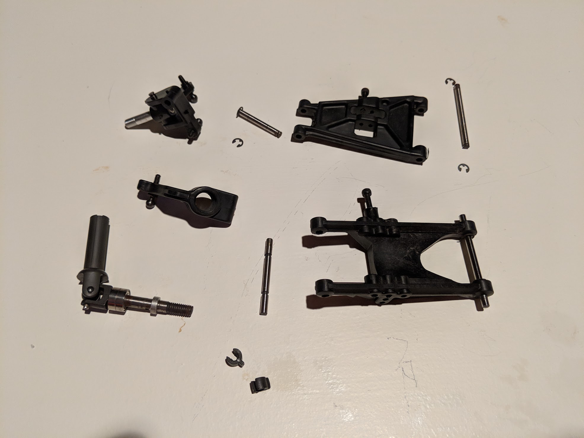

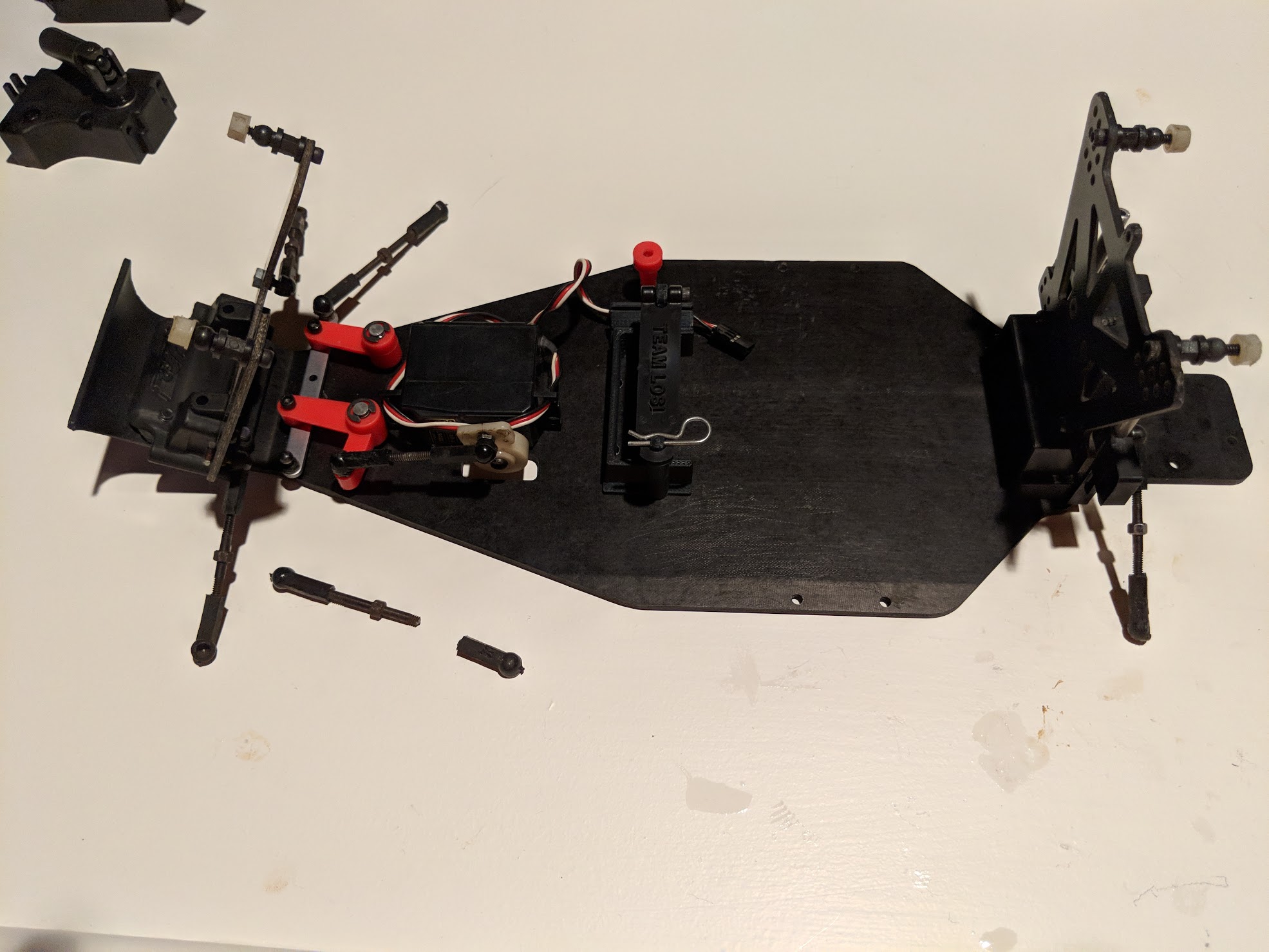

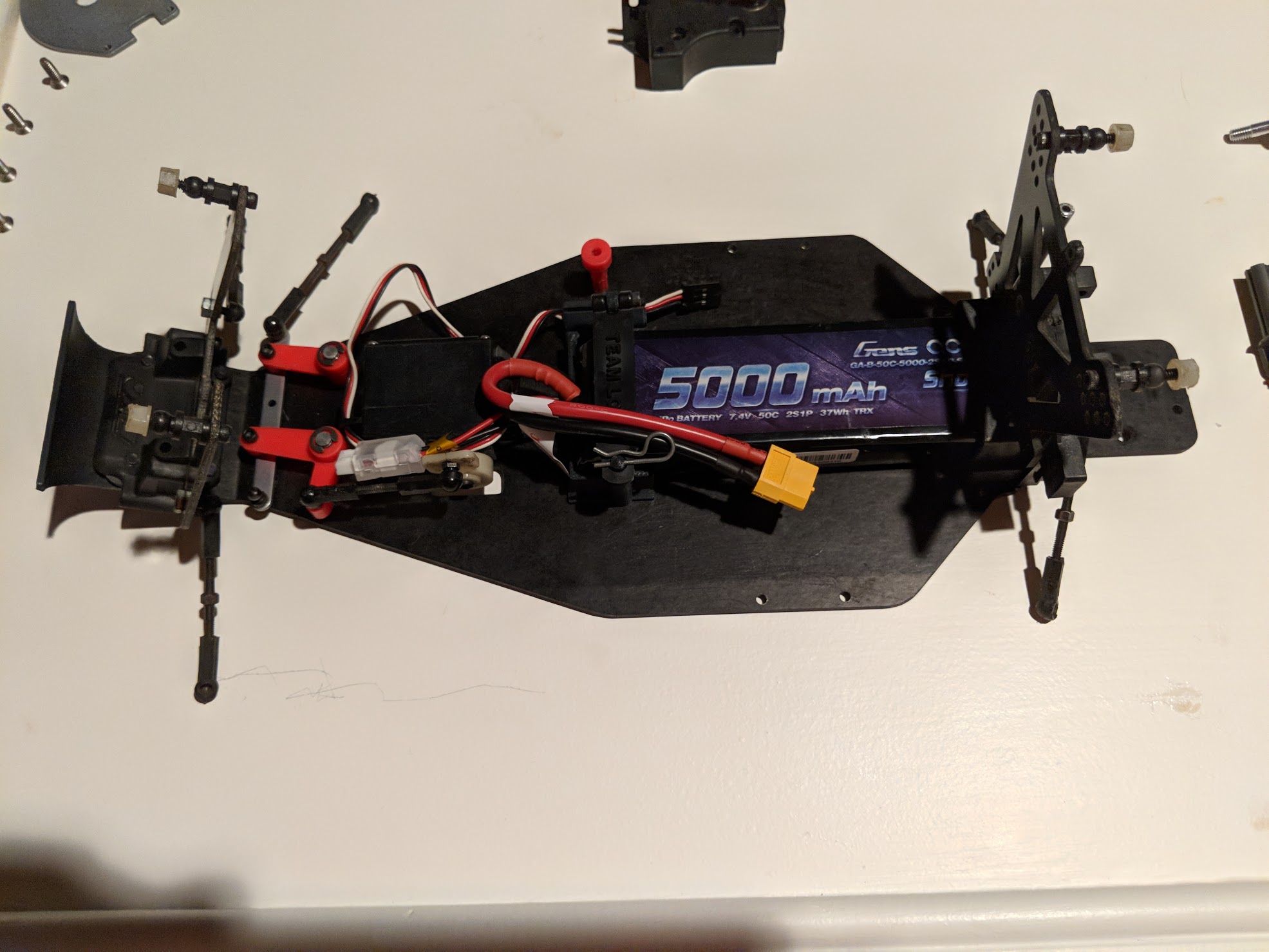

Thanks again for all the input. Here's an update on my project:
Received the car and it's in pretty good shape from what I can tell. All of the pictures below are before doing any cleaning. I'm still missing some parts so it'll be a few weeks before it's running. In the meantime, I'm going to clean and rebuild the tranny and shocks. Based on suggestions from you guys, I'll upgrade to the vintage losi dual disk slipper, but keep the original LRM. Will also upgrade Lunsford turnbuckles and ball cups -- already snapped one during the disassemble. Everything else stock for the time being.
After a bunch of searching, I found the right-sized LiPo battery: https://www.genstattu.com/gens-ace-5000mah-7-4v-50c-2s1p-short-size-lipo-battery-pack-with-xt60-plug.html. Fits perfectly, when combined with slightly longer cup from Sabula: http://sabulatech.com/storefront/index.php?id_product=2829&controller=product
Went with Hobbywing stock brushless, sensored motor/ESC combo and Savox servo.

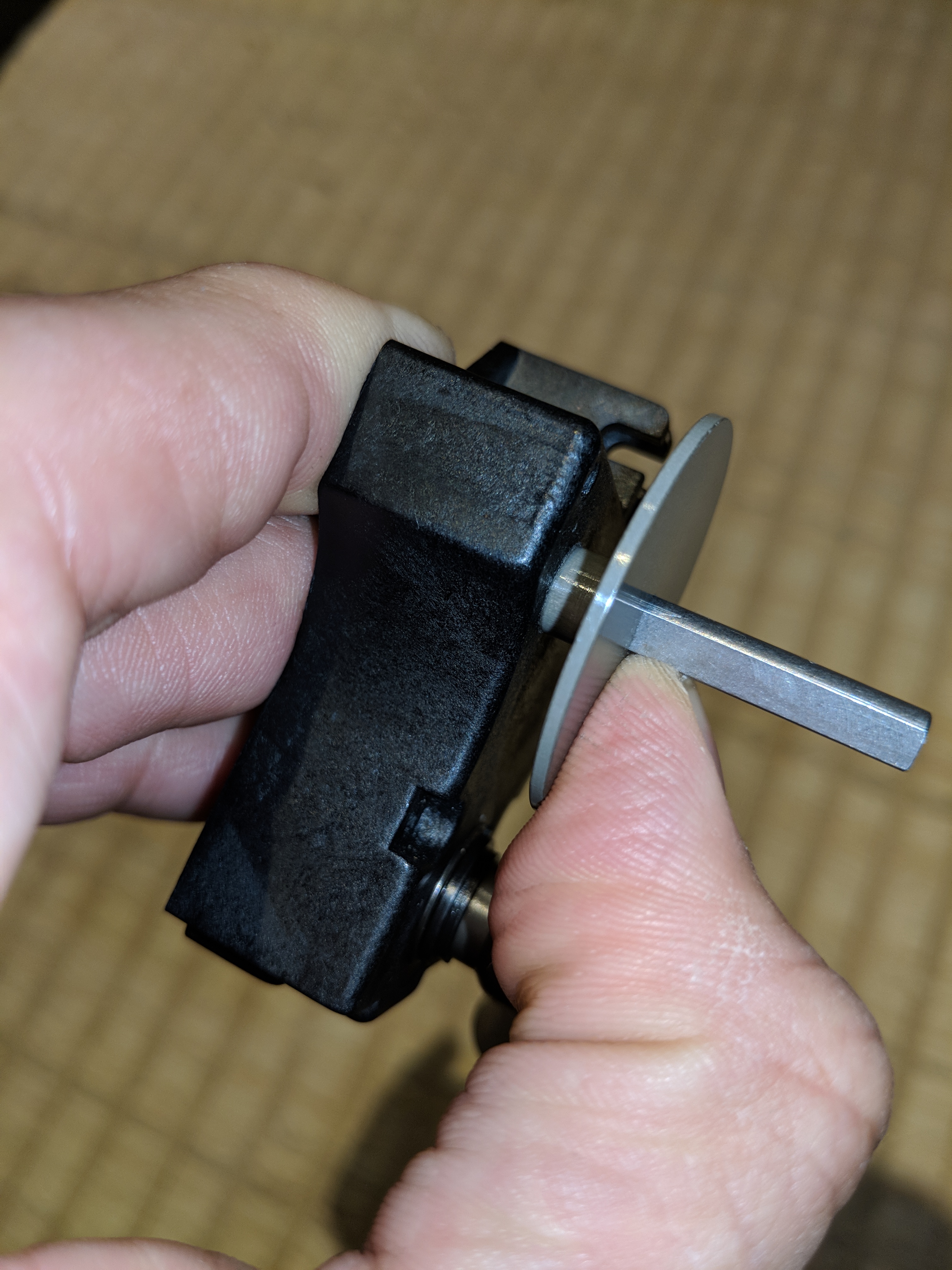

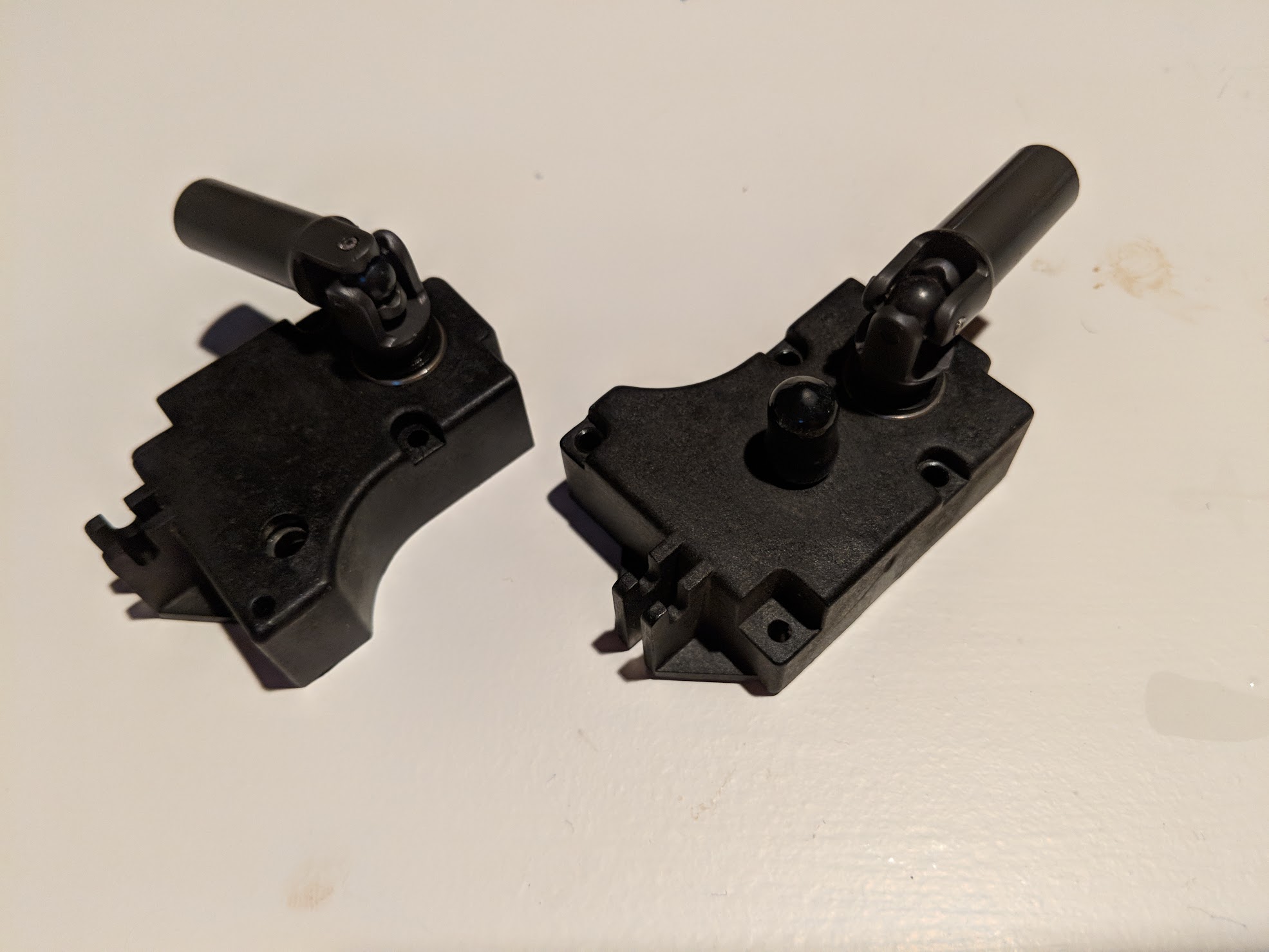

Thanks, guys. I just received some of the slipper parts I ordered and now I'm not sure if it'll work. I'm using the longer slipper input shaft (a3120) along with the rear back plate (a3121), but the back plate does not fit inside the output hole of the gearbox. i looked up some instructions: http://vintagelosi.com/Instructions_files/Friction_Slipper_A3110.pdf which say "The output hole for the top shaft has been enlarged in later production to accept the slipper backplate. If you are adapting the slipper to a previous version, the hole needs to be enlarged to a 5/16" diameter. Be sure to keep the drill bit centered in the smaller hole. If the larger hole is drilled too far off center, your transmission may not perform properly."
Wish I seen this before I started buying parts. Has anyone else done this? Is there another gearbox housing option that doesn't require modifications?

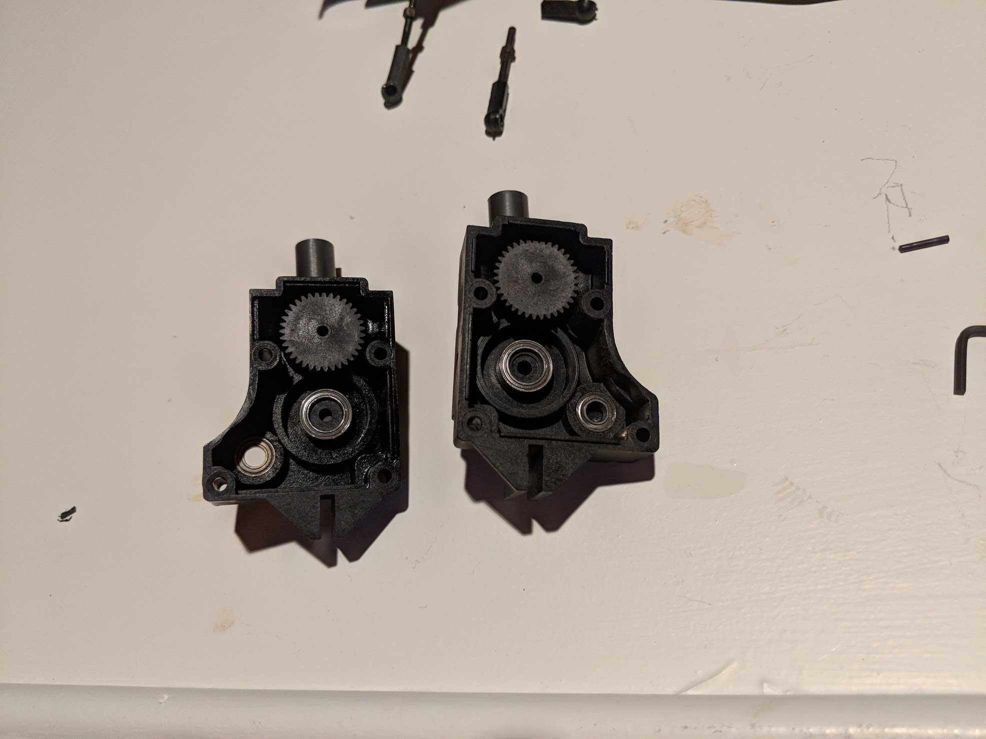

Found my answer in the Losi variations thread.
Saw another post that suggested using a body reamer tool. Gonna give that a shot.aconsola wrote: ↑Tue Jul 21, 2009 10:03 pm found another variation tonight. I was rebuilding/upgrading my VONATS racer: adding a slipper clutch and thorp aluminum BB diff gear.
When putting the whole thing back together I noticed that the inner slipper plate did not sit as far down as it should.
A little investigation lead me to find that there are 2 transmission cases (3 if you count the grey one)
The difference is in the size of the hole for the trans output shaft. The presumeably older version has a narrow opening(about1/4") while the newer one has a 5/16" hole. Not a huge difference, but enough to give clearance to the slipper backing plate.
The pictured 5/16" case was just taken out of the package for the picture. It had the original jrx-2 logo header card on it.
