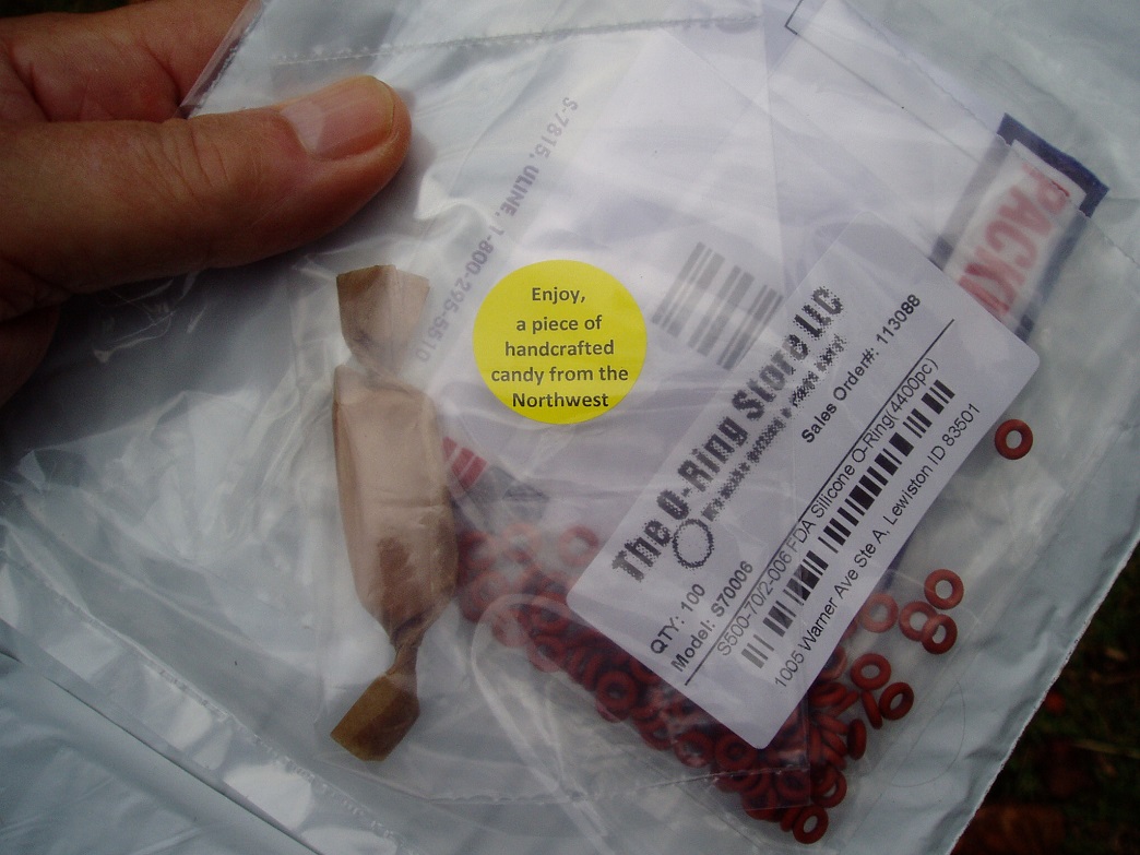

Hey Peter I just checked your ProCAT instruction manual and was able to confirm it also uses 1/8" silicone o-rings for the shock seals. So, if you have spares from that car they likely will work in your RC10 shocks as well.
Also, I just purchased 100 of these seals from an online source called The O-Ring Store LLC but they are also available from most industrial supply outlets like McMaster Carr. They are 1/16” cross-section and identified as uniform dash number -006. The ones I purchased cost $4 /100 plus $6 postage to my home in Alabama. Oh, and they arrived with a delicious piece of candy to sweeten the deal.

Thanks. I don't think I have any ProCAT ones either. If I do they'll be 25ish years old.XLR8 wrote: ↑Thu Nov 30, 2017 8:08 pm Hey Peter I just checked your ProCAT instruction manual and was able to confirm it also uses 1/8" silicone o-rings for the shock seals. So, if you have spares from that car they likely will work in your RC10 shocks as well.
Also, I just purchased 100 of these seals from an online source called The O-Ring Store LLC but they are also available from most industrial supply outlets like McMaster Carr. They are 1/16” cross-section and identified as uniform dash number -006. The ones I purchased cost $4 /100 plus $6 postage to my home in Alabama. Oh, and they arrived with a delicious piece of candy to sweeten the deal.![]()
I did see the discussion about o-rings and the pack you got. I'm in the UK though and, so far, haven't been able to find a local supplier.
I could probably find or get hold of some Tamiya o-rings, but I'm not sure if they're the same size.

look for ebay seller: sealforce53 They are UK based and have the correct o-rings (size BS006)
I use those seals in my modern racers and there is no difference from AE ones.

Thanks, I'll remember them in future. I actually took a punt on some from RS Components which are the same BS006 size.
Hopefully they and/or a new shock rebuild kit will be with me tomorrow or early next week so I can finish off the front shocks.
