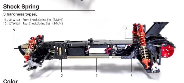

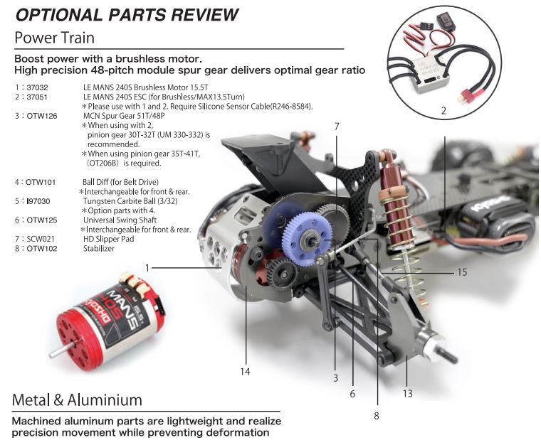

Curious! Here are photos published in Kyosho's option catalog for Javelin and they show the brushless 240s motor installed in the car. How are they able to do this if wire lugs interfere with the motor guard? Are the 240s and 17.5 motor cans really that different?
- Posts: 212
- Joined: Tue Feb 07, 2012 1:57 pm
- Location: IL
- Has thanked: 9 times
- Been thanked: 9 times
Re: New LeMans 240S Brushless question
They have conveniently covered up the installed motor tabs in these pics, but I believe the 17.5 motor has the tabs swept "forward" where the 240s is "backward"XLR8 wrote: ↑Wed Jan 31, 2018 9:28 pmorangemazda wrote: ↑Tue Jan 30, 2018 6:18 pm I bought a Le Mans 17.5 on sale for $31 on the Kyosho America website. I intended it to go into my new Javelin but like you said, the motor tabs hit the motor guard. Any recommendations on a brushless motor that will fit the Javelin nicely?
Timmahhh wrote: ↑Tue Jan 30, 2018 6:08 pm I get the impression that either Kyosho didn't put a lot of thought into the motors, or that they didn't put a lot of thought into the translation. I have one of their other brushless lemans motors, and it won't even fit in an optima with the wire tabs they put on it. Its kind of weird how little it says kyosho on the package. Either way, the motors and ESC both look very cool. As for performance, I would suspect the 15.5 will be faster, regardless of the specs they have on it. I honestly think someone just didn't enter the information correctly, but I could be wrong.

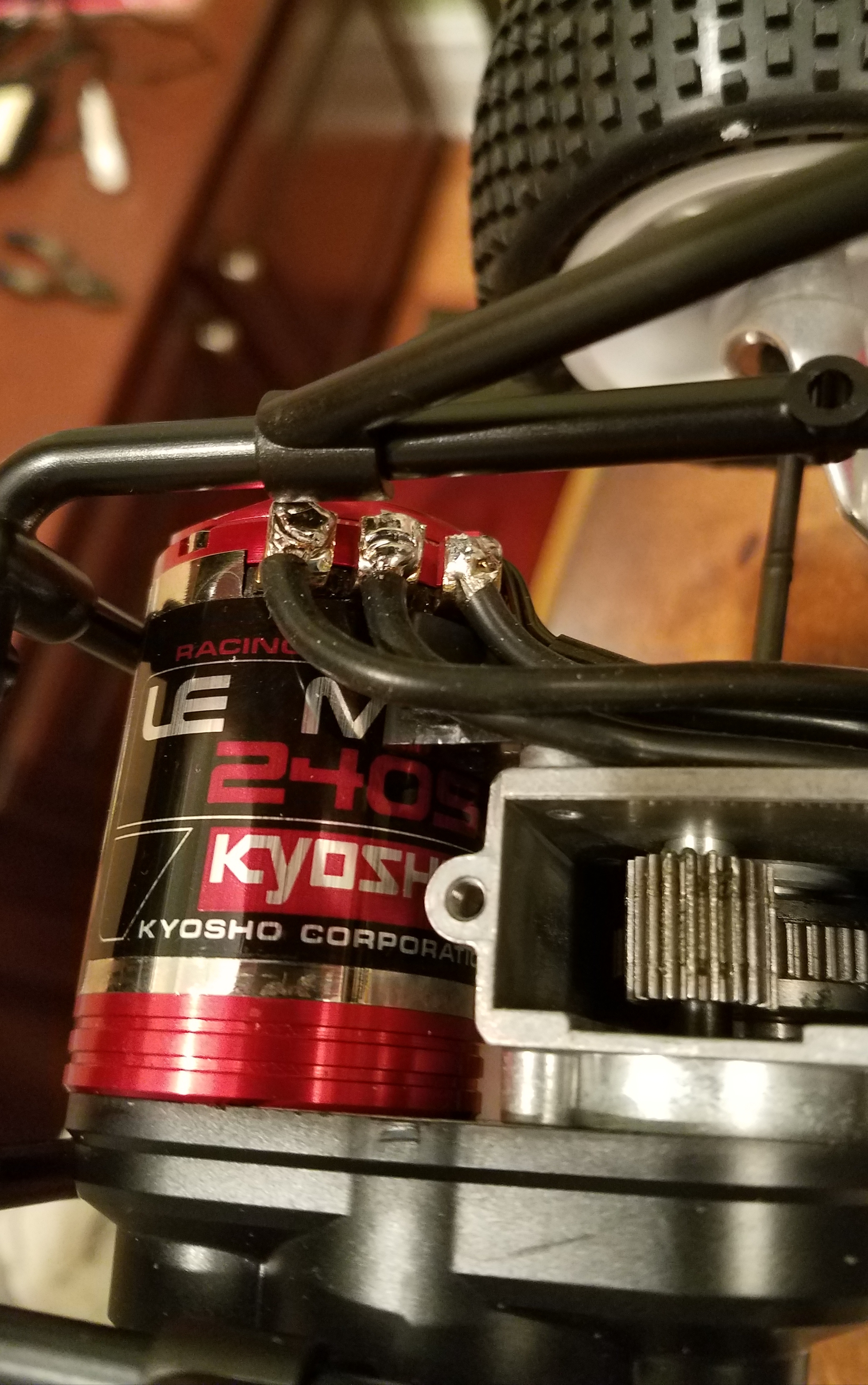

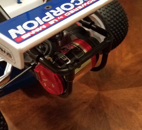

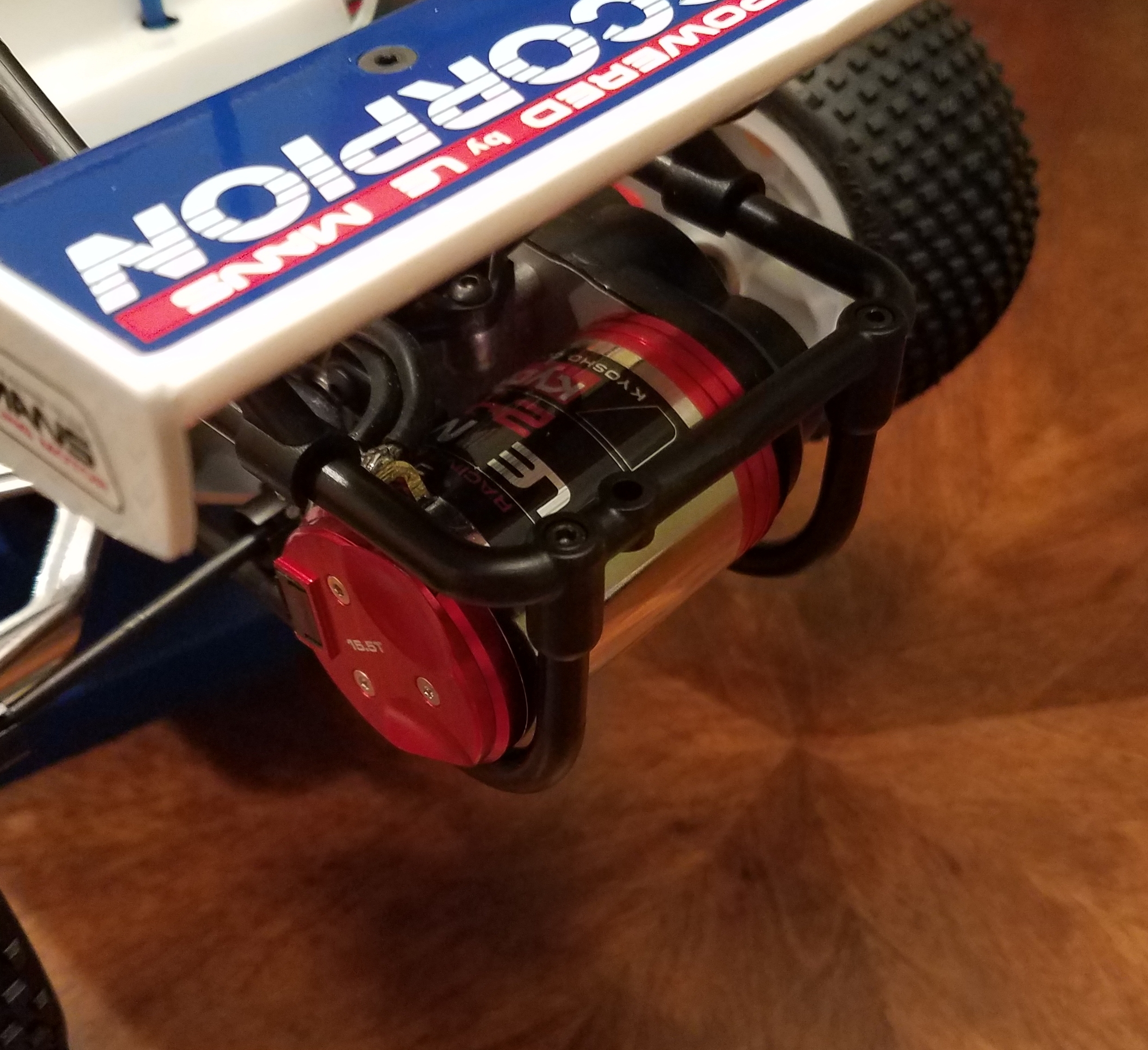

I went with the LeMans 240S 15.5T.
The tabs were tight but they just barely fit. The tabs on the 240S motors are turned opposite from the regular LeMans brushless motors. They are also an open "U" shape that allows you to route the wire to the motor from either direction. Here's a couple of pics installed. I just finished tonight and haven't ran it yet so I don't know how strong it is...but it sure is pretty.
