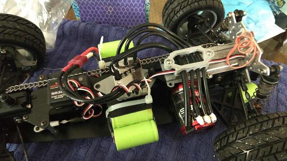

I've gotten a couple of short runs with my Le Mans ESC/Motor setup and it's been fun! The braking gets weak at slow speeds, but is nice and strong at speed. The reversing scheme gets a little awkward to use because reverse has no braking, so you end up with a delay to go forward again. But that's only really been a nuisance, so far.
I'm still fiddling around with how I'm laying out the electrics and mounts in my Rocky, so it's bound to change. But attached is what it looks like since the dog caught it. I used those threaded holes to bolt it to a mounting plate I 3D printed that also has a washer for the chassis adjustment screw on the rear gearbox. When I get a battery carrier and rear body mount that works, I was thinking I'd try to replace that plate with one that has a more positive chain adjustment method.
