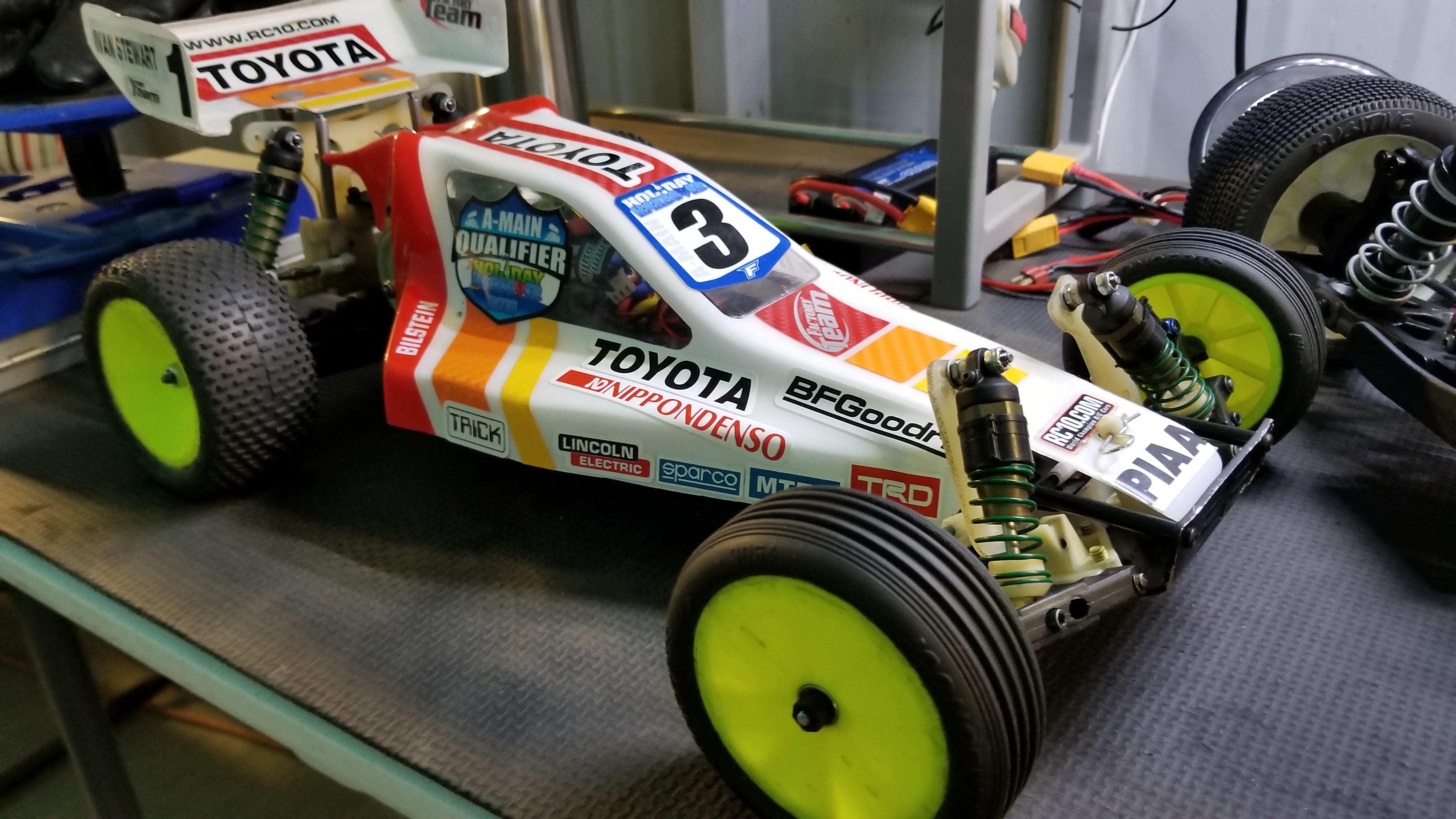

RC10 GTM - 2wd Buggy (15 drivers)

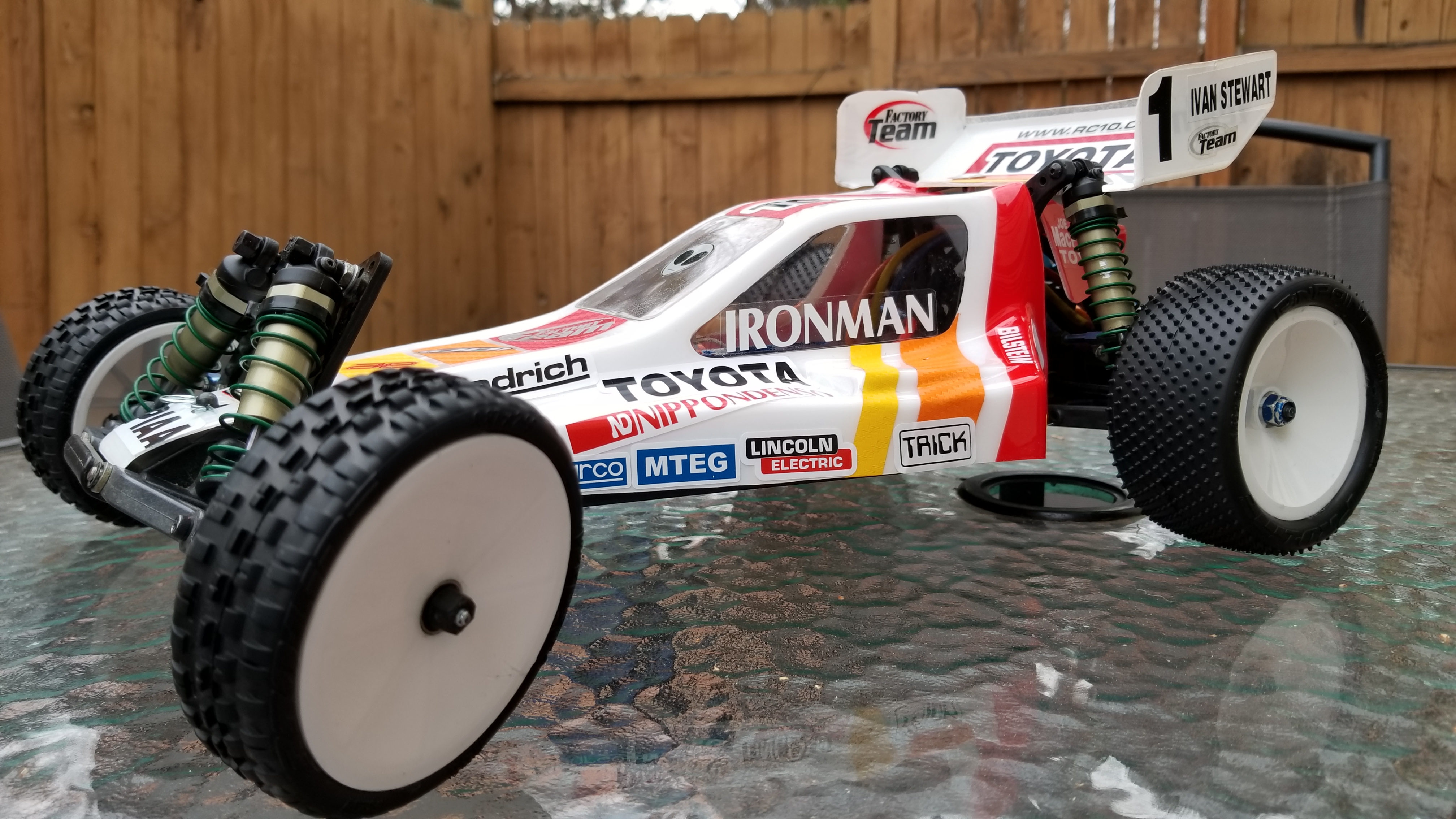

The Hangover track was super challenging for 2wd buggies due to the very low traction and large jumps. There was even a consideration by the organizers to have the 2wd classes skip the Tekno hip jump due to the difficulty and possibility of having marshals running up there all the time. In the end everybody ran it just fine. This unique buggy is a RC10 GT tub chassis, transmission, and rear arm mounts with RC10 Team Car suspension, and 3D printed waterfall and battery box I designed. I stayed with front JConcepts Rips all weekend and after experimenting with Holeshots, Blockades, and AKA Impacts, I finally stuck with well worn Proline Bowties. They had tremendous forward bite on the dusty and blown out track, allowing the car to drive really well. The only change I made was for third round, adding 1.25oz under the trans, and 0.5oz in front; I then set the fastest 2wd buggy lap time of the event with a 36.780! That speed did not fully get used, with a few mistakes here and there, but I ended up a close second in the round to Dave Gullickson. In the A1 main I backed it up with 3rd place finish even after getting shuffled to the back in the second lap. A2 was not so good with a popped ball cup (and the millenial marshal who lacked the hand strength to pop it back on) ending my podium chances. I did convince the marshal to put the car down so I could drive it back to me to pop the cup back on, and I finished the main with a few laps just for fun, including a couple of back flips off the Tekno hip jump (easy when the turbo timing kicks in yo).

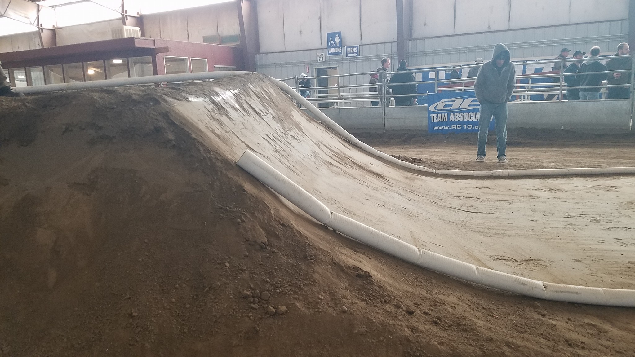

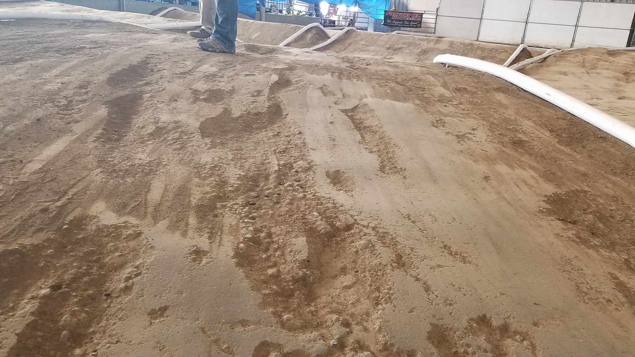

Re: RC10 GTM Buggy (GT tub chassis+trans)

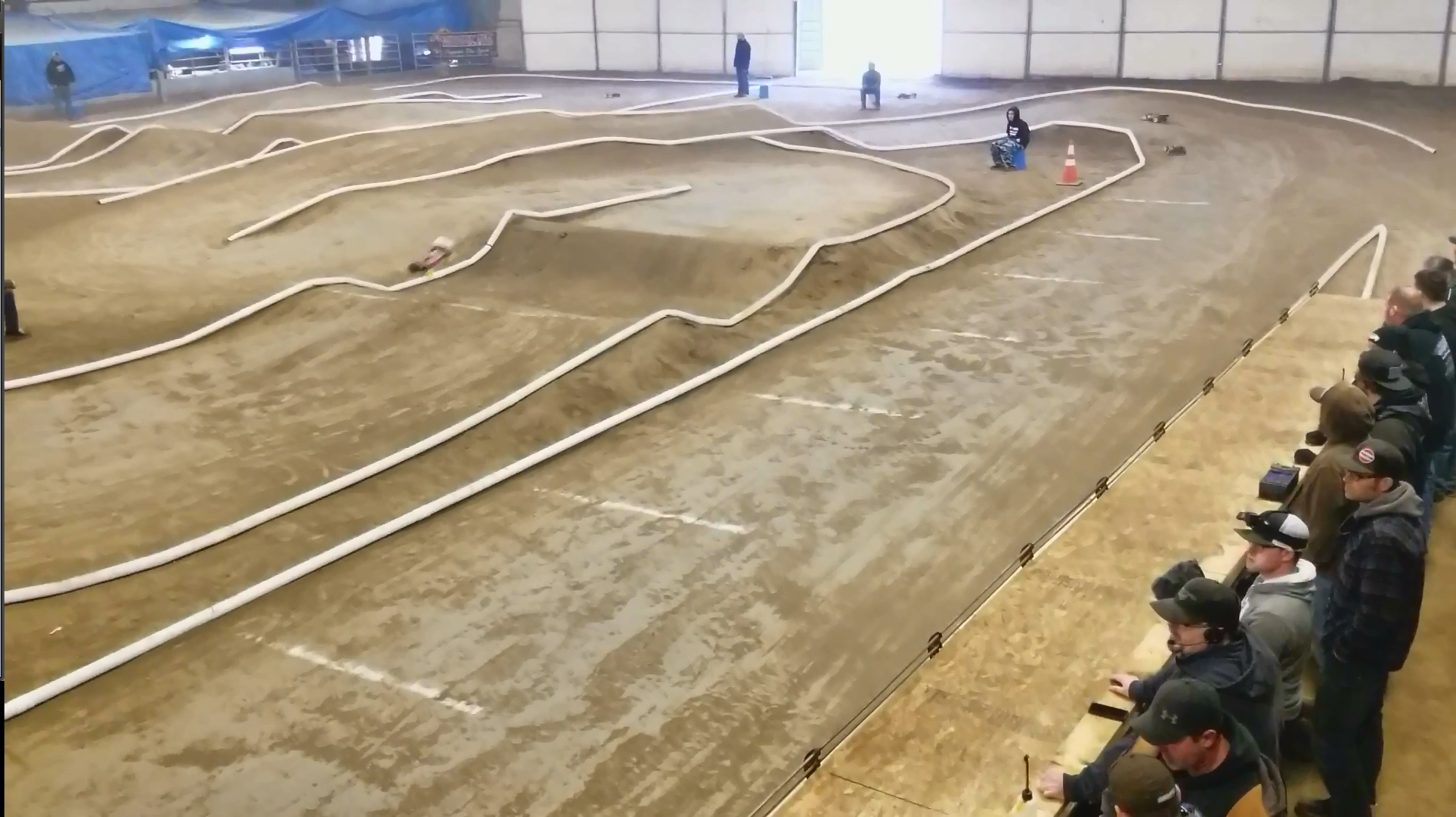

This was the surface it was raced on, handled it just fine:

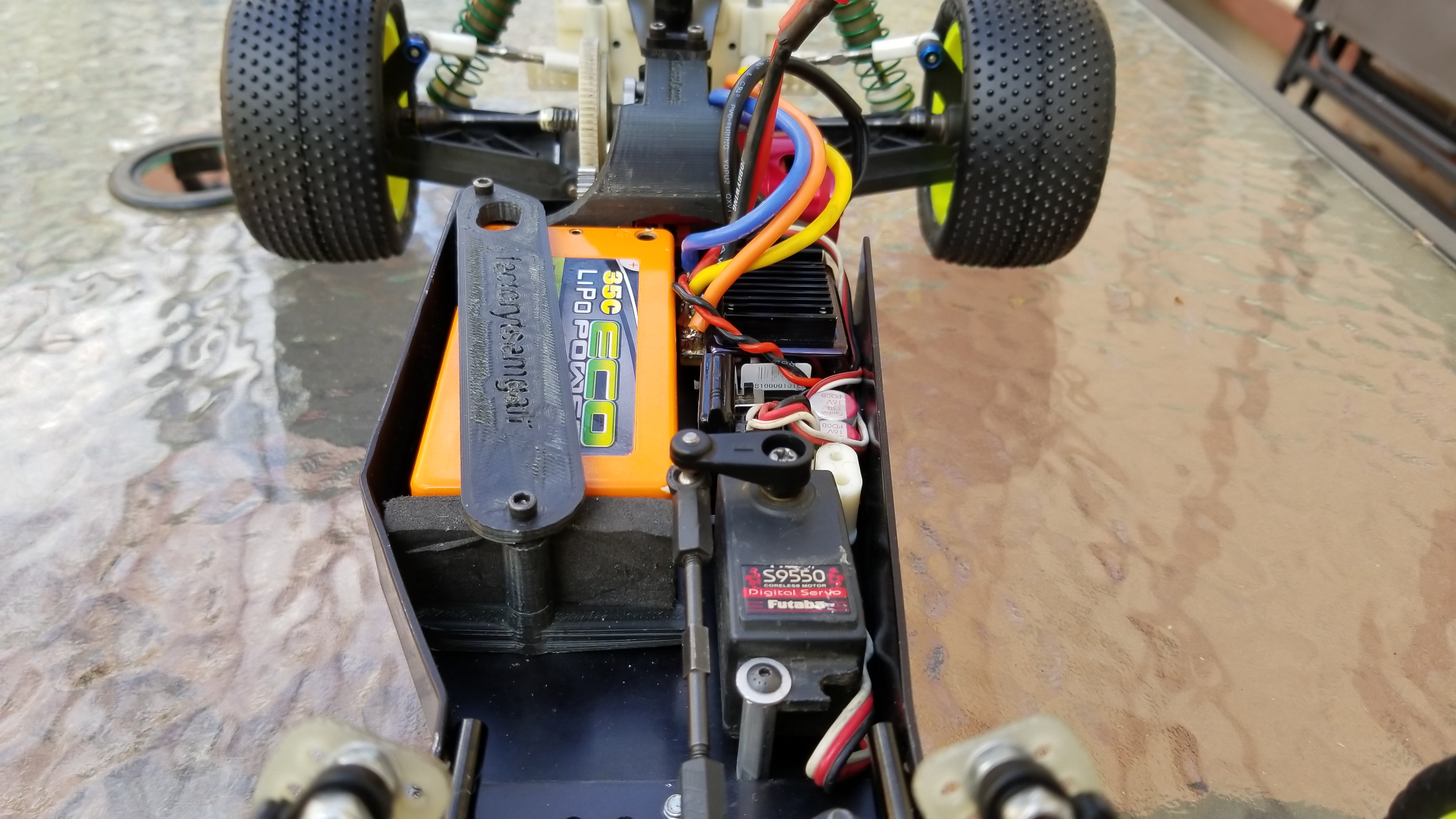

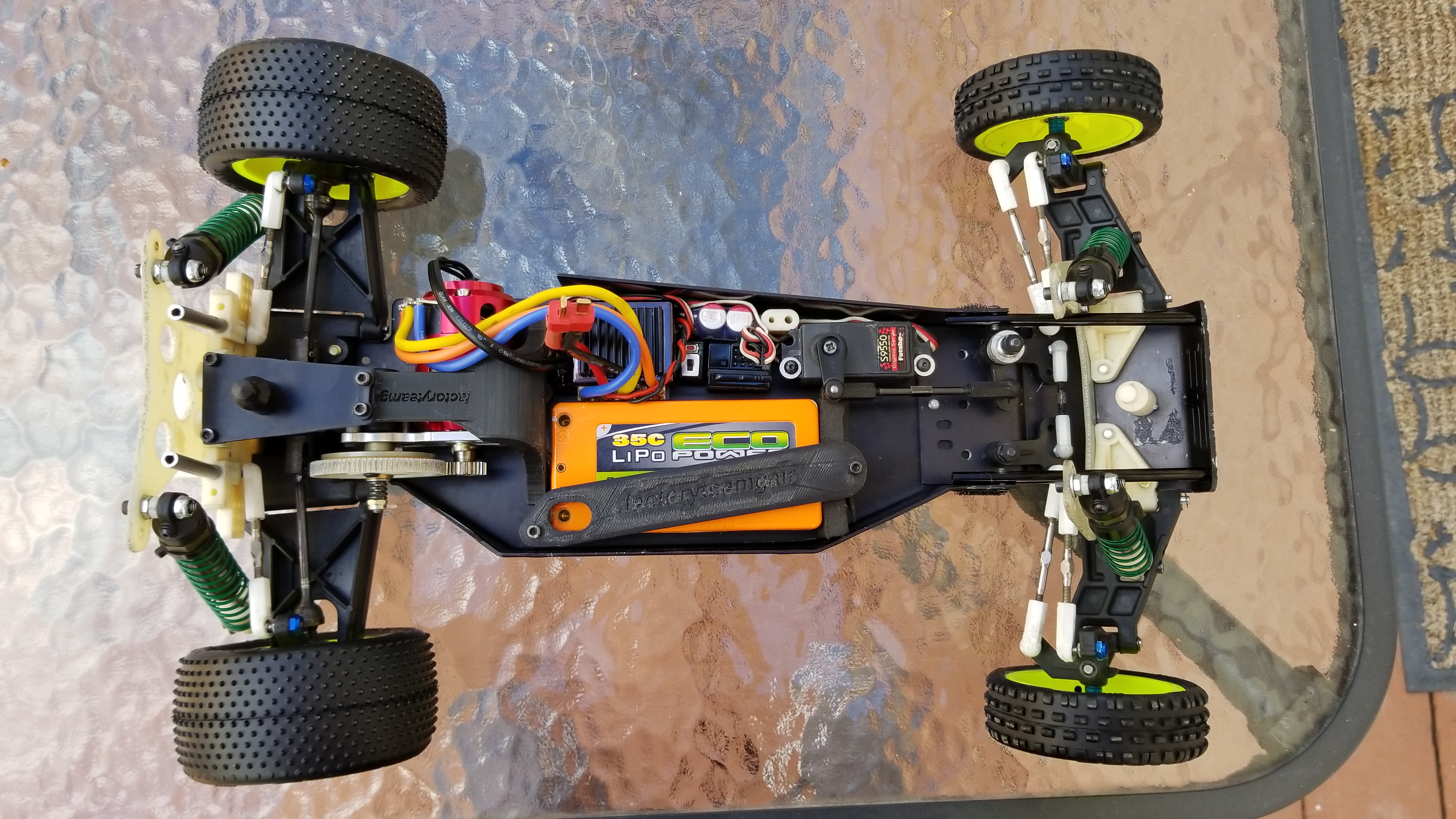

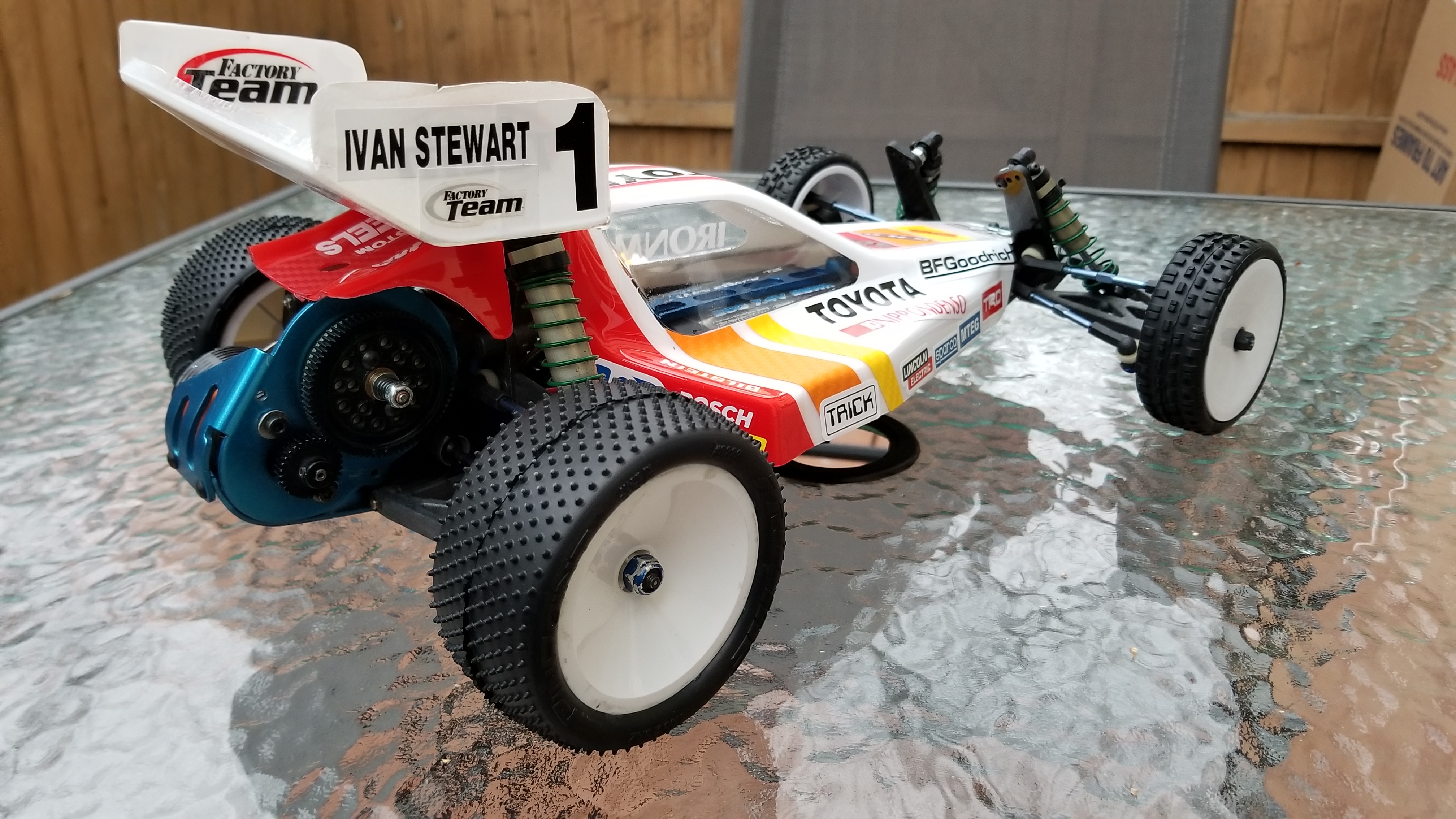

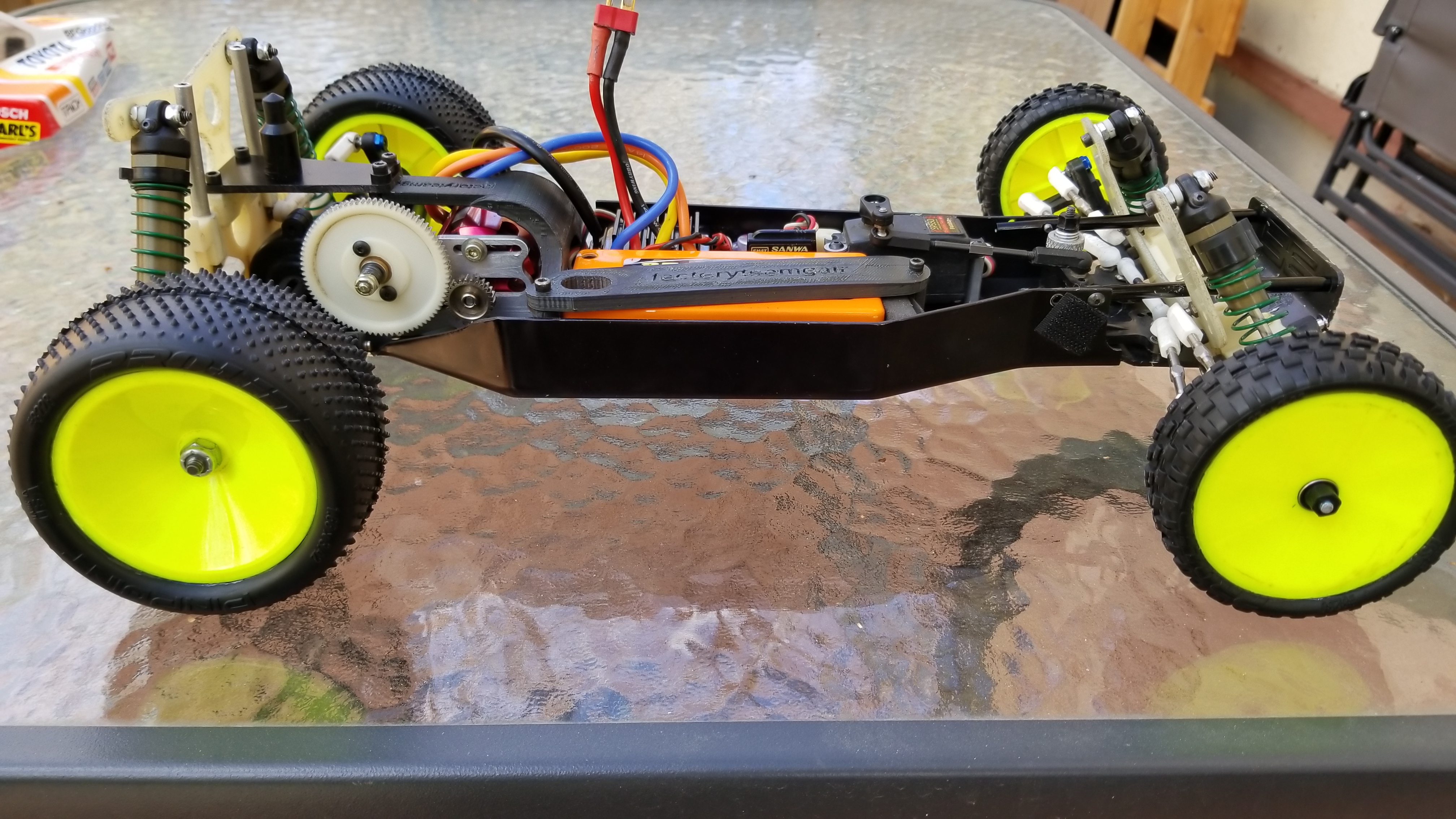

This unique buggy is a RC10 GT tub chassis, transmission, and rear arm mounts with RC10 Team Car suspension, and 3D printed waterfall and battery box I designed. On the standard 3 gear GT trans you get a slipper and large 2.6 diff designed for a nitro truck, which should be able to handle modern 2wd buggy needs. The layshaft is centered 27mm above the chassis, seems pretty low to me. Standard Team Car short arms and hard anodized shocks from 1990-1993 are used, but the arms and knuckles had to be changed out because the original white parts disintegrated due to age. RPM ball cups and Lunsford Ti turnbuckles are needed for racing. I finished off the project by designing and 3d printing the waterfall and battery box, and made sure to use existing chassis holes. A B3 body is used since I intend to switch back and forth between the project car and a standard FT B3. The Ivan "Ironman" Stewart sponsor stickers came from Discount RC Decals, and the stripes are 'carbon fiber' vinyl for cars/bikes.

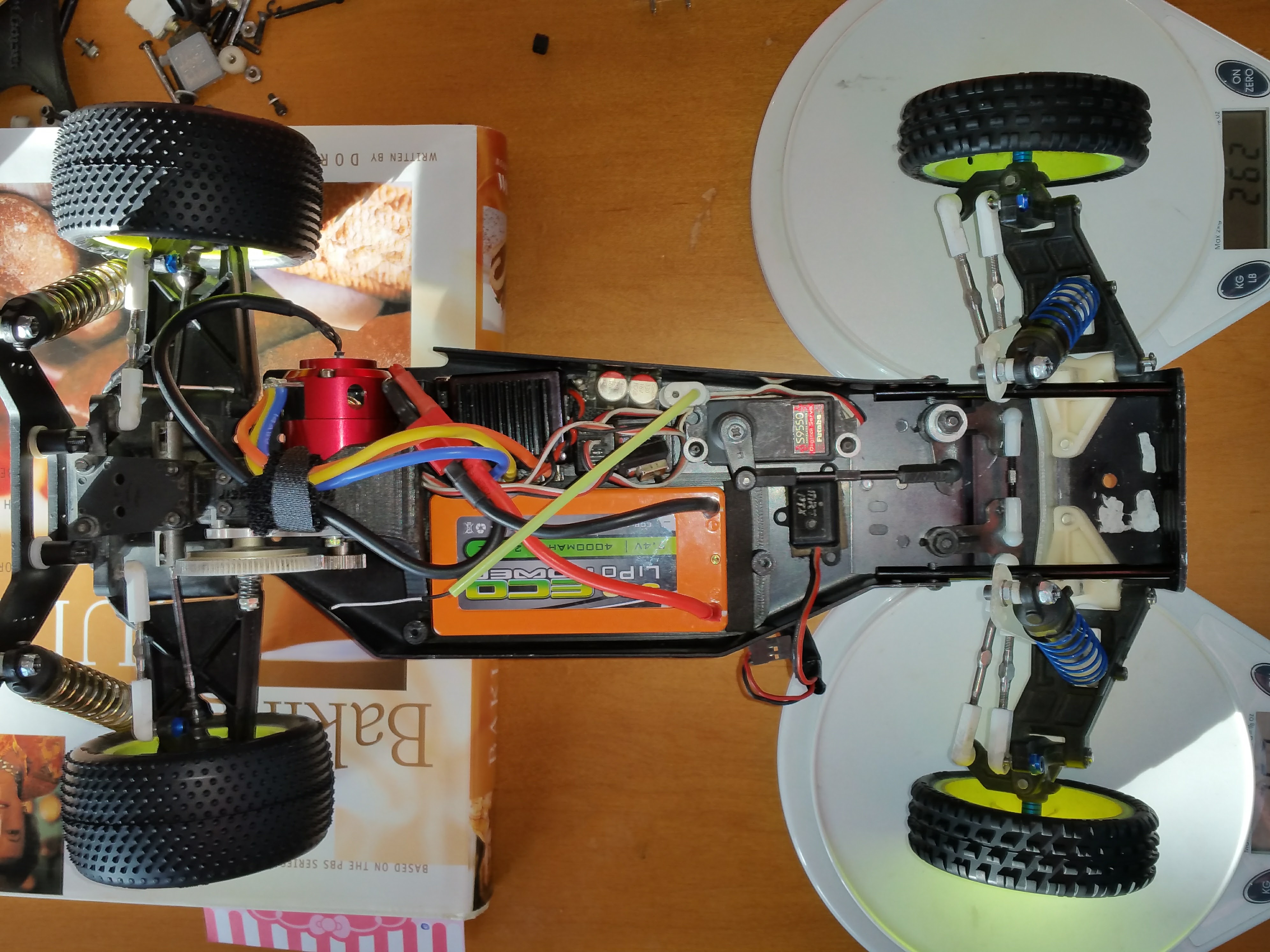

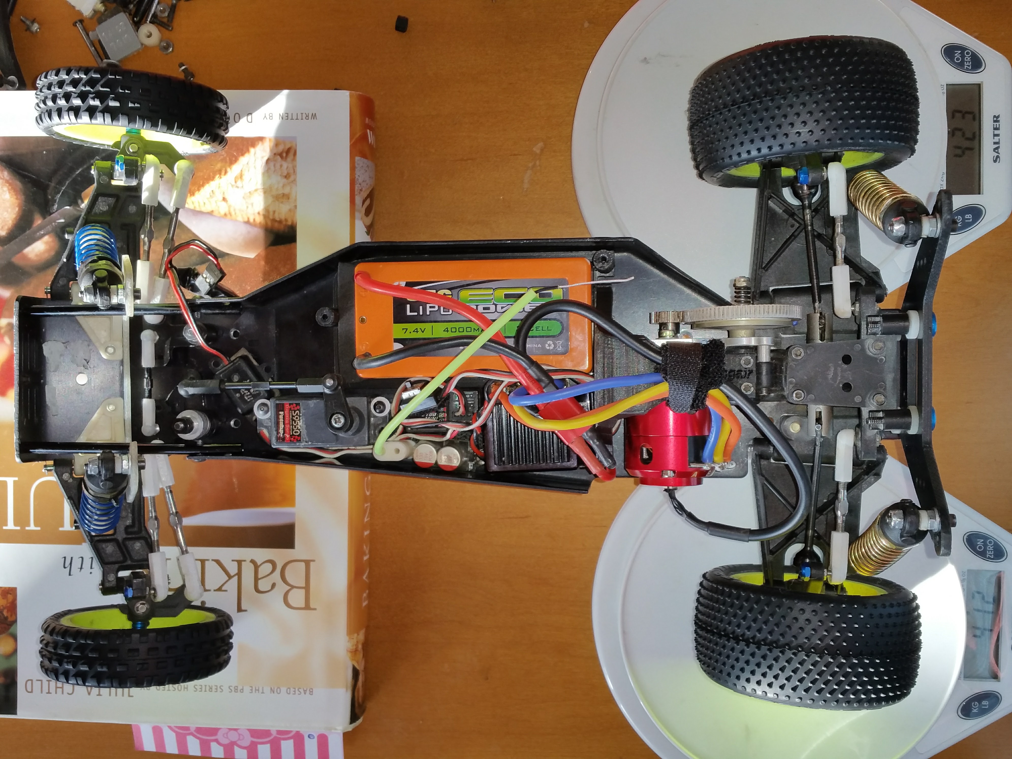

Back when I first built it with a GT rear bulkhead and tower, and was checking the balance:
