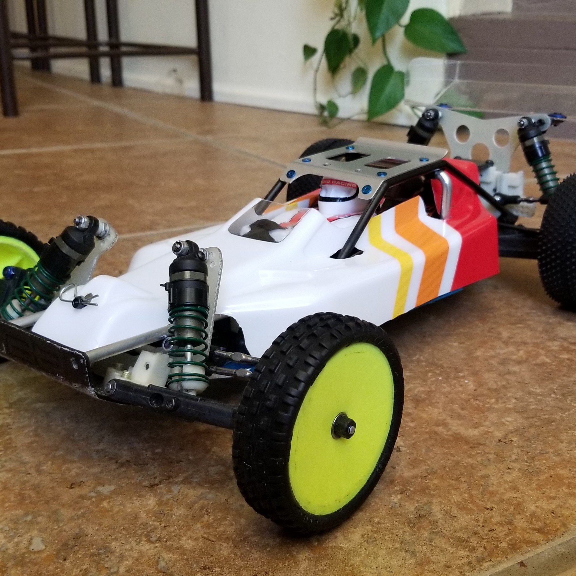

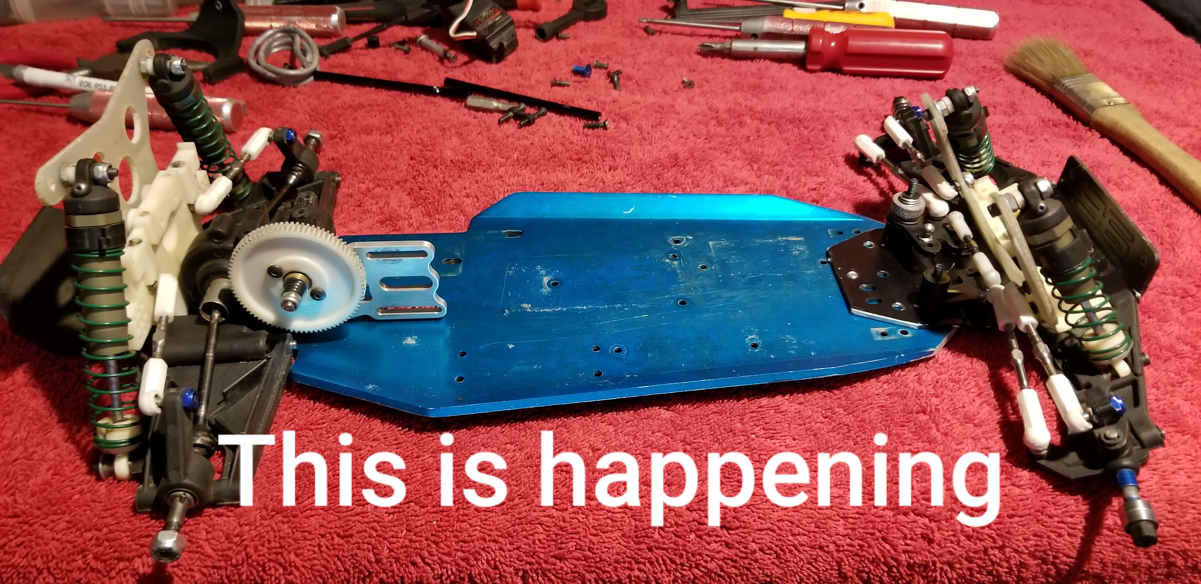

Finally got around to the RC10 Mid 2.0 with blue chassis instead of tub! Still waiting on the Kyosho Ultima rere.
Associated GT RTR chassis/trans
Associated RC10 Team Car suspension
Associated RC10 B6.1 battery holder
Kyosho ZX-5 lexan
Kyosho Turbo Scorpion roll cage
Kyosho Optima driver figure
Going to add B4 top shaft and fancy slipper, and diff rebuild.
Ironman Ivan Stewart paint

The close up of the rear tower is to show the way I mounted a section of the Kyosho roll cage so the the cage could clip on.
The RPM ball cup have been replaced with Dubro. I like how they mount with screws instead of ball cups.
The roll bar is stock Kyosho Turbo Scorpion.
It is easy to make nose tubes with aluminum stock.
I want to put a B4/5/6 fancy slipper on as well as a maintenance session on the diff before going out racing with it.
I might play around with the rear shock mounting to get a good lean back on the shock.
Paint needs to happen.

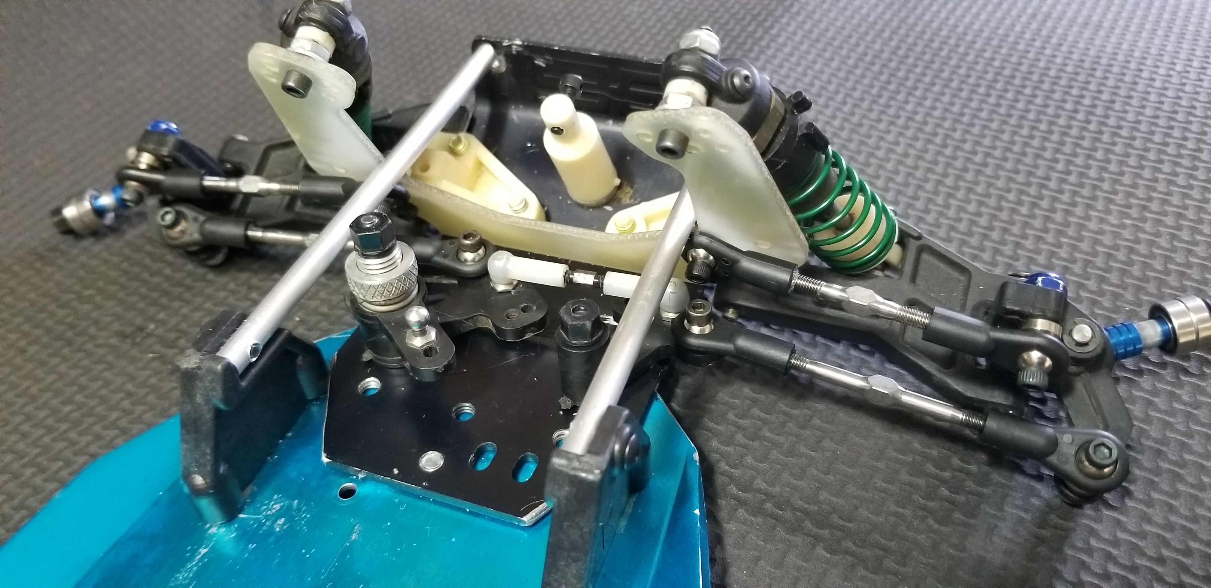

If you rotate the steering servo by 90 degrees, and Tuesday a shorter tie rod you can move the servo further forward to generate some space. I assume that is a low profile servo

Thanks,
I haven't decided how to mount the servo and the steering rack too.
It is low profile so I have more flexibility.
