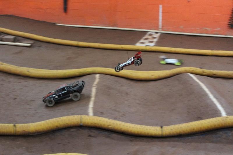

Heading back to the track today. We'll see how the new setup works.
32.5 / #1 / green: front
35 / #2 / blue: rear
The outer rear hinge pin is moved to the upper hole in the losi hubs now, too.
Posts: 16751
Has thanked: 33 times
Been thanked: 1216 times
Re: Another what's old is new build............

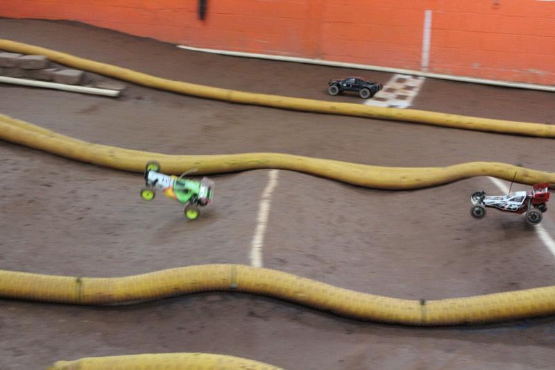

Glued up a set of Primes for my kid's Worlds car last night. Before they got dirty.....
So my kid's car seems to work pretty well. But, since it's the same setup that I ran in my Worlds car at the Vonats in September, i figured it would be decent.
My car....... it did not like the blue rear springs with the #2 pistons and 35wt oil. Off the jumps they would just throw the back of the car in the air. Ran a couple of laps and i knew it wasn't going to get any better :lol: , so went back to the pits and put on a pair of silvers on the back. That seemed to calm it down nicely. I think I'm going to try dropping the rear oil to 32.5wt and see how that goes for next time. But until then, here are some action shots.
Here one with Ed and his black car (tranasamman908).

Been thanked: 1170 times
Post by XLR8 »
If the jumps are tossing the back of the car, shouldn't you want to increase dampening? Going from 35wt to 32.5 might make it worse. If your're running the bottom shock mount in the arm's second hole, maybe try just moving it to the outside hole and try that. The risk is that, depending on available grip (track conditions, tire choice, etc.), making the back of the car stiffer can tend to loosen the car a bit and can even lead to over-steer in extreme cases.
