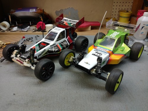

Glued up a set of Primes for my kid's Worlds car last night. Before they got dirty.....
So my kid's car seems to work pretty well. But, since it's the same setup that I ran in my Worlds car at the Vonats in September, i figured it would be decent.

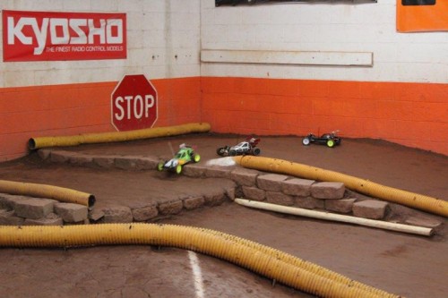

My car....... it did not like the blue rear springs with the #2 pistons and 35wt oil. Off the jumps they would just throw the back of the car in the air. Ran a couple of laps and i knew it wasn't going to get any better :lol: , so went back to the pits and put on a pair of silvers on the back. That seemed to calm it down nicely. I think I'm going to try dropping the rear oil to 32.5wt and see how that goes for next time. But until then, here are some action shots.
Here one with Ed and his black car (tranasamman908).

Nice, they look good sitting there together!

Of course the only promotion in your photos is Kyosho

And we must "stop" them. 8)

RC10th wrote: Mon Apr 16, 2018 6:30 am Of course the only promotion in your photos is Kyosho
He can’t deny his love and passion for Kyosho any longer now. I’m sure he actually secretly raced a Raider which would explain all the setting up hassle he’s reporting ;-)

Love those action shots. Very cool!

Great action pictures, and good info on shock setup progress :!:
