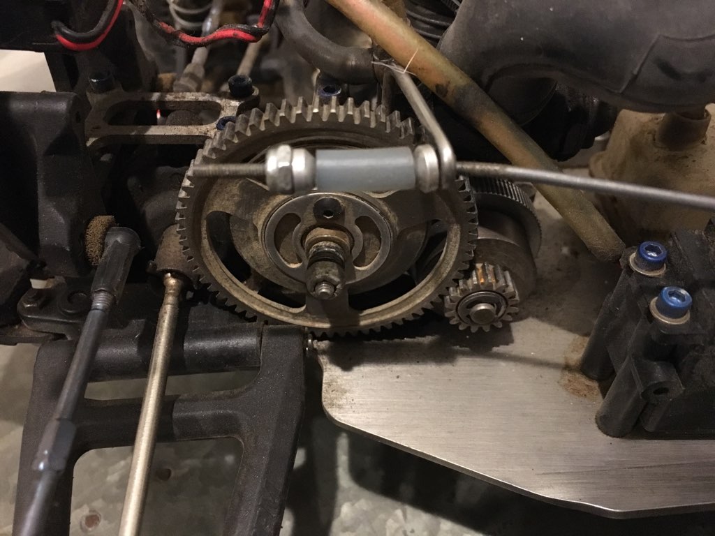

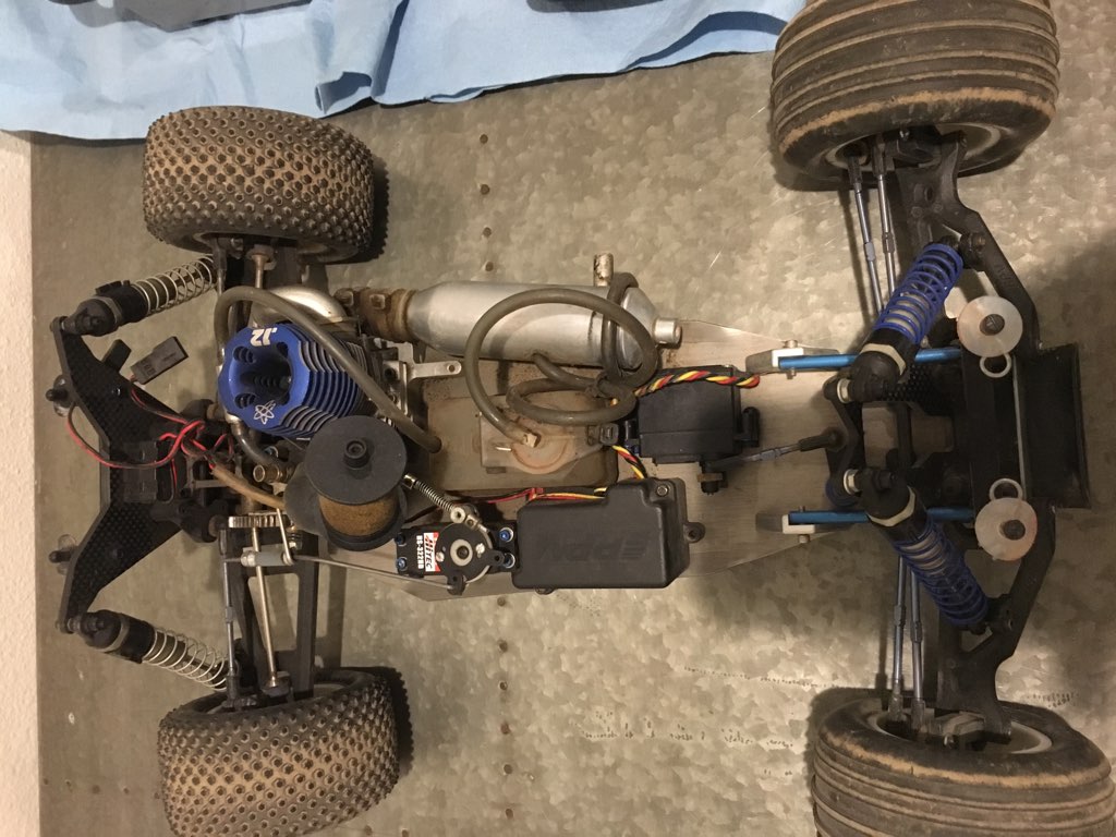

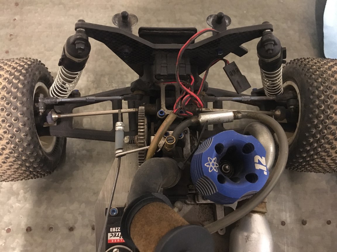

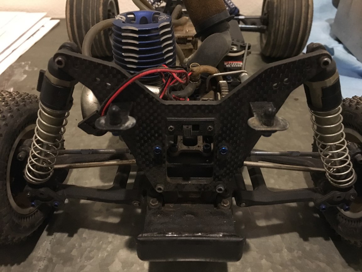

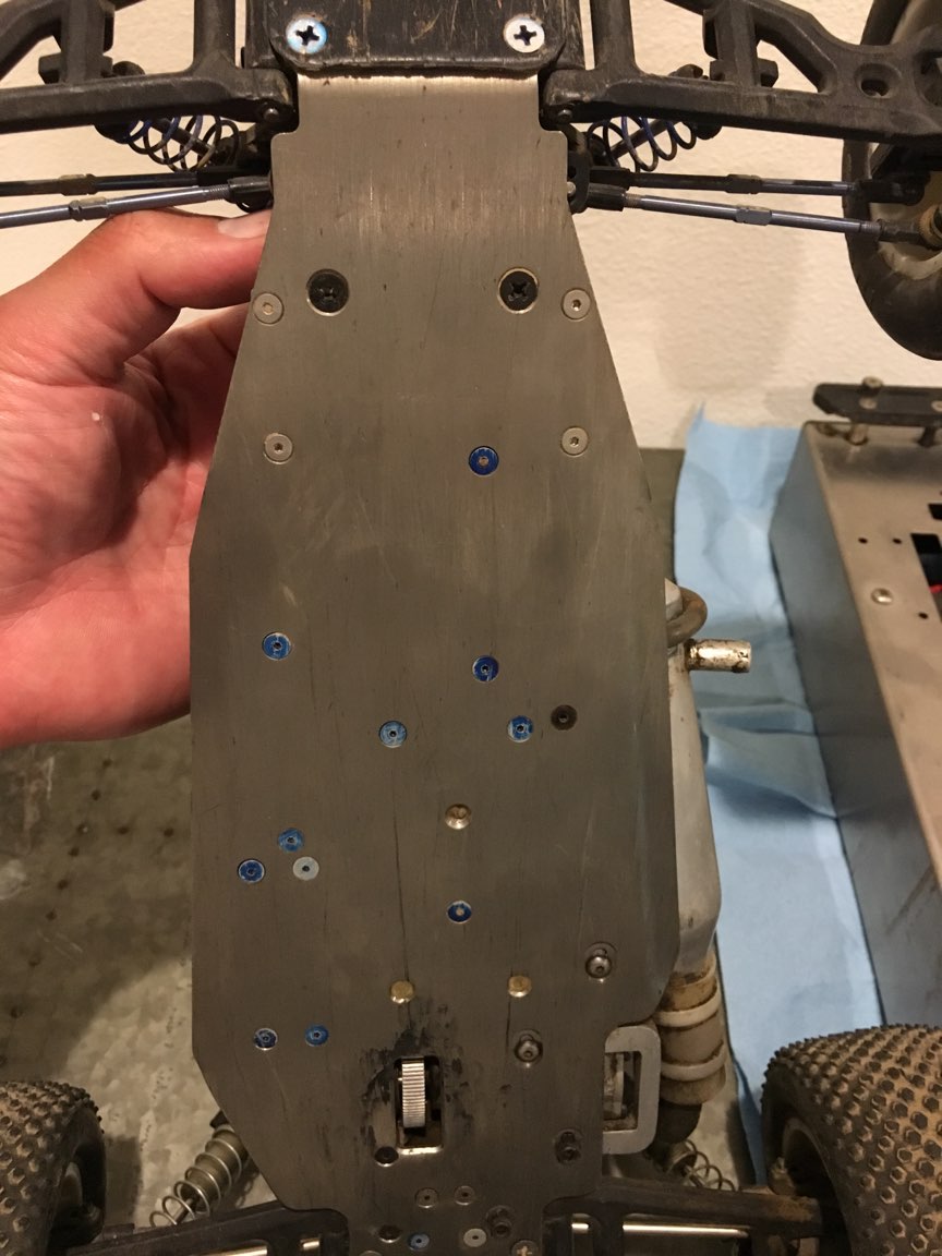

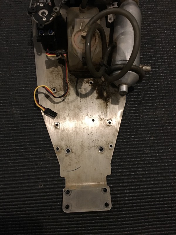

Pictures of what I am working with. From what I can tell, this was a FT RC10GT. I've read up on the tubbed chassis and the blue chassis. I am assuming this was a blue chassis that was sanded down?

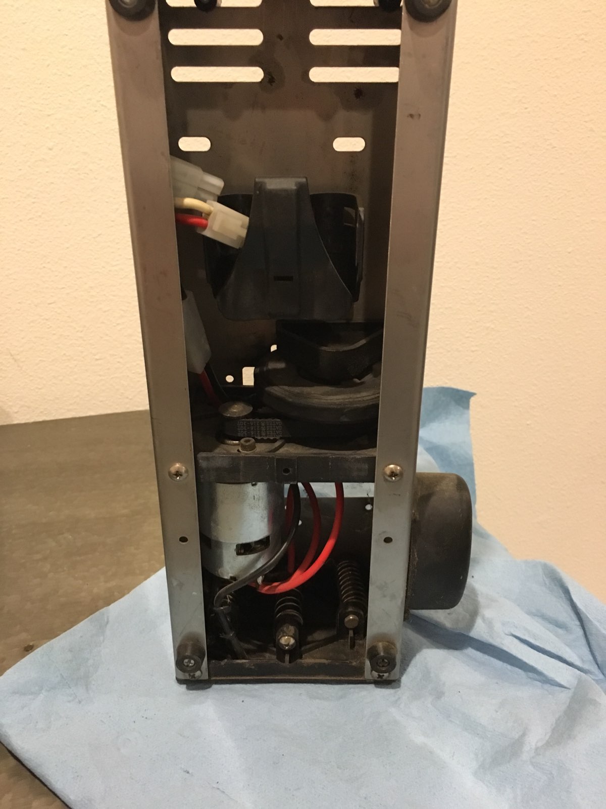

A NIP Proline Crowd Pleazer body and an AE starter box were included in the purchase.

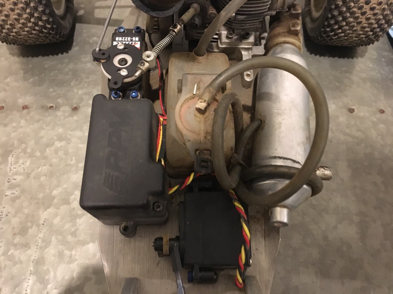

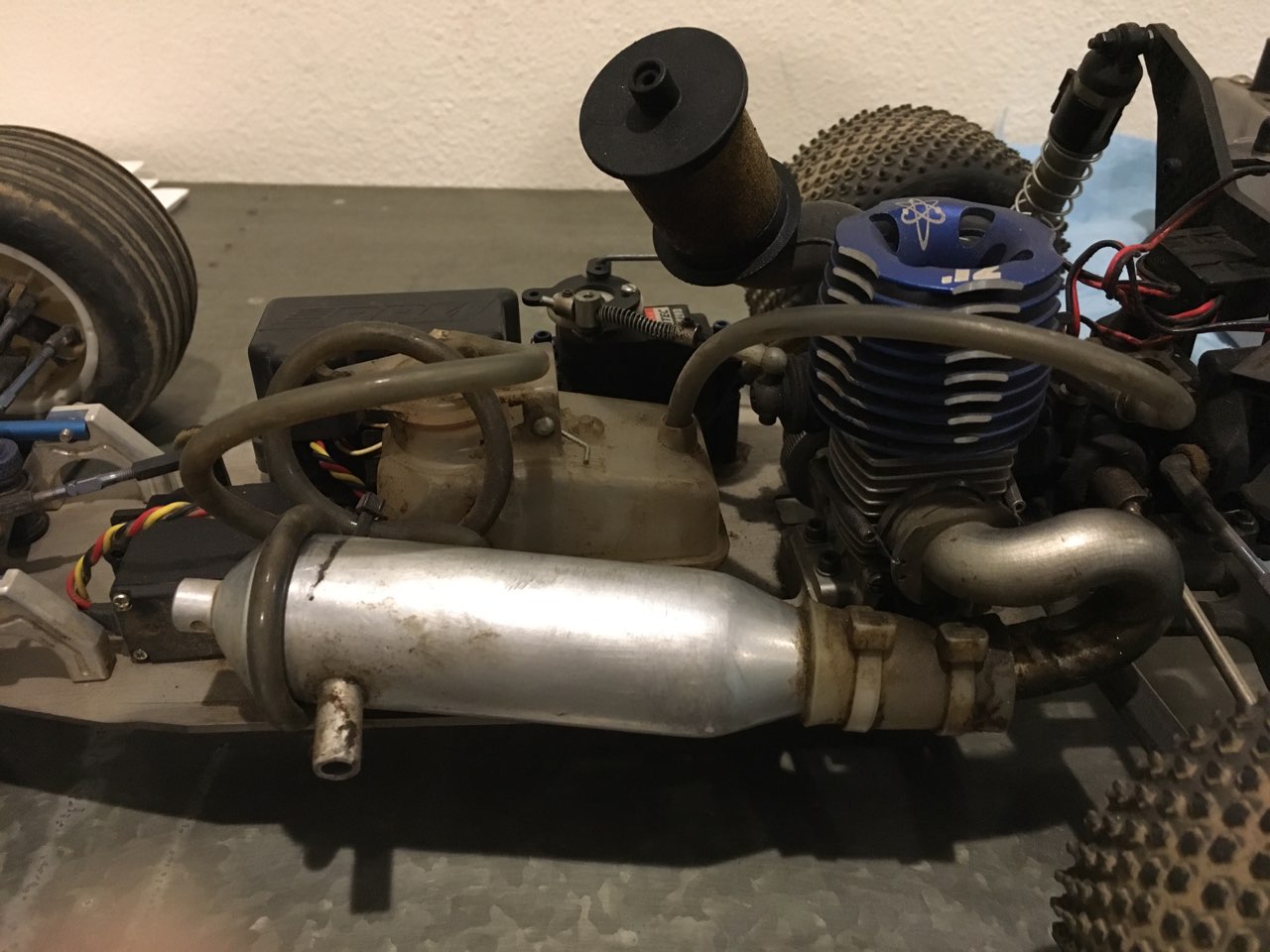

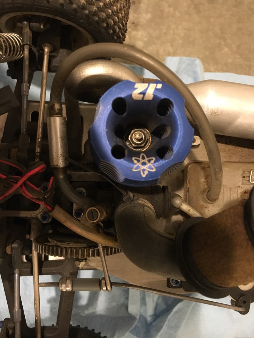

The goal of this build is to take everything apart and clean, rebuild and/or replace. I plan to use this to run up and down open streets. I have two Savox 1258 servos that I was planning on using for both the throttle and steering. My main concern is the motor. I have no knowledge of what I am working with besides surfing the internet. I know it is a Sirio .12 engine, but that's about it. I am pretty handy, so if I can take this engine apart to clean and rebuild, that would be great. Any information on where I should start would be appreciated.

Posts: 4761
Has thanked: 52 times
Been thanked: 1548 times
Re: My First Nitro... RC10GT Project
Post by RC10th »
That looks like a great base to start with, lots of good parts there. Should be a fun truck to tear around with.
I suspect that is a Hardcore Racing titanium chassis.
Does the engine turn over nicely by hand or is it gummy?

The motor seems to turn over pretty nice. Besides the normal dust and grime that the car caked on after sitting in someone’s garage for a very long time, everything seems to look in good shape. Thanks for the information on the chassis. I will look up more information on it.
8)
romulus22
Posts: 2549
Location: KY
Has thanked: 900 times
Been thanked: 789 times
Post by romulus22 »
I'm rusty on chassis makers but I believe rc10th is correct. I know for sure it's not an Associated chassis.
RC10th
Posts: 4761
Post by RC10th »
If it turns over nice and smooth without being notchy or sticky you likely don't need to rebuild it. Checking the rear bearing is always a good idea though.

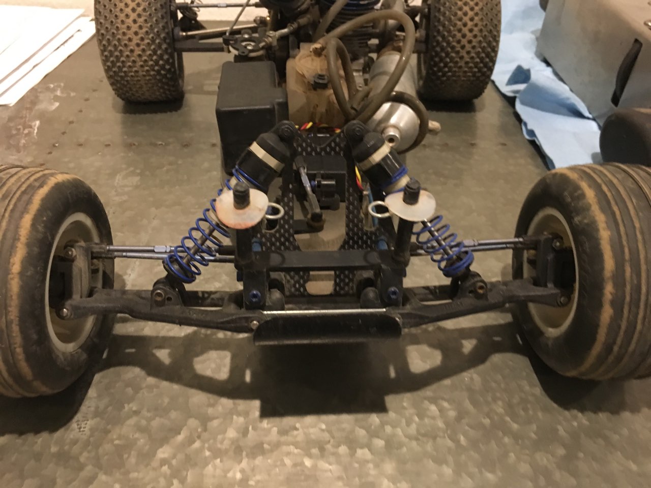

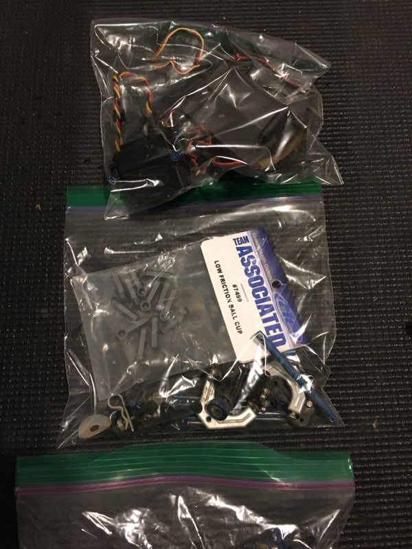

So I finally got a chance to put in some work on the project last night. I was able to take apart the entire front end and check all of the pieces. Besides the gunk, I am glad to say that everything was in great shape and I am hopeful that things will work like new after a little TLC :D Simple Green followed by a warm soapy wash should bring everything back to life. I purchased the shock rebuild kit along with new rod ends just as a refresher.

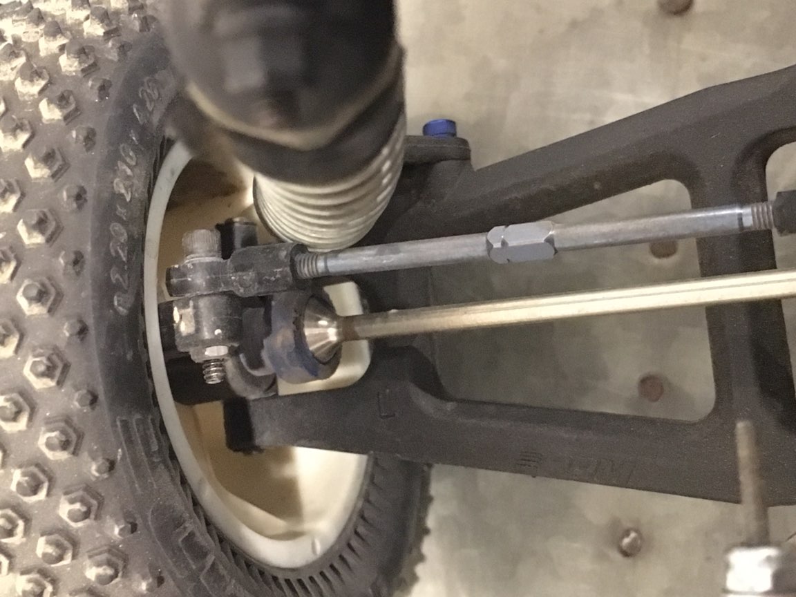

I had some questions regarding the front suspension:
1. I had some extra RC10T4 parts and after doing some internet searching, I saw that several people use the T4 caster blocks, front axles and steering blocks for a wider stance. It seems like everything fits together nicely except for the hinge pins that come with the GT. These seem a little wider than what the T4 uses. What are people doing to make these fit?... drilling wider holes in the steering and caster blocks?... using T4 pins??? Any info would be appreciated.
2. What has been the experience with people that have made this conversion? Does the truck perform better or is it just the cool factor with the wider stance? 8)
3. Any other upgrades that can be done to the GT using T4 parts? I ask because I have several parts available.

Posts: 4761
Post by RC10th »
Personally I wouldn't do the whole T4 thing unless you were converting to run hex wheels. The stock parts are more than good enough, and stronger if anything. If you still want to use the T4 parts you'll need to drill out the hinge pin hole with a 1/8" drill bit.
Not much else transfers over from the T4. Just the ball diff, top shaft, slipper, stub axles, shocks, bearings, ball studs/cups

So I finally made some headway this weekend with the tear down and build up. I was very happy to see that all pieces were in great shape, but in desperate need of a detail cleaning (what a mess nitro, dirt and sitting for a few years causes :shock: ). After cleaning all of the plastics, I turned to polishing the tie rods, hinge pins and servo saver screws before installing new ball cups. I also was able to rebuild the shocks and installed a new set of springs. Just because I had the extra parts, I converted the truck to the T4 caster, trailing arm and axle. Going to see how this works as I can always resort back to the stock parts. No issues going into the GT parts after I drilled out the hinge pin holes with the recommended 1/8th bit.
