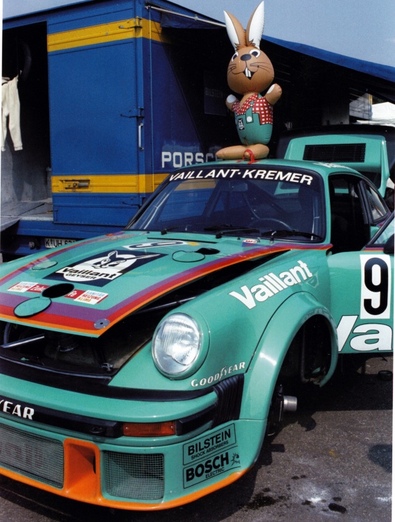

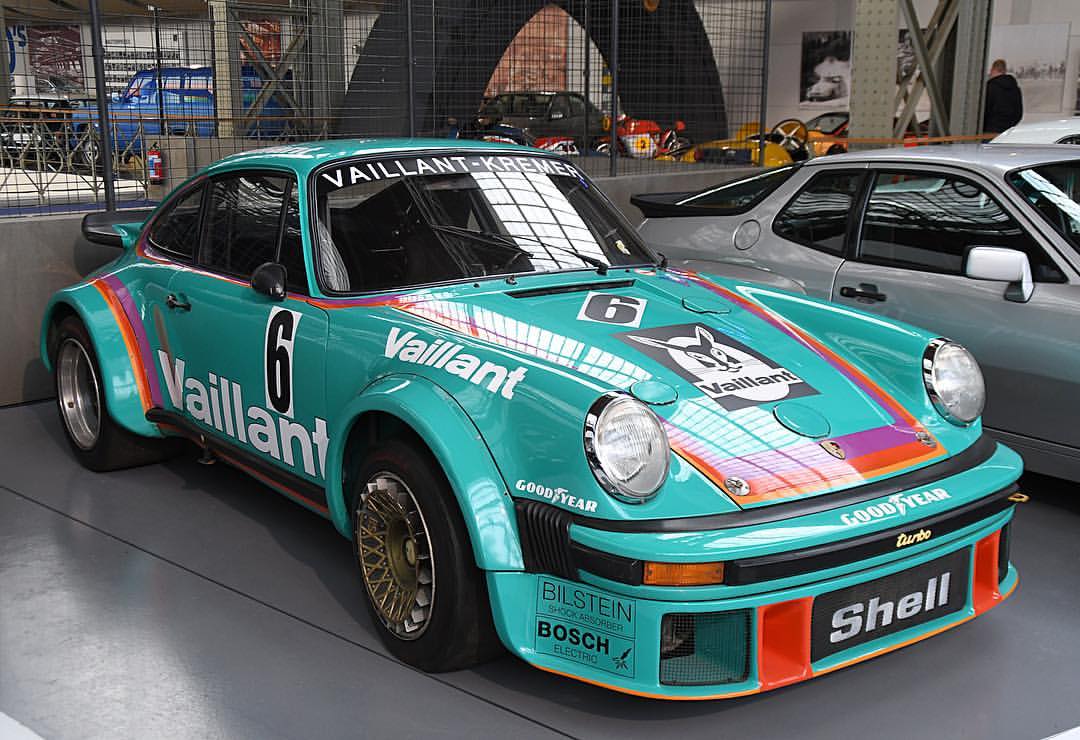

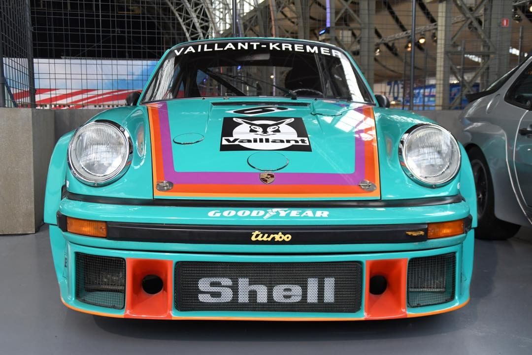

The Vaillant-Kremer version of the 934 is extremely iconic for several reasons: it was Tamiya's first ever rc kit, there is a real example in a car museum near my office (see pictures below) that I will try to mimic up to the very last details, and last but not least the car curves and the Vaillant-Kremer are simply super sexy!
Here are some pictures from the car that is at the Autoworld museum in Brussels, Belgium, and that will be used a reference (note that the tires are Yokohama and should be Goodyear as it was the official sponsor of the Vaillant-Kremer team:

And here is a collection of historic pictures. Two of them are showing the French racing legend Bob Wollek aka "Brilliant Bob" who was killed on 16 March 2001 at age 57 in a road accident in Florida while riding a bicycle back to his accommodation after the day's practice sessions for the following day's race, the 12 Hours of Sebring.
Here are all of his race results: http://www.racingsportscars.com/driver/results/Bob-Wollek-F.html?page=2

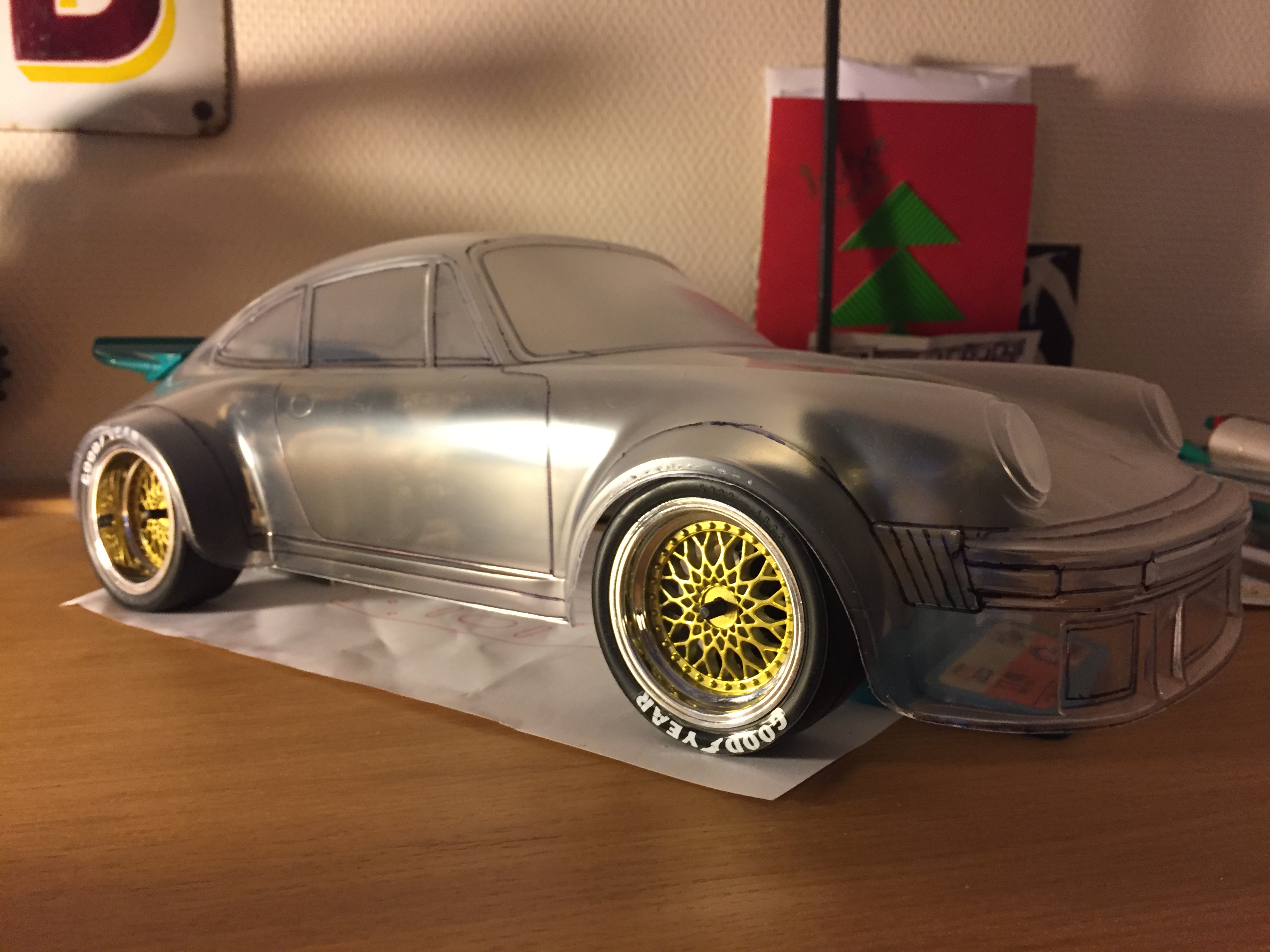

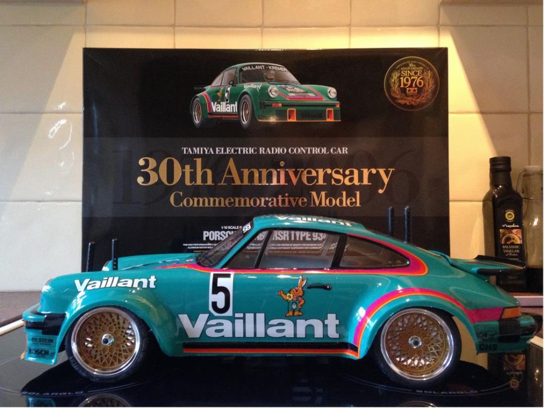

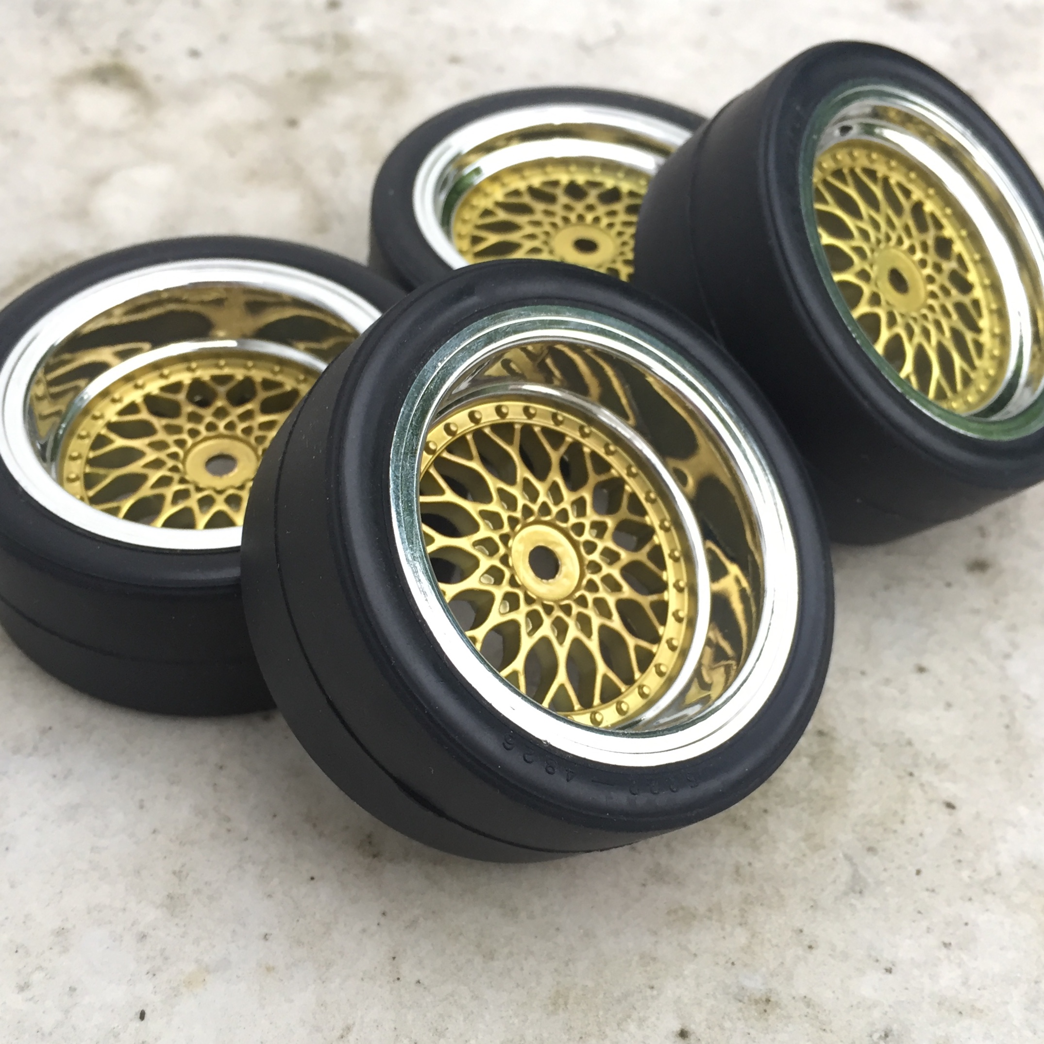

When looking to obtain a Tamiya Porsche 934 RSR with a Vaillant-Kremer livery, I quickly realised I had basically two options: buy a complete Tamiya 30th anniversary kit which value is insane for what it is, or look for a vintage 1/12 Tamiya kit which again is totally insane in terms of value.
None of these options were working for me, especially considering the fact that the Tamiya 30th anniversary kit doesn't even have the correct wheelbase: the chassis is actually a tad too long for the body and the wheel wells can never be centered properly (see pictures below). I also read that the wheels were of a very poor design. To top it off, the Tamiya kit wheels do not have a larger offset on the rear, all of them being the same. But one of the distinctive aspect of the 934 is a deeper offset in the back wheels... That was enough for me to look for another alternative which eventually turned into buying a spare Tamiya body with green wing, light buckets and decal sheet and a bundle of proper BBS wheels with a 3mm front offset and 6mm rear offset. They also look and feel much stronger than the Tamiya wheels other than looking more real too.

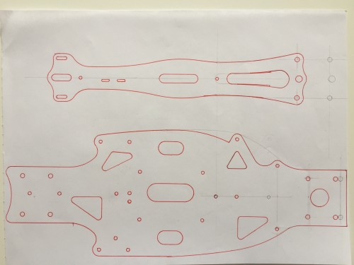

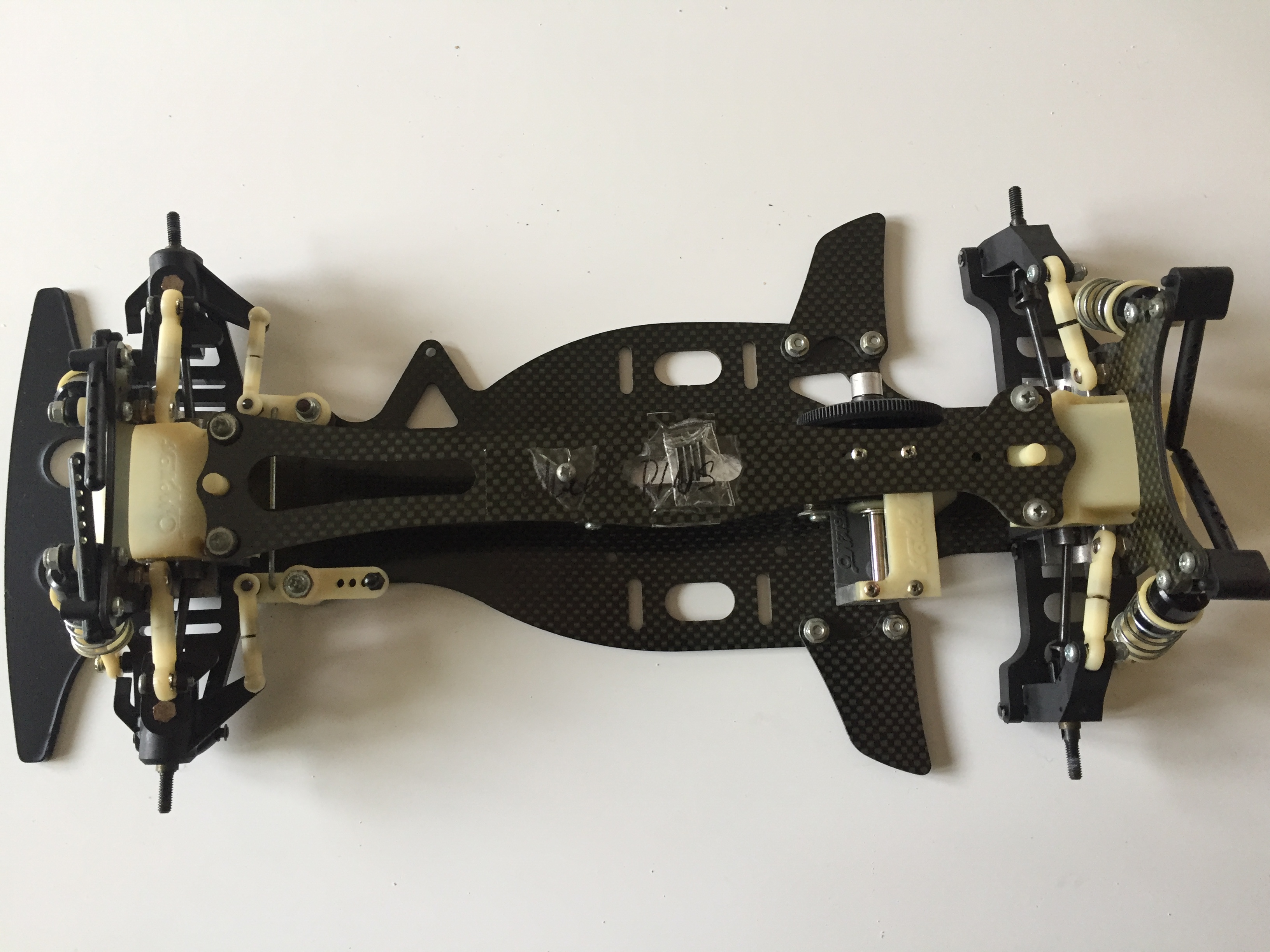

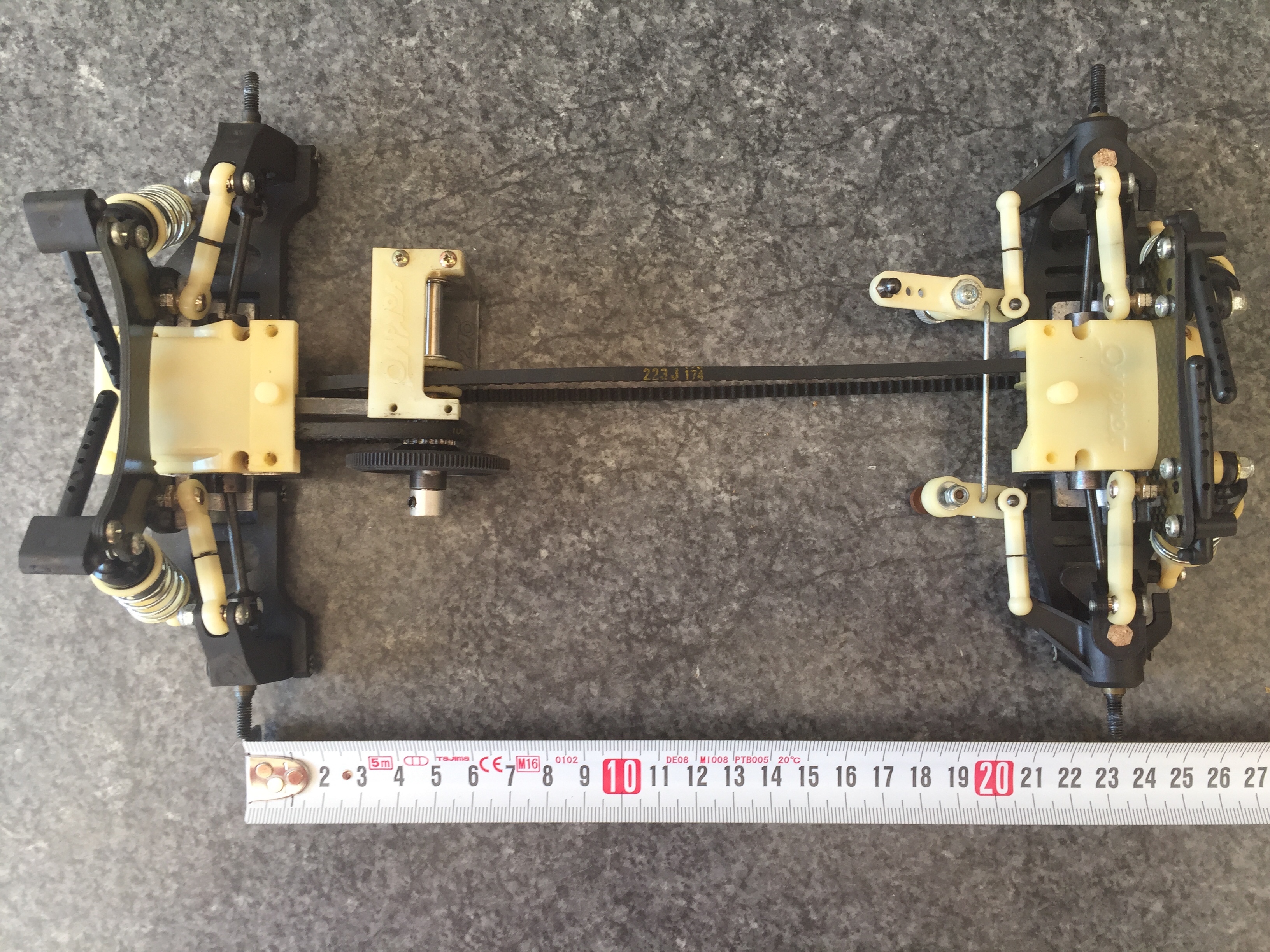

The only thing left was to find a cheap vintage chassis that would have a rear or at least a mid motor, be 2wd and a 230mm wheelbase.
Of course I could have gone the easy way and buy a TA02SW chassis like this one: https://www.ebay.com/itm/Tamiya-84431-1-10-Porsche-934-Jagermeister-TA02SW-4WD-On-Road/292521405905?epid=1787790806&hash=item441ba26dd1:g:To0AAOSwxTdaz4u4 but I never liked the Tamiya plastic chassies.
Of course no existing car was fitting my bill, so I decided to buy a cheap Yokomo YR4, make it 2wd and design my own chassis. An initial design is already born but needs to be refined. Once ready I'll send it to Jeff so that he can cut it out of carbon!

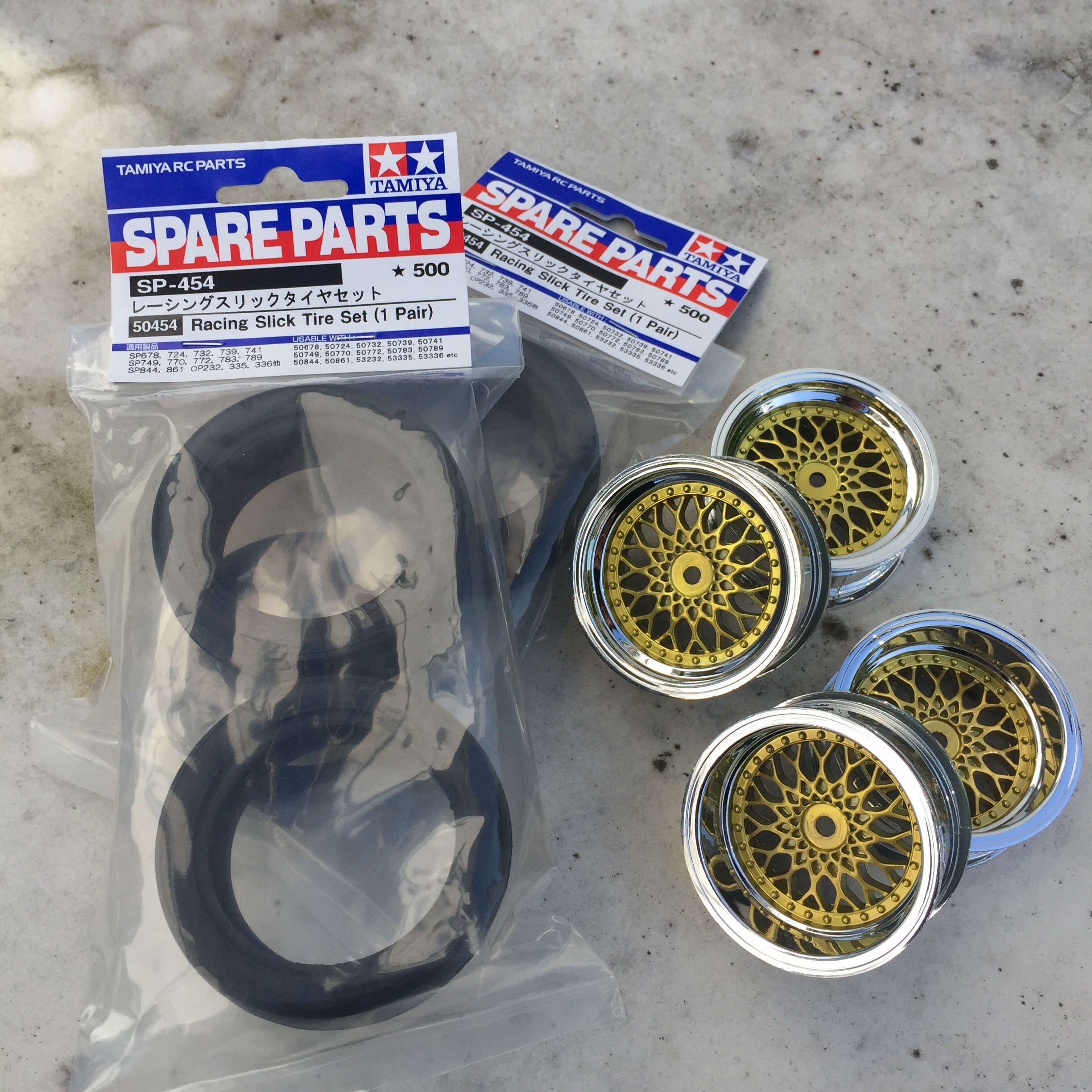

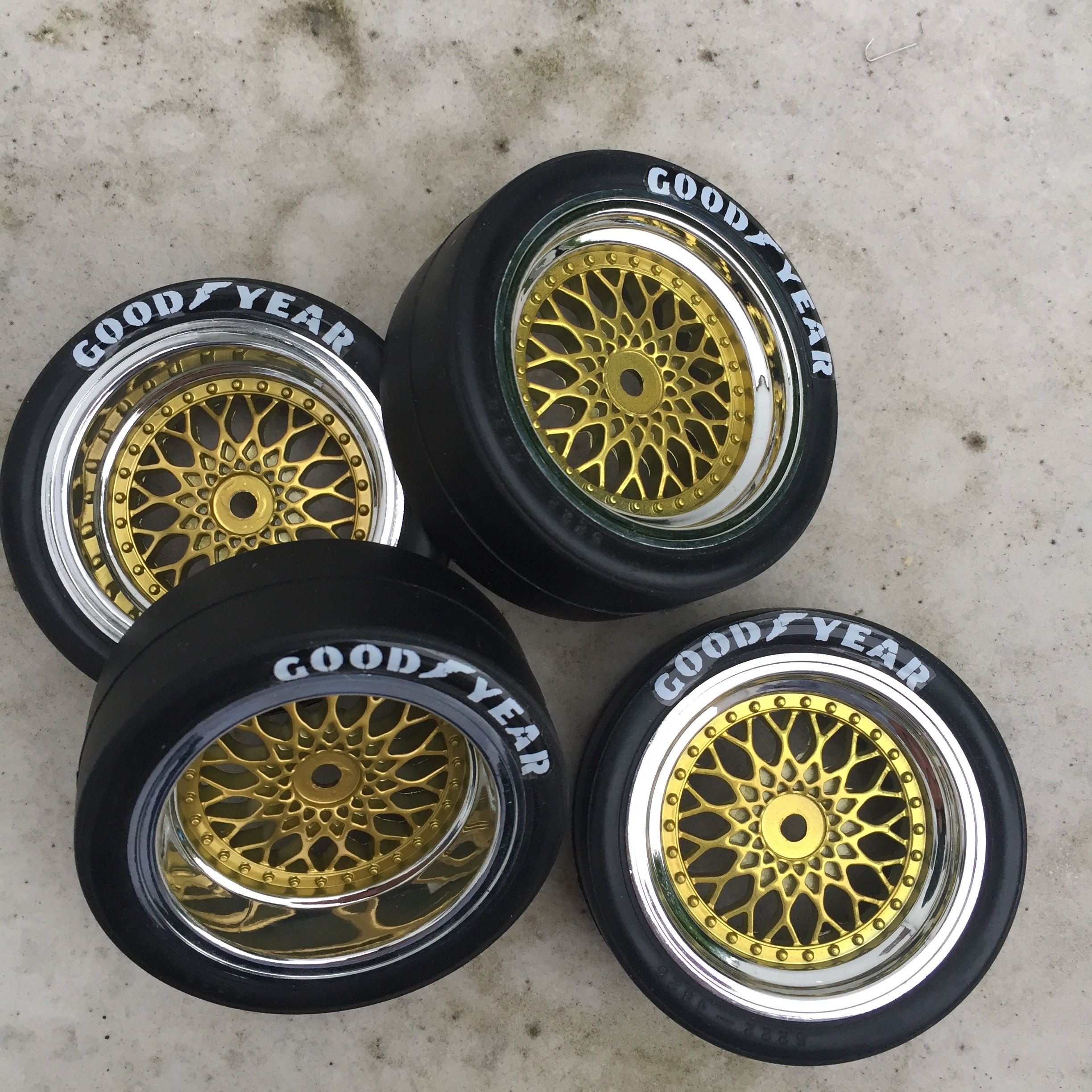

Here are the wheels with the 3 and 6mm offset. They already received Tamiya slick tires and foam inserts, and extra Goodyear decals!

Asso_man! wrote: Mon May 14, 2018 10:18 am Here are the wheels with the 3 and 6mm offset. They already received Tamiya slick tires and foam inserts, and extra Goodyear decals!
Who makes these gorgeous wheels btw?
Asso_man!
Posts: 3960
Location: EU
Has thanked: 40 times
Been thanked: 82 times
Re: - YR-4 Special with Porsche 934 RSR Vaillant-Kremer body -
Post by Asso_man! »
Lonestar wrote: Mon May 14, 2018 10:24 am Who makes these gorgeous wheels btw?
Hey Paul, they're available from China on eBay. Very cheap, free (but slooooow) shipping. The good thing is that they're available in 3, 6 or 9mm offset! https://www.ebay.com/itm/4pcs-1-10-Touring-Drift-Nylon-Wheel-Rim-Y12CG-3-6-9mm-Offset-1-10-Wheel-10043-/182665000972?var=&hash=item70f9366c25

The chassis design needs to be refined, I would like to add a tab on the top deck to attach a Tamiya driver figure, and provide more room on the chassis for the electronics.

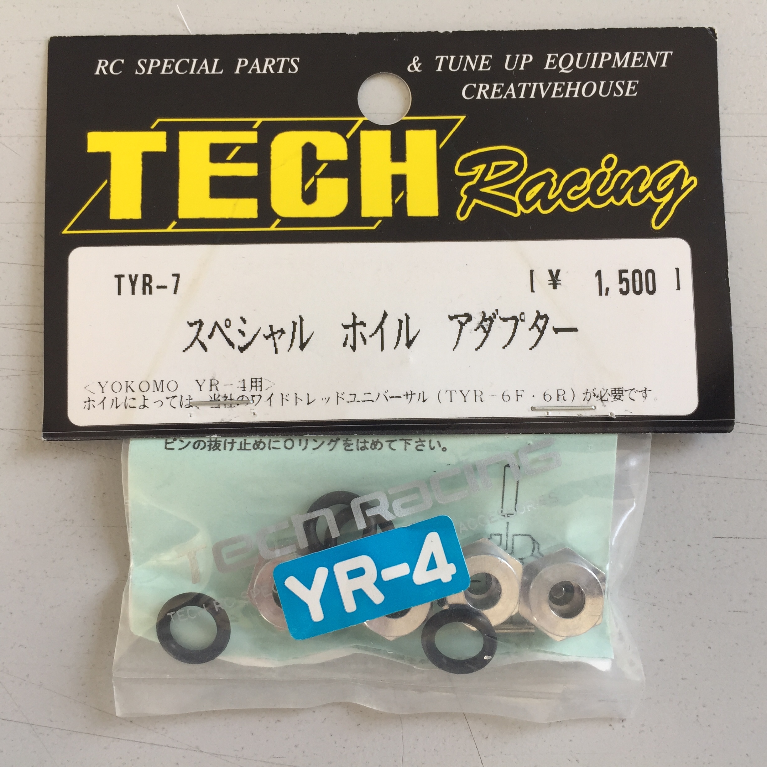

Small step forward today as I received the hex wheel mounts!
