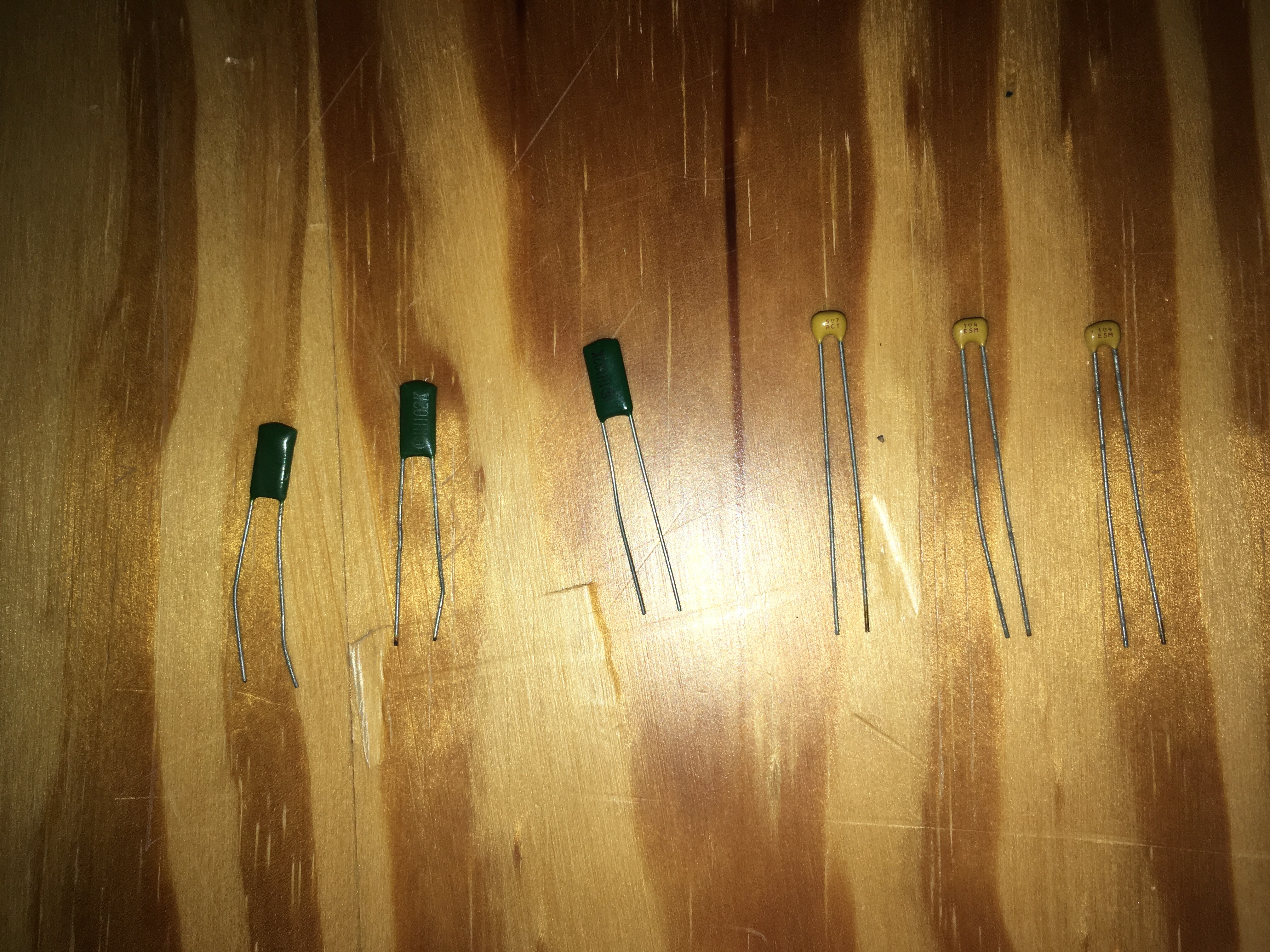

Will either of these work? The yellow say 508 act while the green say 1h102k

Yup either set of caps will be fine. The greens ones are a little light in value (102) is only 1000picofarads. Not sure about the others the values aren't present but judging by size they are within the right range.

Thank you so much. I’ve been wanting to use that motor ever since I got it but I didn’t know about capacitors. Huge help.
