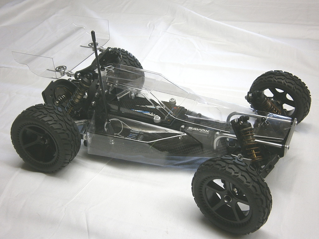

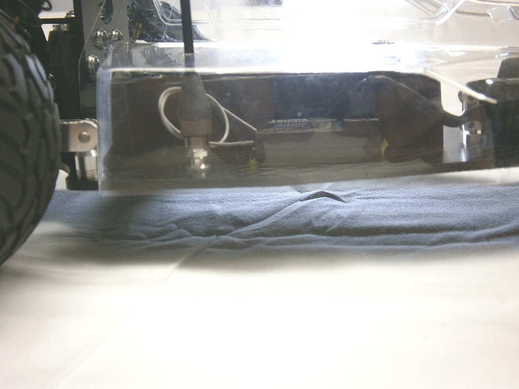

The body and wing are very close to being done with only some minor touch ups left to do. I was able to get the body low enough on the chassis to trim it level with the bottom of the chassis plate.

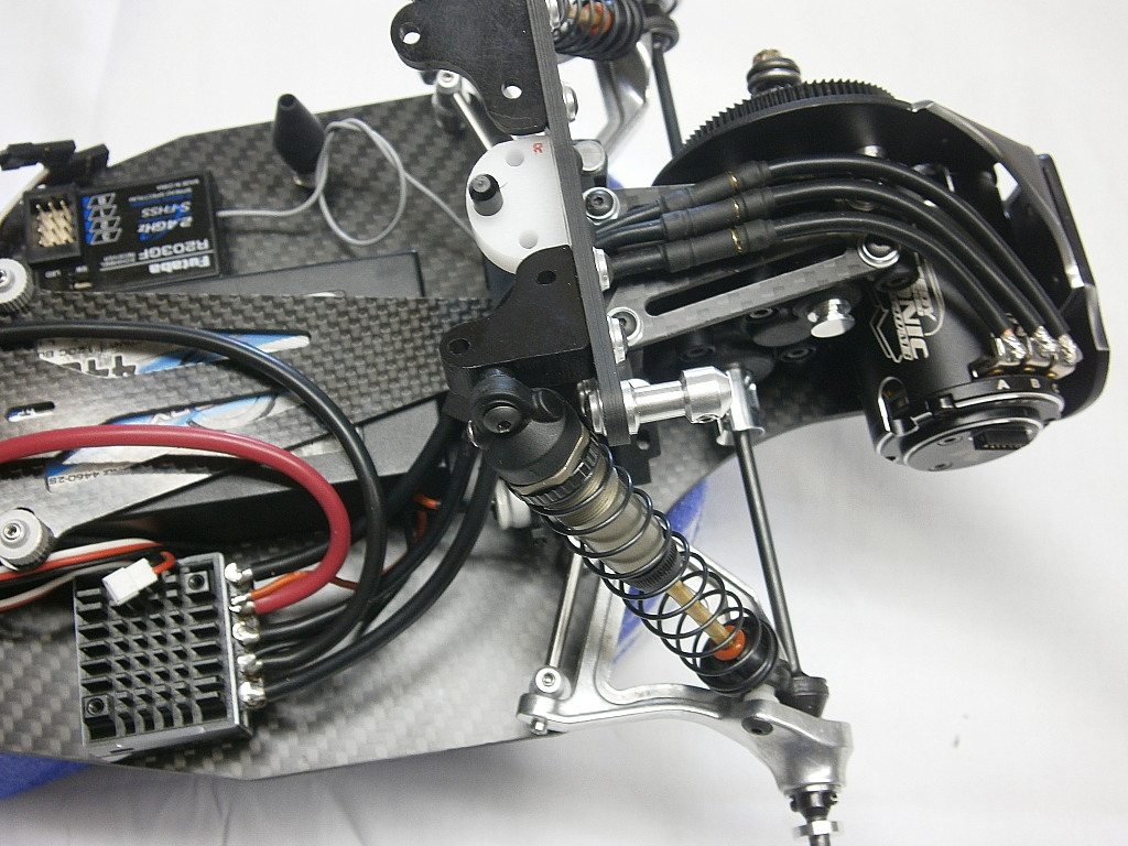

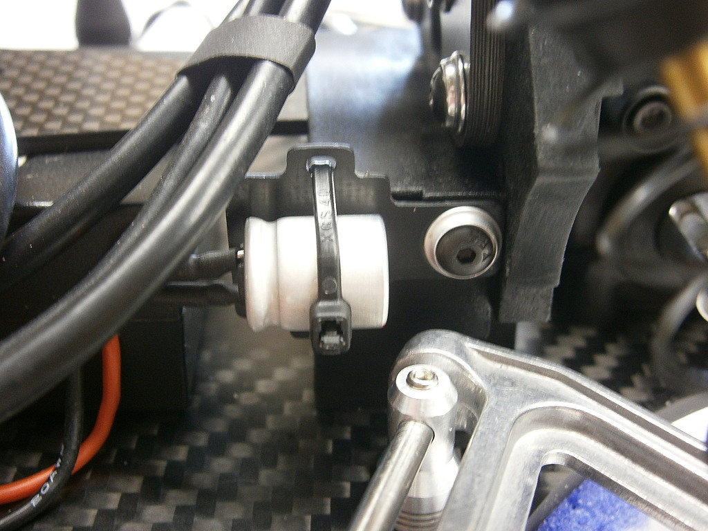

I got some wiring done last night/this morning. The small plate I was working on turned into an ESC capacitor mount. Slick?, yes, really needed?, no but I do things like that all the time.
ESC to motor wiring with 2.5mm gold plated bullets. I'm seeing a little gold showing so my shrink wrap needs to be re-done. :?

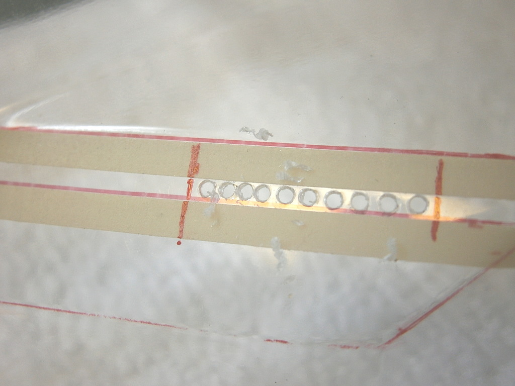

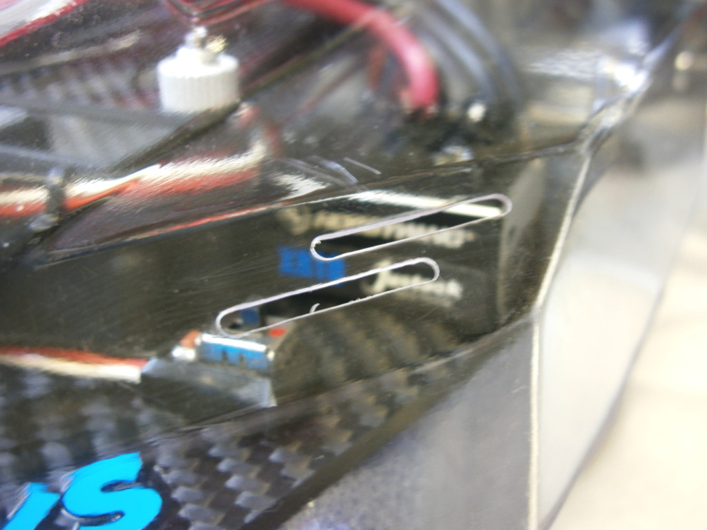

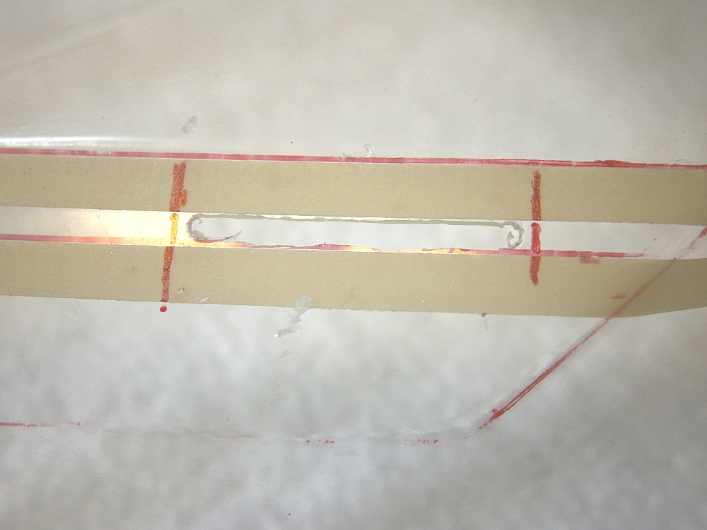

If I install the fan on the ESC it doesn't clear the body. To help with cooling, I cut a couple of vent slots in the body.
Mark out for position and drill holes...
With an x-acto knife, do some cutting...
After some work with a diamond coated file, they look pretty good.
I'm getting close to being ready to get into some painting. 8)
