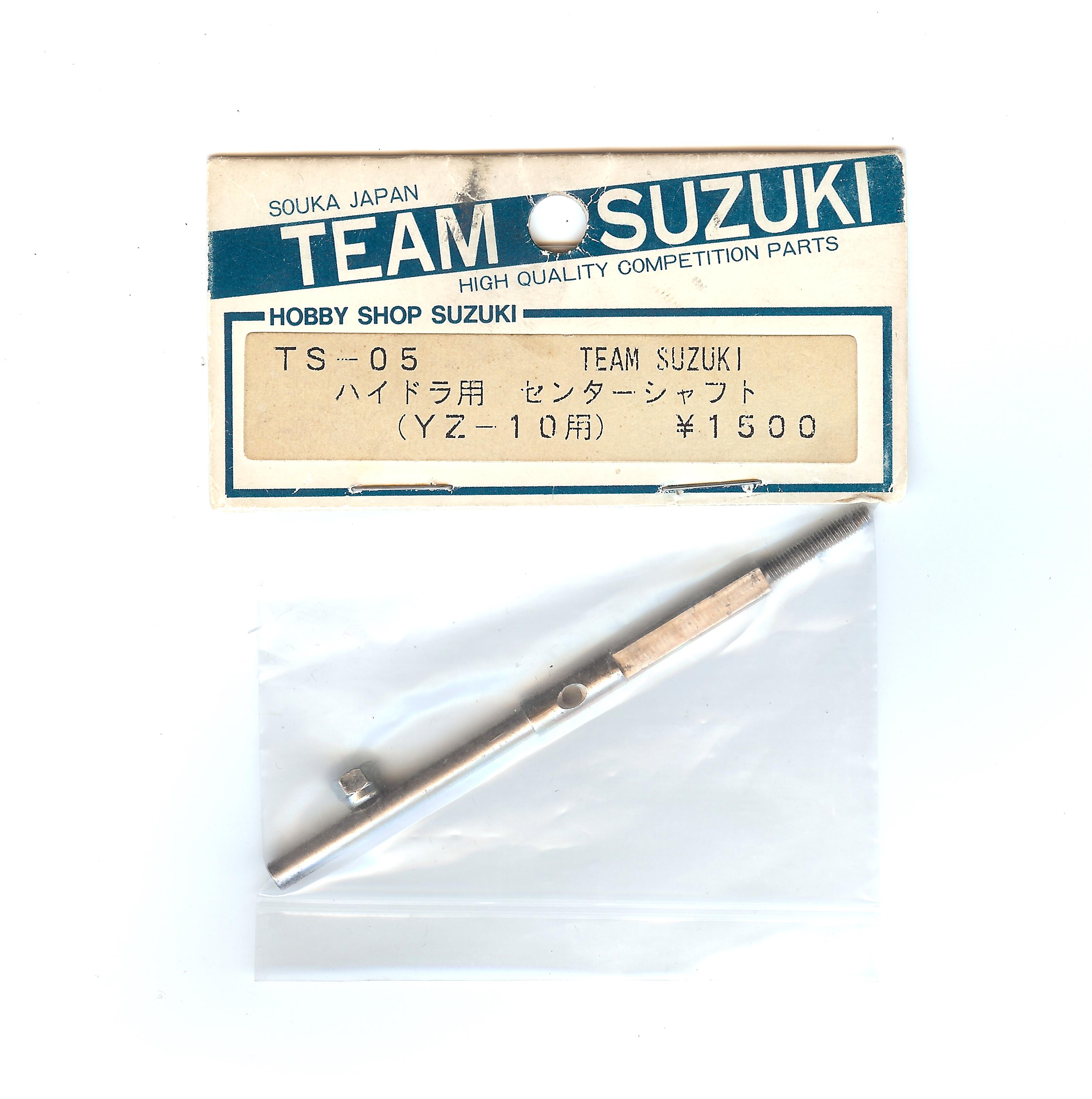

it is assumed that we do not have the TCS available to incorporate a customized slipper, i think the only way for this is to create a new customized lay shaft which i think Jake can manufacture ( its not that im implying jake :lol: ) .
but would this Layshaft for Hydra do the job for us?

slow_jun wrote: Tue Mar 22, 2011 12:53 am Hi Alex,
I would love to have this shaft copied for all to use for dual disk slipper from Losi or the B4

I made a very similar top shaft for jkracing's pro radiant. If there is interest I could probably make a handful. I'd have to mock it up and check it out. What do you use for the rear drive pulley with that shaft?

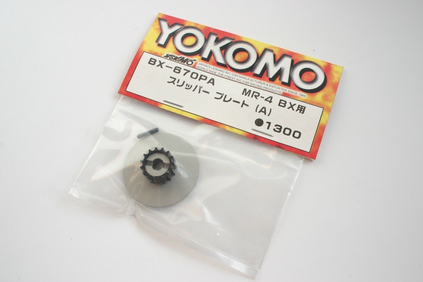

A stock slipper TCS plate. This one is 2mm. Even the MR4Bx plate will work.

aip47-2008 wrote: Wed Aug 22, 2018 10:48 pm A stock slipper TCS plate. This one is 2mm. Even the MR4Bx plate will work.Picture 100.jpgBX 670PA.jpg
Apparently the ID of the BX plate is 4.75mm where as the yoke one is 5mm I’ve not tried one yet but if I can get som emigrated be having a shaft made to utilise that plate

Peakey wrote: Sat Aug 25, 2018 4:00 am
Just ream the part to 5mm. What I would do. :wink:
