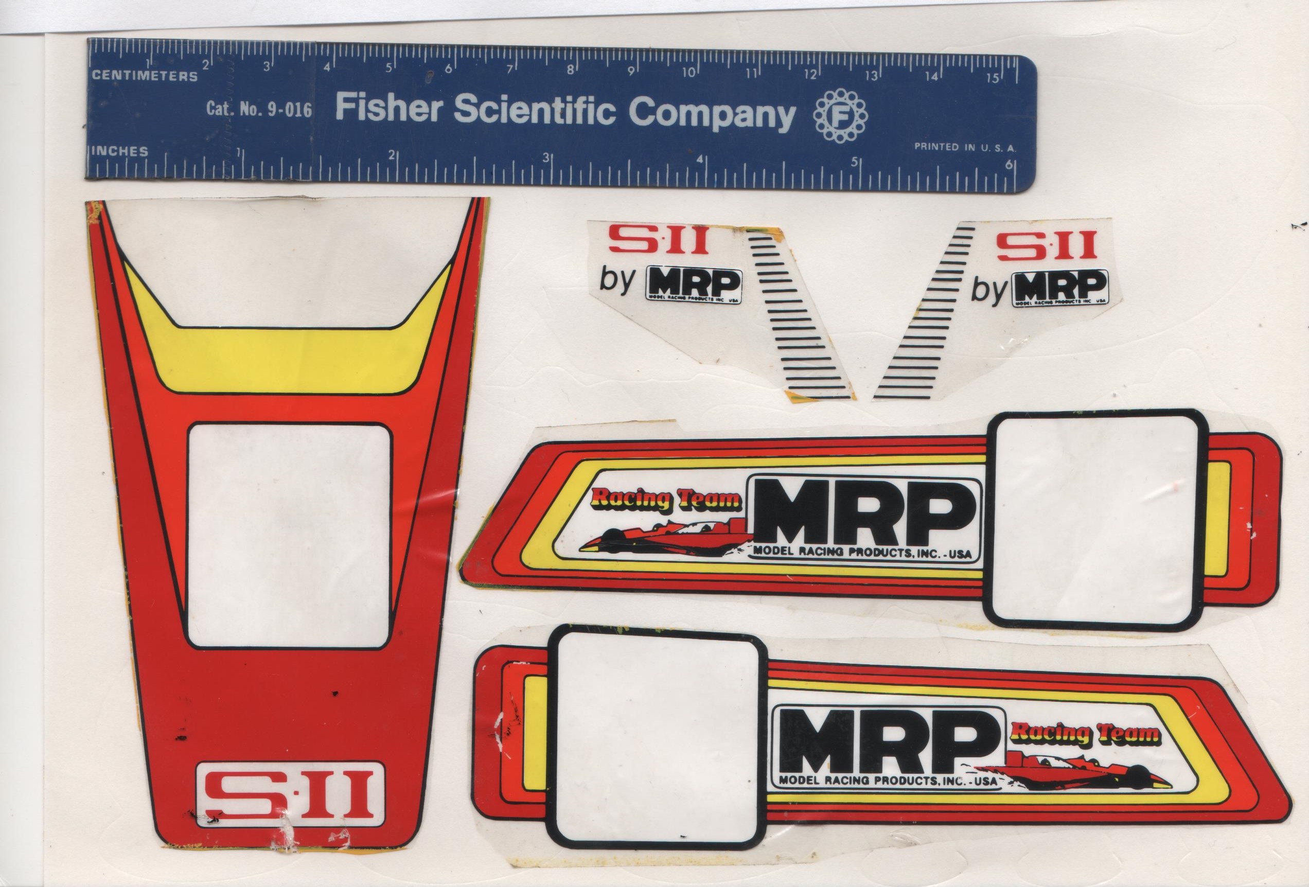

Some progress: great tip on heating the stickers! I got all the original stickers removed in tact and I trimmed up the edges as best as I trusted myself to do. Now, what to do with the body. I need to determine the best method for removing the old paint, or do I just paint over it on the outside, or just see if I could send it to TBG for reproduction? In-decisions...

Nice work saving those stickers! I don't know what to suggest for the body other than don't paint over top. It won't look that great, you'll have a semi-gloss finish instead of a glossy look. I also hesitate to suggest ways of removing the paint, because if it was painted with something like Pactra, that stuff bonds to the Lexan and can be extremely difficult to remove. I've tried various things to remove paint from a test body I got from someone, even using nitro fuel, DOT 3 brake fluid and much more...it ended up hazing the Lexan. If you're trying to save that body, don't go this route. Sending it to TBG might be a good idea.

I may need to try contacting TBG. But it shouldn't matter to them if the lexan is hazed or not, right?? I suppose I might as well try removing the paint. :?

True, as long as the Lexan is intact, I suppose TBG could use it to pull clone bodies...but I don't know what their requirements are; i.e. if the body has holes drilled or cut, or if the body was already cut along the trim lines...you'd have to get in touch with TBG.
