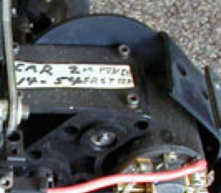

Has anyone figured out what the writing on the trans brace masking tape?
Here's a guess:
CAR 2 ?? ????
14-54 FAST ??
There are better pictures on the the web, but photo's from that period are never that great. The numbers would be the pinion and spur

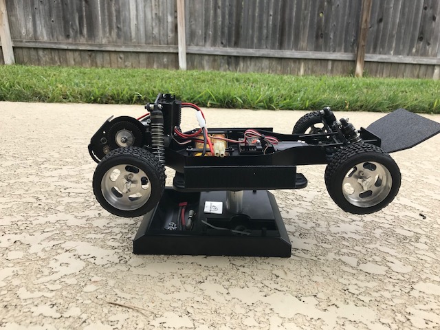

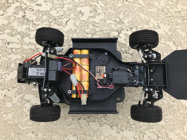

Making some headway on the Dead Pool RC10 Replica. Some parts are place holders - Example: Chassis, Battery, Tires, Shocks, etc... Plastic bumper and side mount parts not secured yet. Need dimensions from the body.
Turning out to be allot of fun. I found the wheels in an old stash, made my day.
-limestang

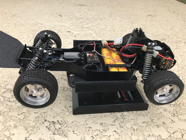

A few more critical parts arrived last week
Limestang
