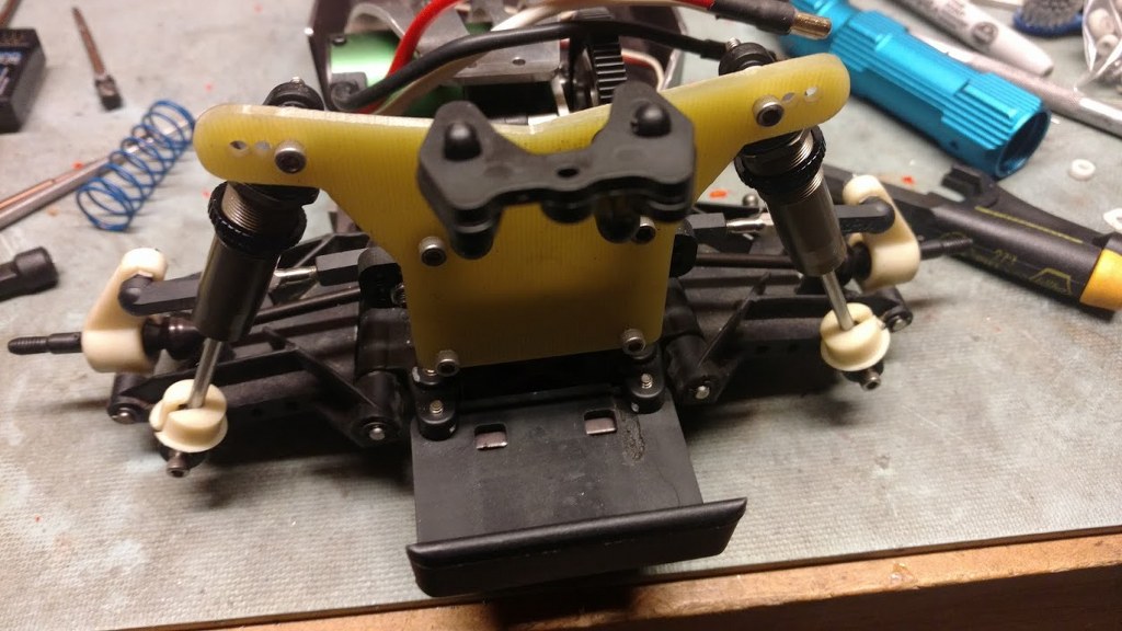

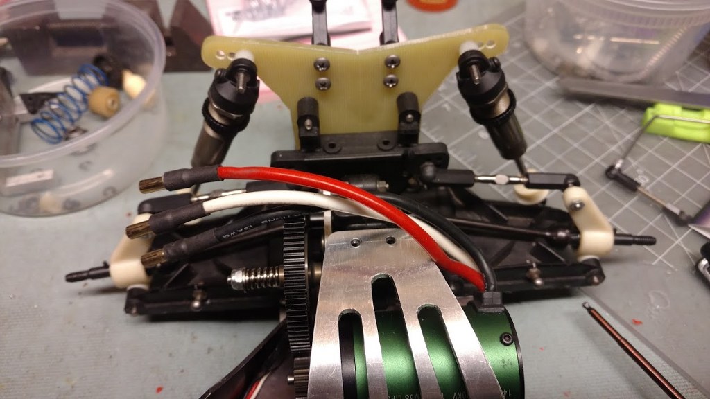

Finally made some baby steps. Built up shocks and adjusted internal limiters. Added front sway bar. Trying to attach from my phone but may be too large. If so I'll add tomorrow am.

yeah, wasn't so bad. Still, need to add oil and bleed.......I've got to trim my rear tower a little as the shock caps crash into the lower section. Also need to remove my custom long length shock bushings. They are threaded and take up the length the nut normally does behind a stock bushing. In this case, I want the shock to lean back a little more so a stock bushing with a ball profile will be much better.

Re: e-GT buggy build
I also think I have selected a body that will fit. The gt chassis kicks out pretty quickly behind the front tower, so i have to pick a body that flares or is a little wide. I have a jammin jumper body that looks like it will fit. I was going with a viper, but like most bodies it has an ear feature around the shock tower that will look stupid with the tower being in the rear. The viper does, the protech does, even a b3 body does. The jumper is straight through. The detonator world's does the same thing but it's narrow behind the front tower so it's not as good a fit.
yep. they are custom machined from some threaded standoffs I have. they are nice natural nylon and the exact length(I think 3/8") so I thread them on a spud, and turn a step to match the shock cap ID. I really should make a form tool to cut more of a ball shape; as it is, I leave them slightly loose by a couple thou to allow for some misalignment. looks nice and clean without the extra nut on the back. I'll take a better pic, but I may also have taken a pic before in my woin build.

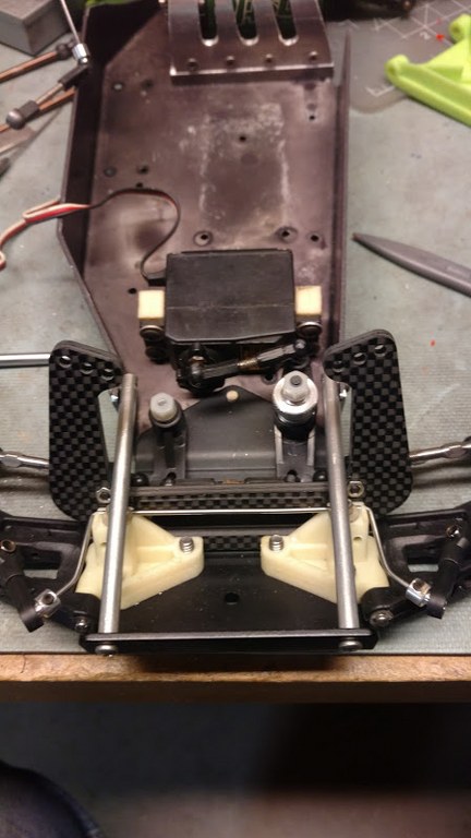

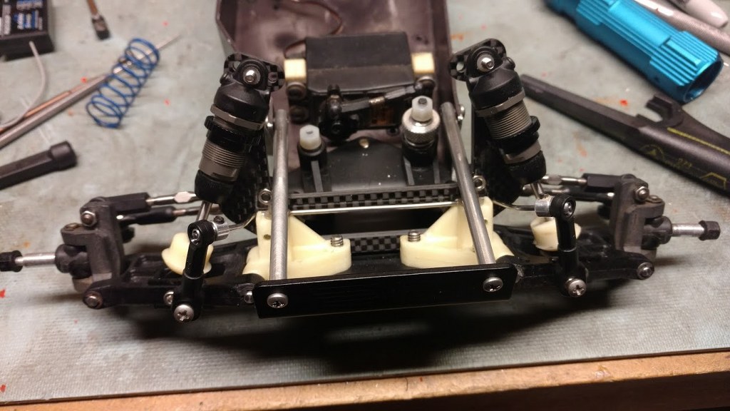

Oh yeah, made the nose brace tubes too....couple pairs as the older boy's car needed a set also.
and I double stacked the front tower(s), I think they are rc carbon works or something, but they are kinda thin. So two are more 'Joe-proof'
