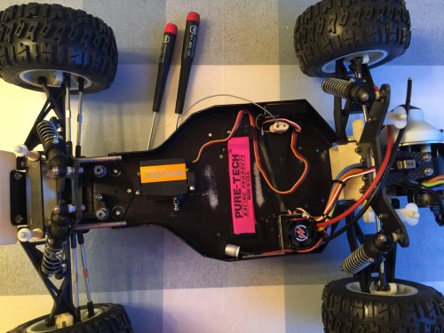

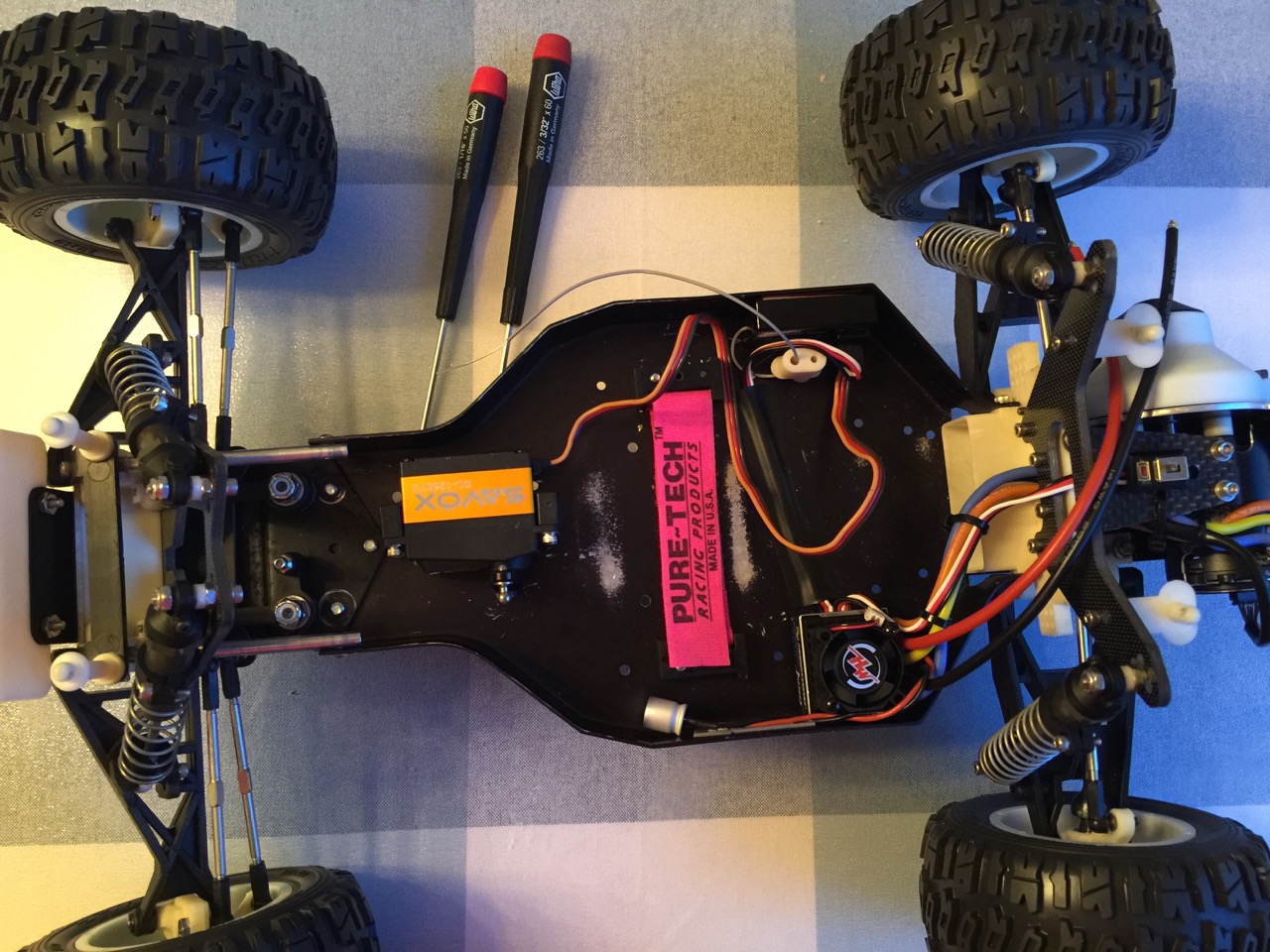

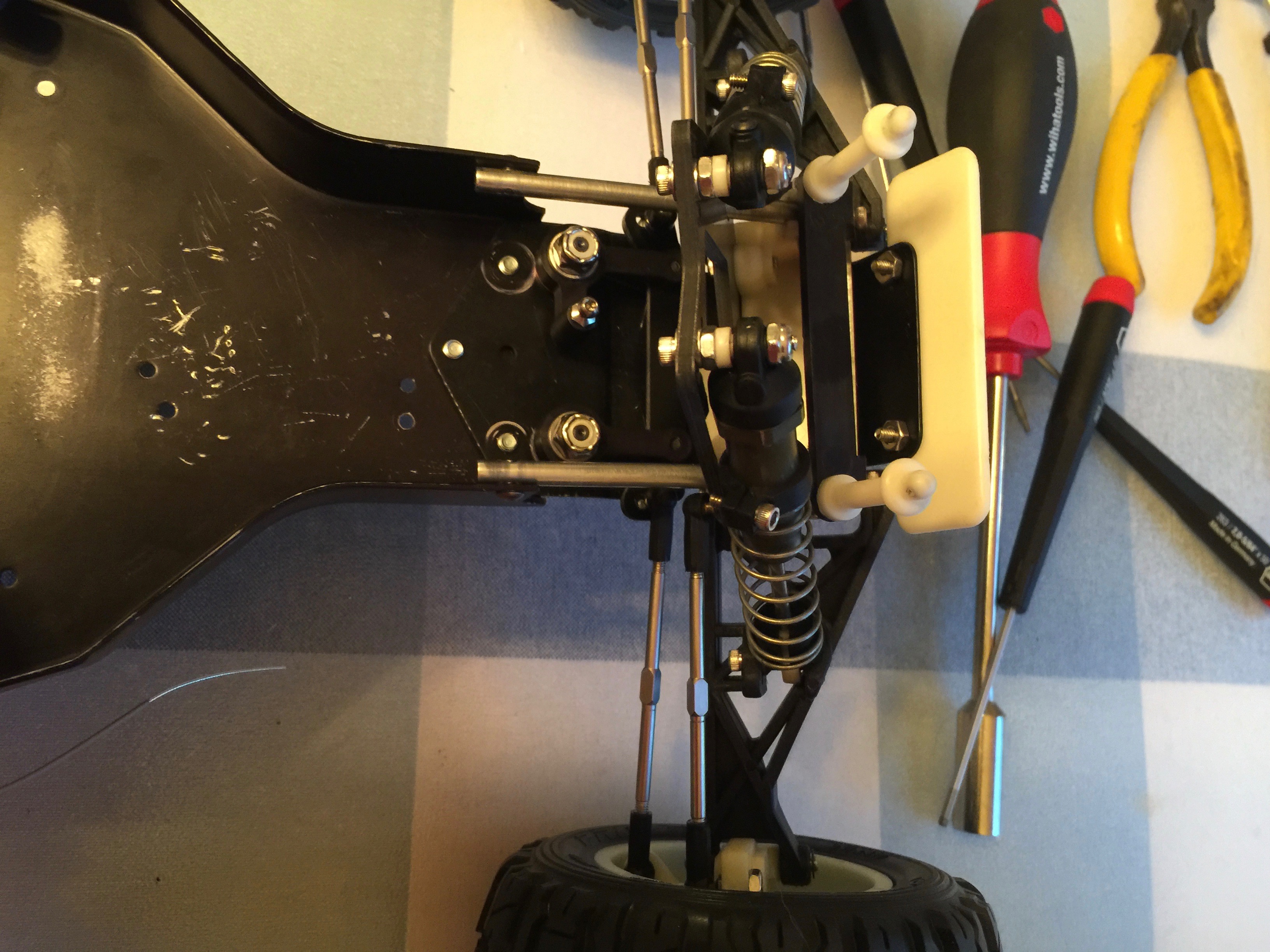

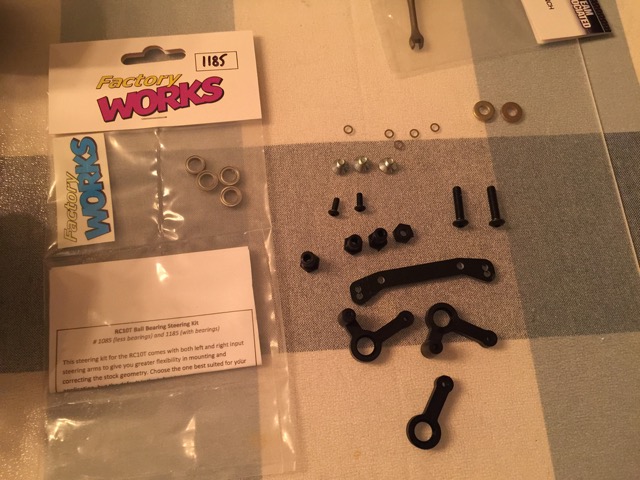

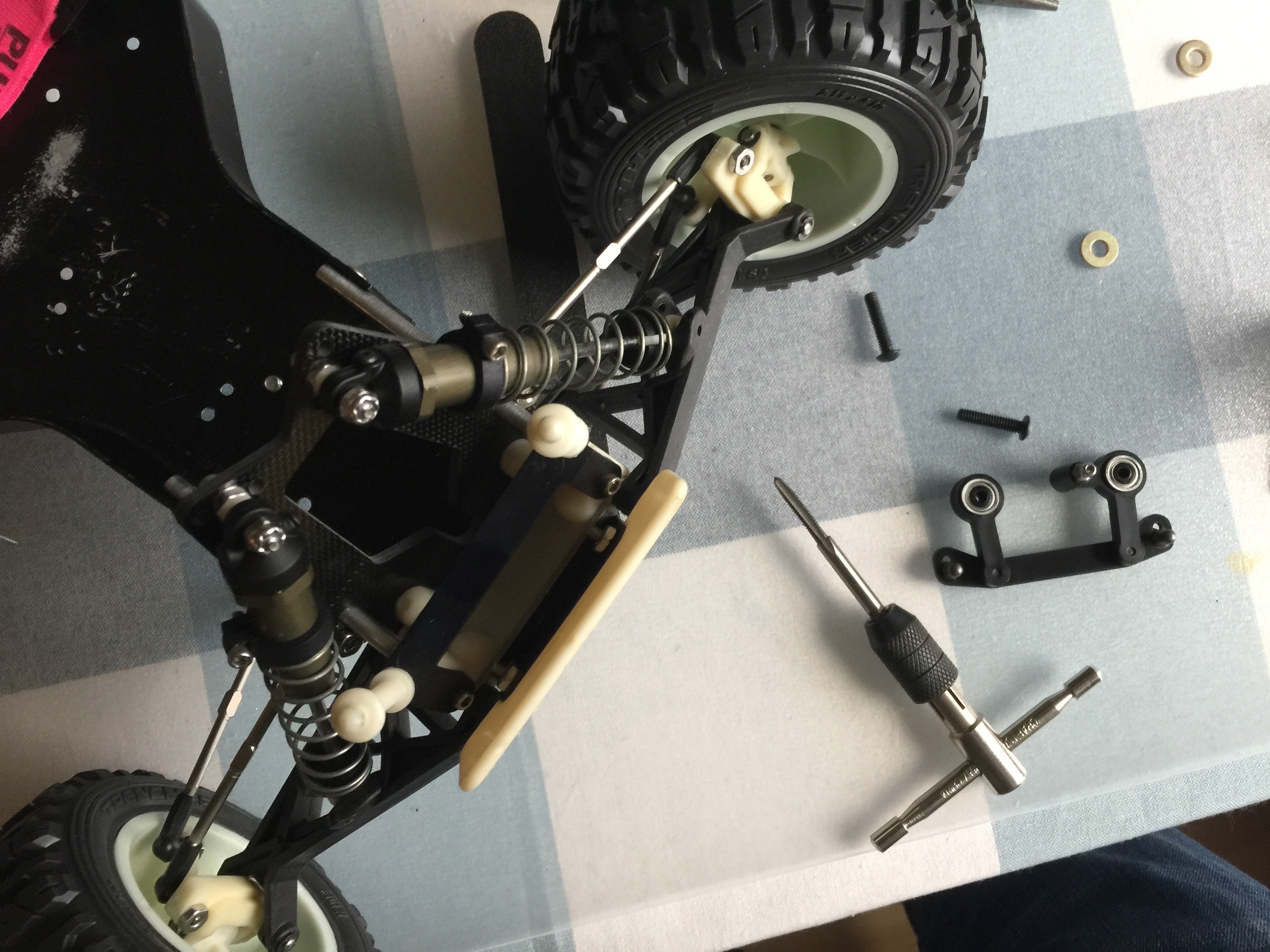

After some excellent customer service, I got the Factory Works steering installed. It turns out the older RC10T nose plates didn't have the front holes tapped. Mine are tapped now, and I went with some stainless nuts to top them off.
Any suggestions on NOT screwing up my new MCI decals???

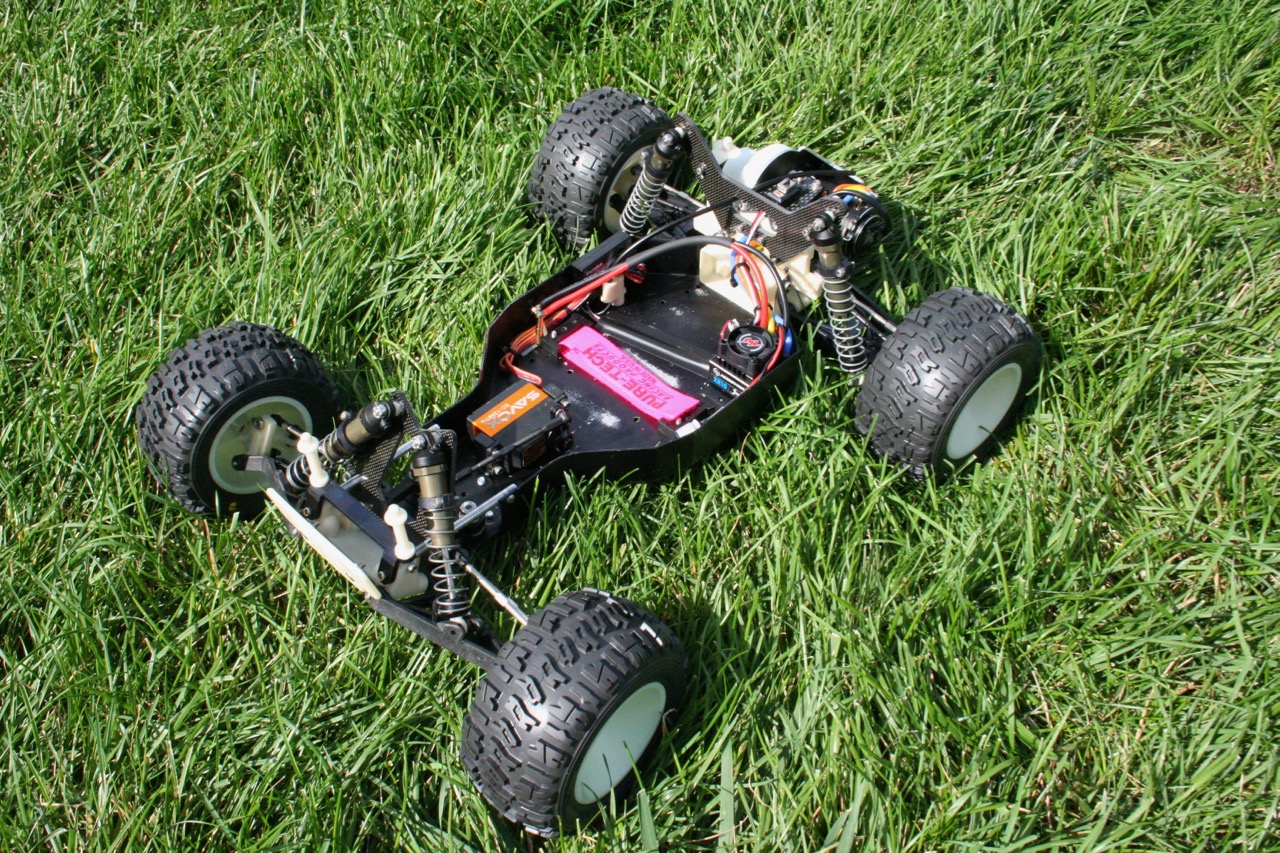

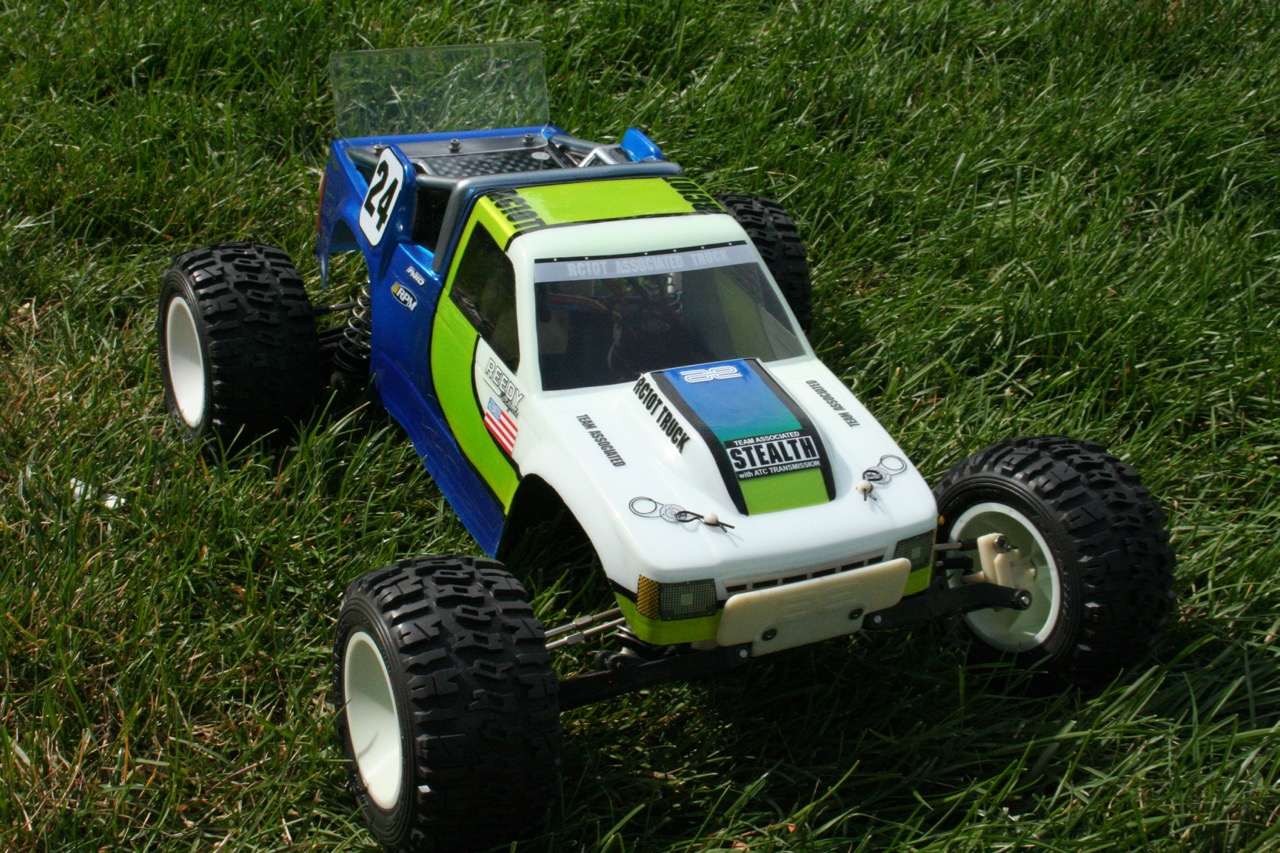

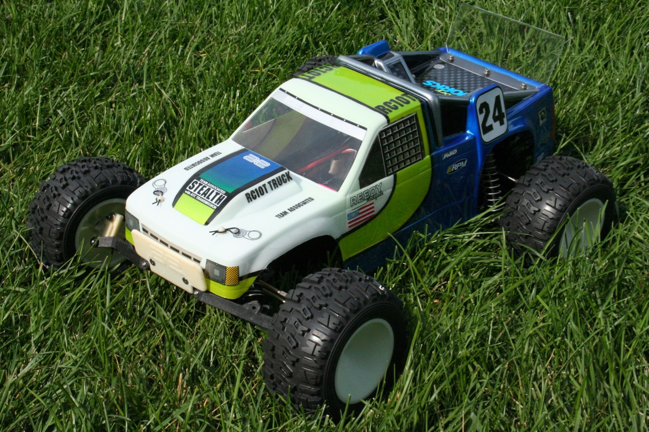

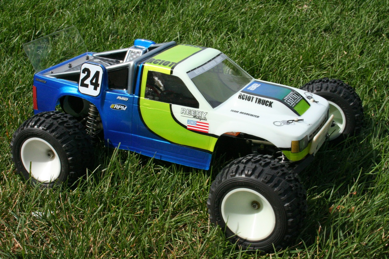

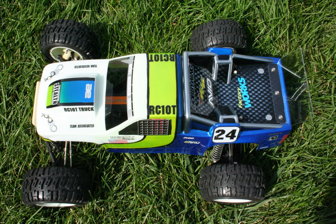

Well I finally got it into a running state. Picked up a shorty lipo. This is my first body painted in over 20 years. First time using liquid mask, and first time using an airbrush. I think it turned out pretty good. Its an homage to the box art using colors I like. I still need to find some white stickers to complete the look. I would LOVE a nice vintage sticker for the rear wing... I got some pictures before we go terrorize the parking lot and ball field. :twisted: The savor servo is WAY faster than I expected. So Im going to call this build a little new and a little old. My inner 12 year old is SUPER stocked to go thrash it some.
