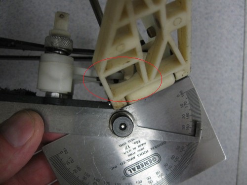

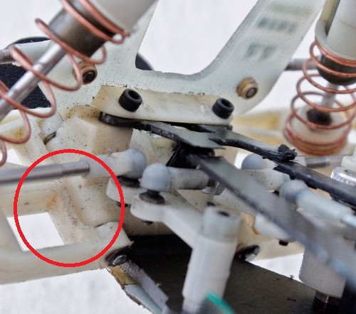

Looks good Justin. Will you notch the arms to provide clearance for the bell cranks? Maybe this was a driver mod or was it done by Roger and the guys at AE?

XLR8 wrote: Mon Oct 29, 2018 12:56 pm Looks good Justin. Will you notch the arms to provide clearance for the bell cranks? Maybe this was a driver mod or was it done by Roger and the guys at AE?
Do you have a photo of the notches for the bellcranks you are referring to? The arms were ground down to allow for clearance with the bulkhead; in my photo you can't see that because the arms aren't laying flat against the table since the steering/hub cause the arms to be slightly compressed. Just want to make sure I understand what you are referring to.

jbmeyer13 wrote: Mon Oct 29, 2018 1:21 pm
I'd bet you've seen these before Justin. You can see the notch in several photos of Masami's car but here is the best photo I can find that shows the notch. The other photo was taken by Curtis and is not Masami's car. The random shape of the notches suggests that they were carved with a knife -- an afterthought.

Yep- that's where the dremel comes in handy. Fred designed the arms as AE would have so it requires some additional work to achieve that clearance. I don't think anyone was ready for that surfs up mogul field so this was likely done quickly with a dremel to facilitate additional set up testing.

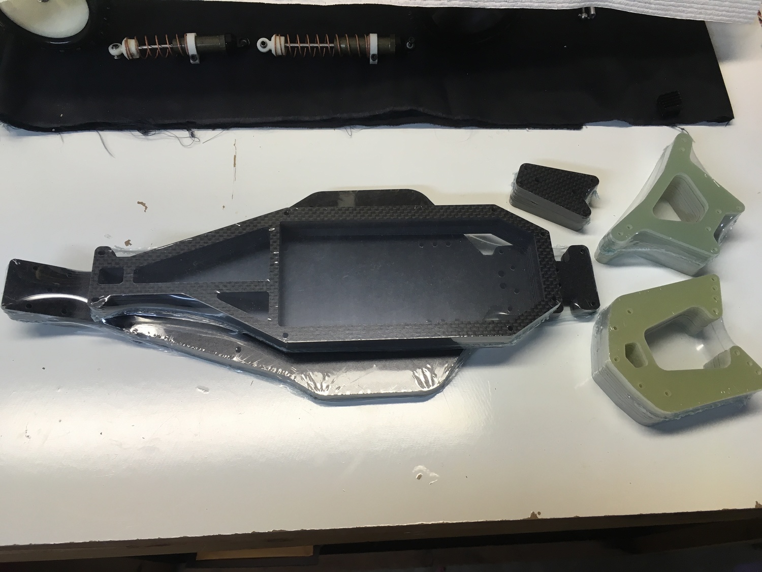

Just had a new round of chassis parts arrive on Sunday :mrgreen:
