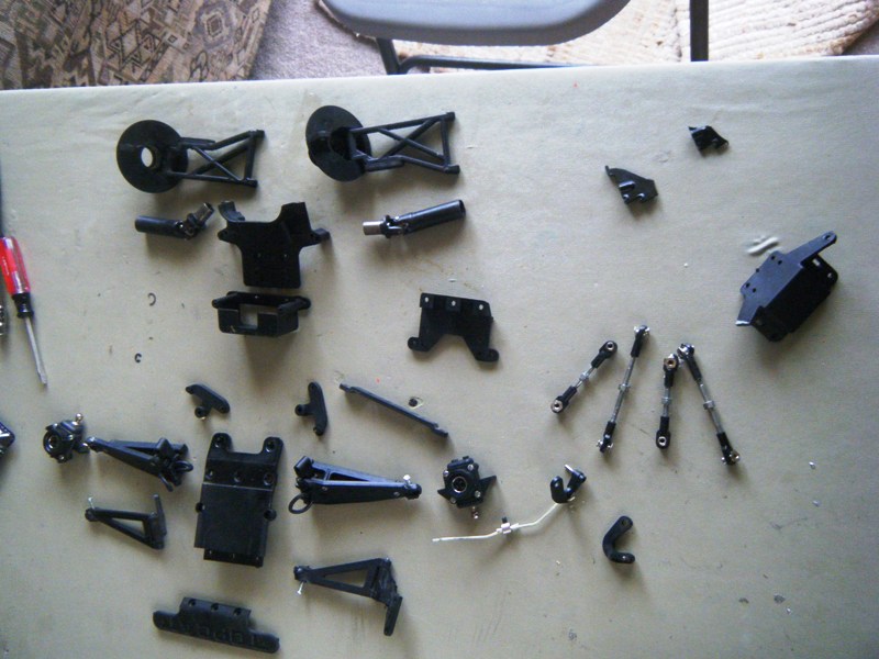

I have begun rebuilding my Topcat and have some questions I will post here with pics as I go.

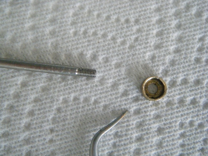

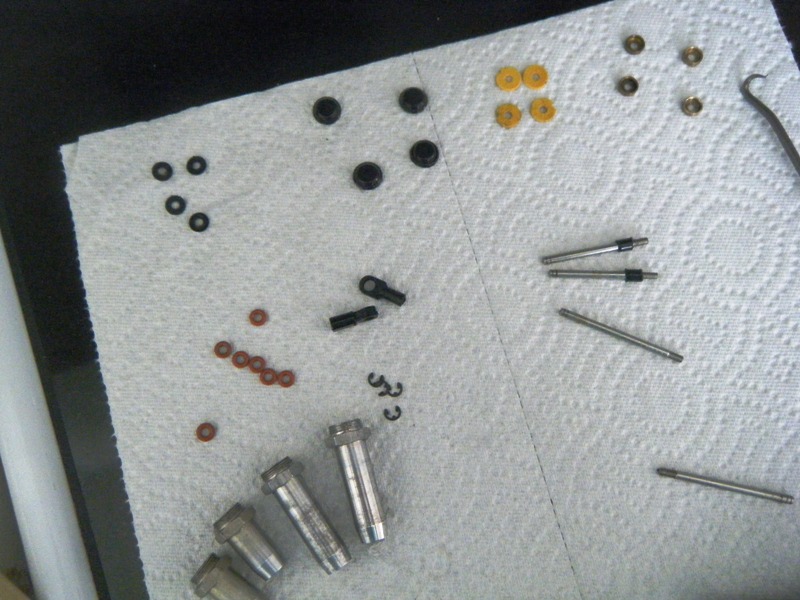

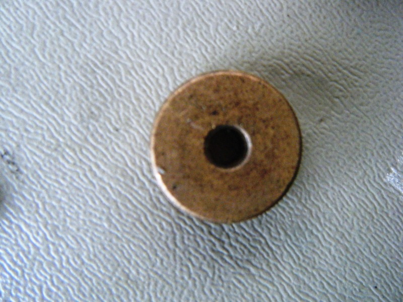

The schocks were seized and I have them apart now, I believe the pistons and o-rings both swelled from sitting in storage, there was still oil. I got them all apart. Are the Brass bushings that the O-rings fit in still available? Also, it appears one of these bushings is inside the shock body besides the 4 you can see I have removed from looking at instructions, I have no idea how to get that out so I will leave it. Other shock questions?
1) What current Schumacher shock pistons can I use?
2) What size is the snap ring in the bottom of the shock body?

Are the brass bushings still available? NO!
What new Shumacher pistons will fit? None that I am aware of.
What size is the snap ring in the bottom. Dont know.
A lot of help I am eh? Hehe.
I got some of those bushings if you want? It is possible to get them out without too much trouble. The trick is to insert an allen key in the top of the shock and gently tap around the edge of the bushing until it frees up. Then you can dig it out with a pick.
Are the pistons that came with no good? On my last Cougar build I sanded down some newer 1 piece pistons but thats lot of work. Maybe some RC10 pistons will fit. Have not tried.

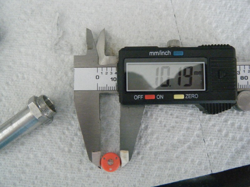

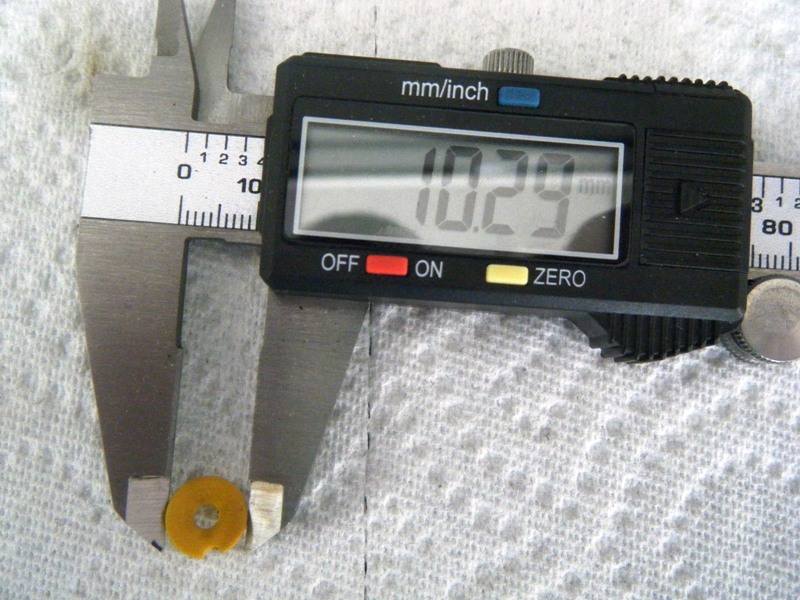

I may try to rebuild them with these Losi ones. Only 1/10 of 1mm off. Hmmmm? Yellow is original, red is Losi.

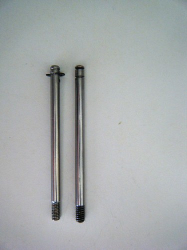

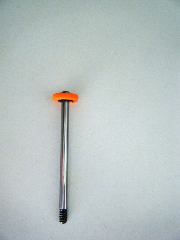

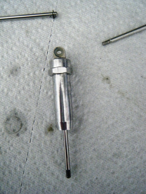

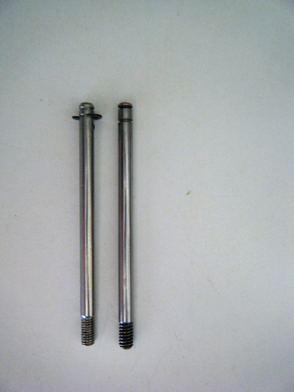

Thank you, the losi pistons are too thick however I have Losi shock shafts the are close enough to same length so I think I may be on to an easy to source replacement for shock shaft and piston set up.
I'll need to find some 8mm snap rings before I can test though. Losi shock shaft on right.

I was able to salvage a snap ring. I can report the Losi shock shaft and piston work great, no leaks and silky shooth operation. I am using Losi Piston #55 as I had them but any should work. I will likely use a more modern and durable ball end on the shaft as well.

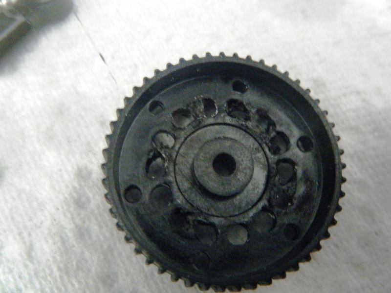

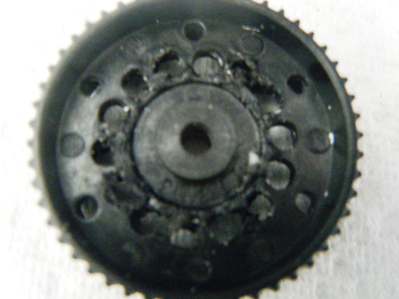

I may have run into my biggest hurdle. It appears my diff pulley is not so hot. It almost looks like it got too hot as some of the holes appear a bit melted and odd. They will still hold a ball but not normal for sure. Odd for a car that does not seem run much ever.
Re: Top Cat Rebuild Has Begun - Some Questions
Looks like the diff was run too loose perhaps and got very hot.
