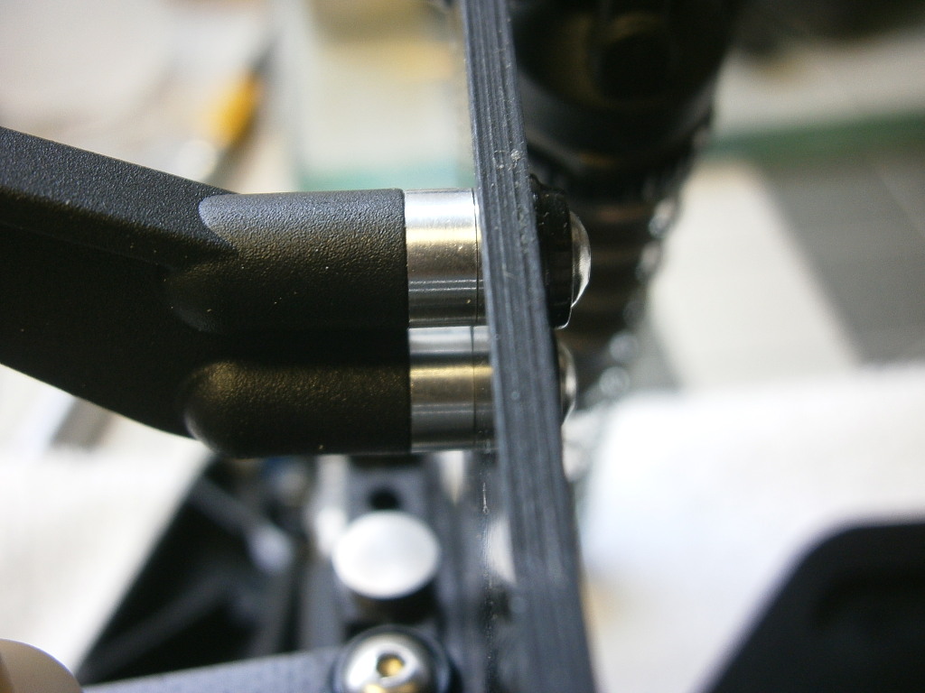

You guys probably know by now, I'm not one to leave good enough alone!
I made these aluminum "sleeves" to go on the ends of the wing mounts. That small step down in dia. just kept bugging me. It sort of looked like it was the wrong part to be using. I took some 1/4" round bar, drilled a 11/64" hole in the end (using the lathe) and sliced off a 3mm length, 4 times. Now the mount looks more complete.

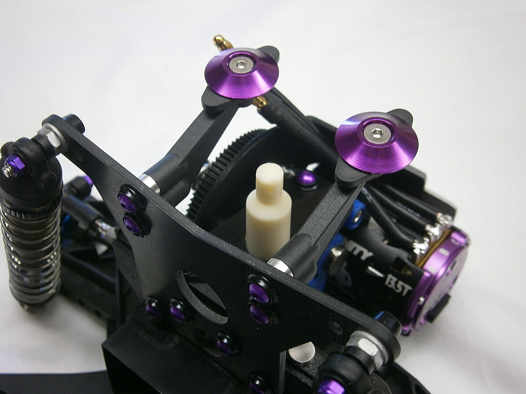

Wow, didn't it had been so long since I worked on this build.
I got a little bit of purple stuff installed, screws, wing buttons, battery hold down with some purple stand offs and a Trinity Monster Max 13.5 motor all dressed out in option parts!

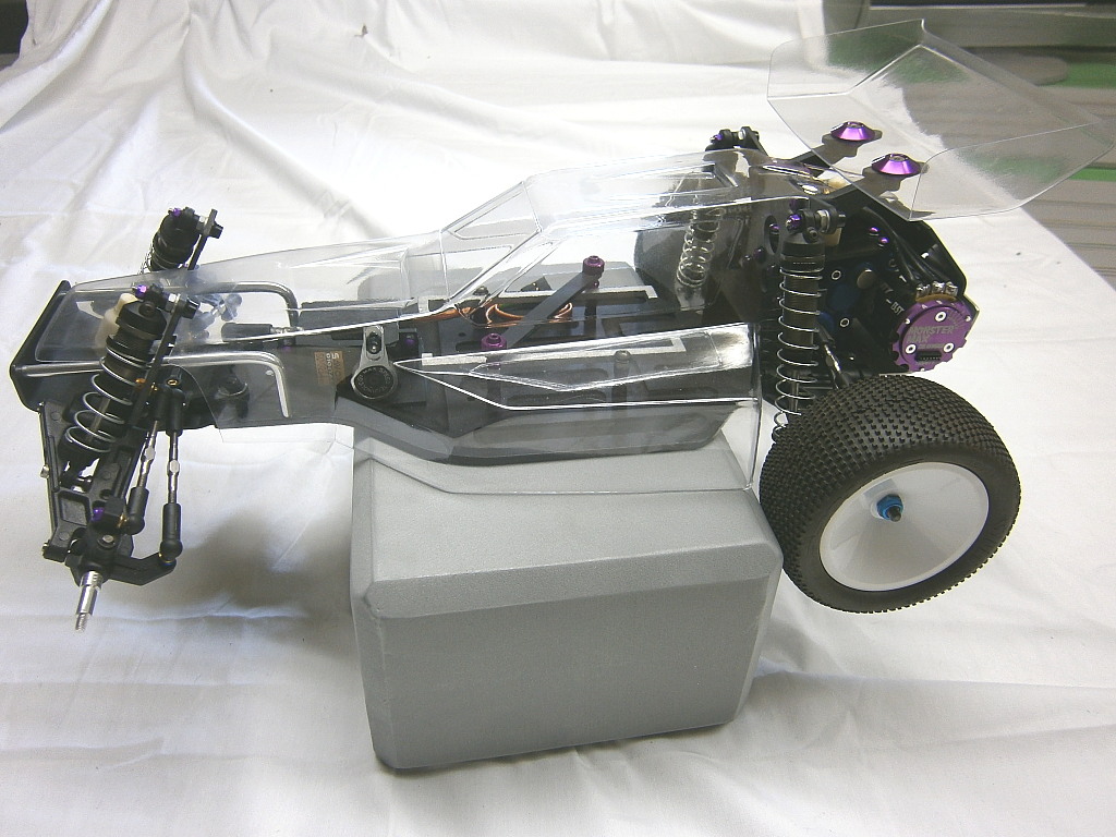

OK man (XLR8), this is what I have, nearly trimmed completely... Sabula Tech re-pop of a Jammin' J Jumper with the back end cut off, Wing is an Associated.
(The stand is a yoga block the I got from my local WallyWorld. It was marked down to 3 bucks on clearance :mrgreen: )

Oh yeah, that looks great. So you left a section of body running between the wing mounts to catch the body post?
Clever use of a yoga block BTW.

XLR8 wrote: Thu Jan 17, 2019 11:02 am Oh yeah, that looks great. So you left a section of body running between the wing mounts to catch the body post?
Yes, I figured that was the best way to secure the rear of the body. You can remove the body easily without removing the wing.
Yoga block works but it could be an inch or so smaller all around. I don't know if they come in different sizes... I'm not yoga qualified :mrgreen:
