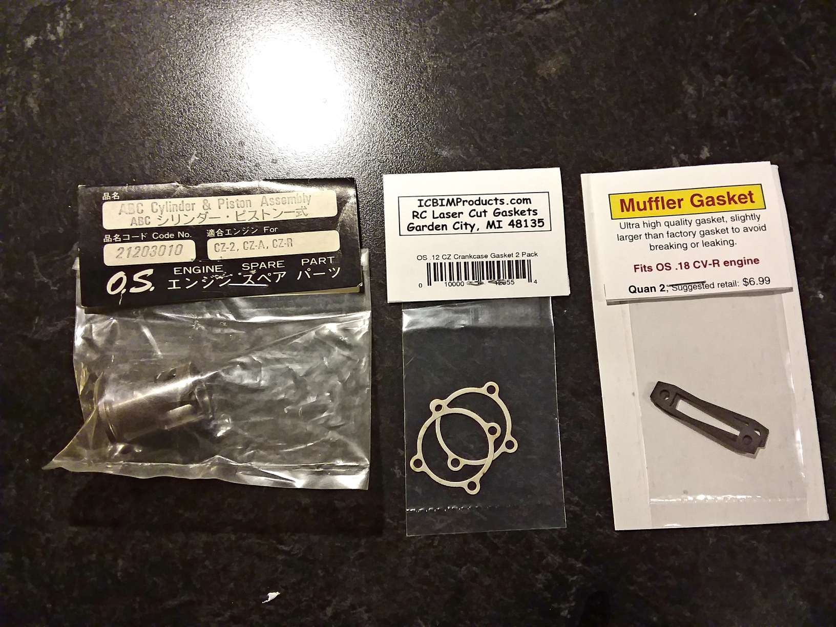

Serious goodies camw today. Gonna get that 33 yr old mill runnin again. I still need a cone starter

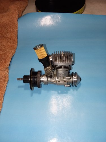

The engine has great compression again. Getn ready to install it for the last time hopfully. Cant start till fri. Thats when the starter comes in, i could use the factory string but dont really want to

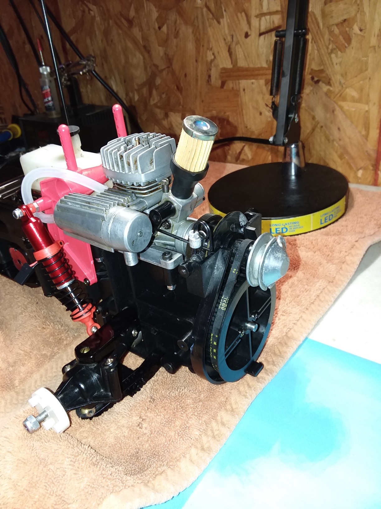

Re: Kyosho Nitro Brute Restoration
Cleaned up nice. Do you think it'll cool properly, or do you think it may need an auxiliary fan?

Post by coxbros1 »
Prolly need a fan like the Rampage did.
Post by jkelm24 »
It will cool just fine if you cut the needed hole in the body and if the mixture is set correctly. If you run it too lean, it will run hot. But if the mixture is correct it will run within the appropriate temp range. If you live in a really hot climate, you could put an optional aluminum head on it. It would use the same as those available for the rest of the CZ .12 family (CZ-R, CZ-Z).
You might consider rotating the existing cast head 45 degrees so the fins are parallel to the air flow. :wink:

Post by coxbros1 »
I concur on the rotation. I had it like that but saw the factory os pic was the other way, so i switched it to look box stock. On fuel, yes i run em on the safe side after break in....i race 1/8th nitro buggy in the summer and have a pretty good handle on the mixtures, my rampage head is tiny compared to my GTs OS CV red square head, it runs much cooler than the cz, so i put a small fan, like on an esc, blowing right at it and it solved the problems. I dont like to run em much over 230 degrees
