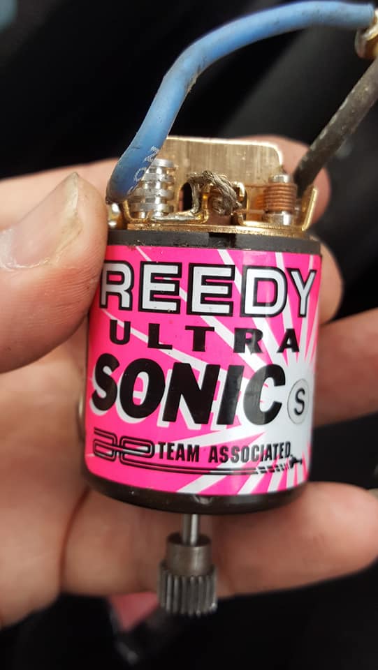

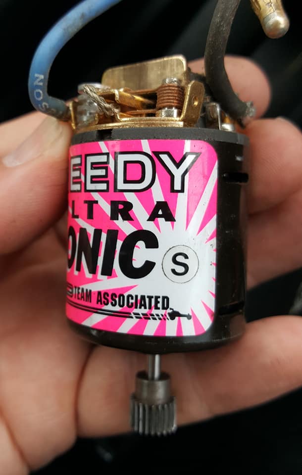

I also have a Reedy Sonic '?' to go with my Ultra Sonic 'S'.
Condition is pretty good too. Like new in fact.

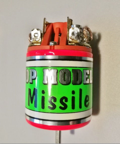

About a year ago i was also offered a TOP Models 'Missile' motor, which was a popular choice of motor bitd over in the UK. TOP Models had a serious race team on the UK circuit and were also the main UK importer of the Pro Radiant.
Having been involved with the TOP Models team (and ex-owner) and having recently acquired his old Pro Radiant shop stock - a lot of it! - i kind of figured a Missile would make for a nice addition to my collection. The motor in question was in dog rough state and i got it for less than a tenner, thrown in with another Race Prep motor. Bargain.
Bit of TLC required.

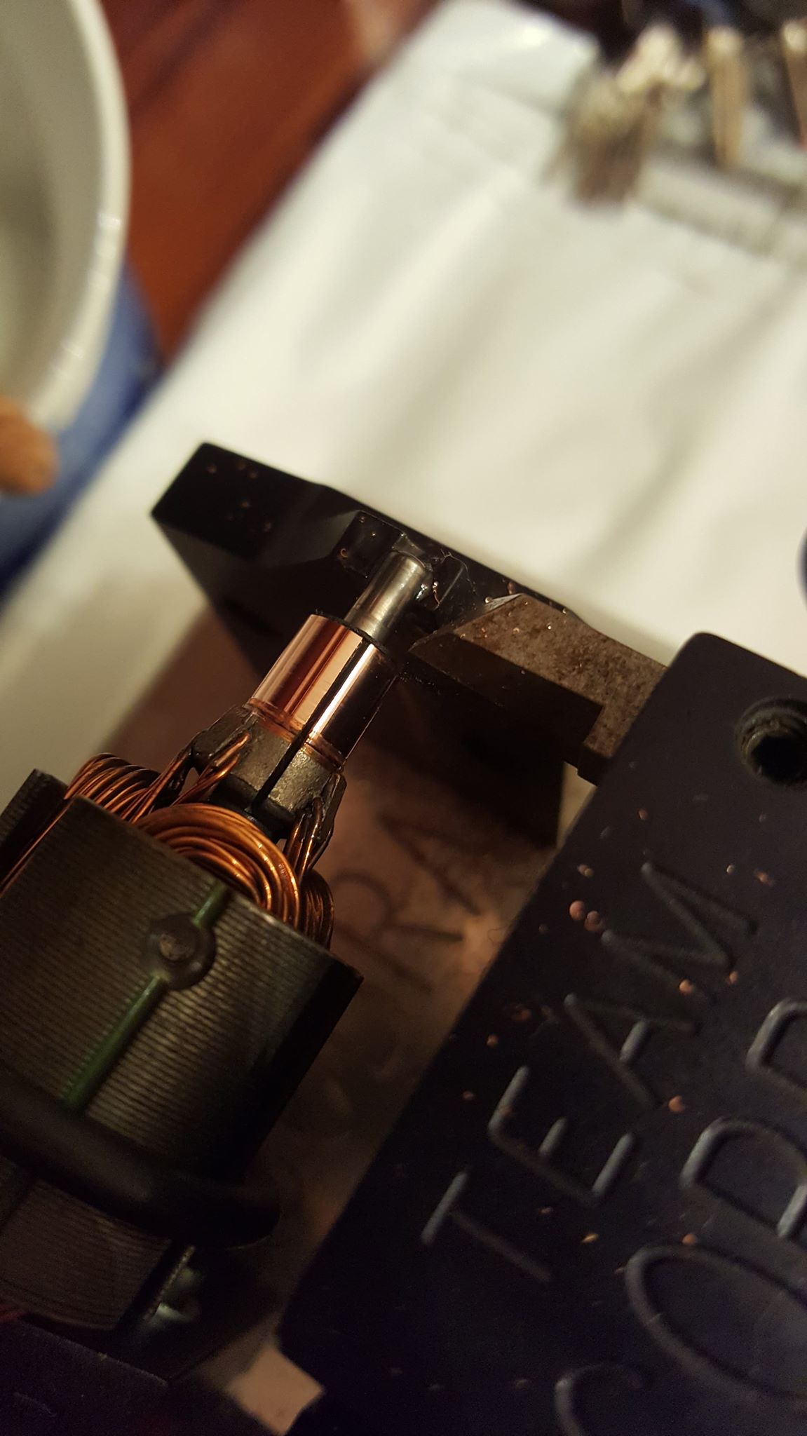

On my dyno it performed badly, so i decided to give it a once-over. Plan was for a zap and skim, but then all sorts of TOP Models goodies began to appear on my doormat, original stock endbell ornaments and even new, original motor decals.
Next up was to get the armature out for a check and a skim. Quick look confirmed it as a 15 triple, and a few minutes on our Cobra comm lathe and the comm was as good as new
- dinglem
- Posts: 1381
- Location: Lichfield, UK
- Has thanked: 244 times
- Been thanked: 633 times
Re: Motor Collection - Old School Horsepower

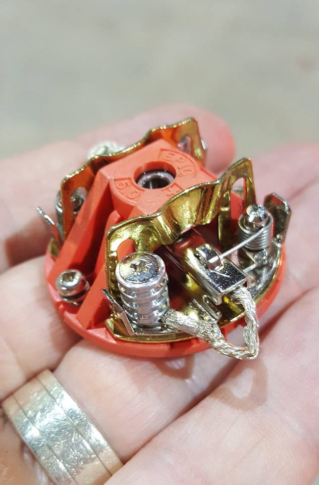

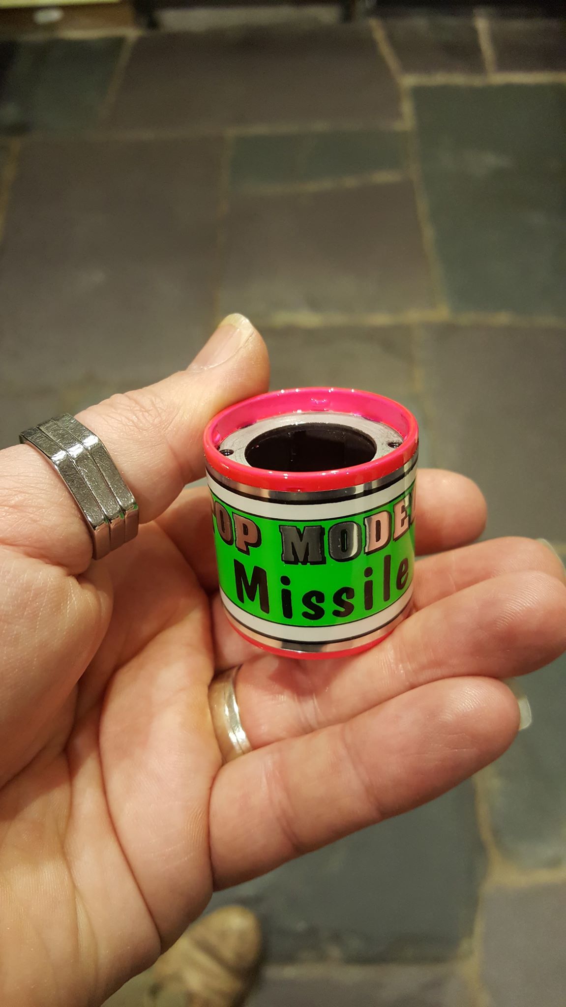

Next up, the stripped can went off to a guy known in BMX circles as 'SuperbikeDan'..... the guy i use to powdercoat my 80's BMX restorations.
He quickly matched the paint, stripped the can and then heat tested everything before going ahead and recoating the can for me. Proper dayglo pink as it would have originally been.
Once back, the original motor decal was added and it was starting to look the part.
Next up i rebuilt the cleaned endbell with original TOP Models Bling.
Then the whole lot was sent off to a guy who made BRM motors, a friend of Mr.Reedy himself by the name of Glyn Ward. Glyn ran his own race team bitd and had a lot of success. He offered to fettle and rebuild the motor for me, checking the armature, and health-checking the magnets for centre and strength.
He sent me the final rebuild picture earlier today, and the before and after dyno figures show a massive 10,000rpm improvement for virtually identical current draw.
An amazing result from what was a very tired and beaten up motor.

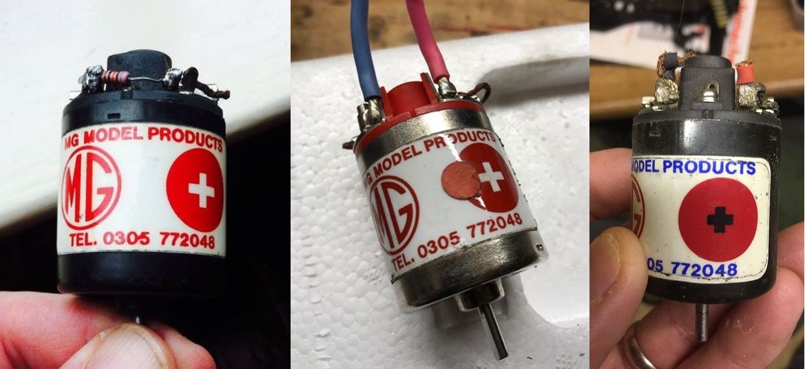

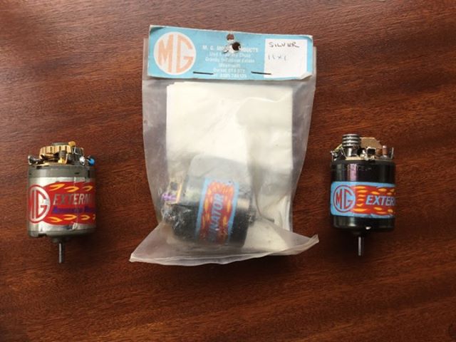

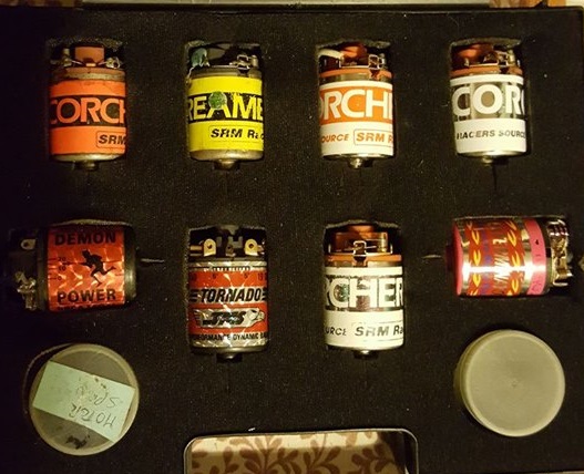

I was also very humbled to have been offered this selection of very special MG motors a few weeks ago. I was contacted out of the blue asking if i would like them for my collection. The owner was a Team Schumacher driver through the early 90's and used MG motors built for him by Mick Goddard. These range from 11 - 13 turn and were used at National level in the UK, and some were also special builds using 1.32mm gauge wire specifically for 4minute sprint racing in the US, with those motors having been used at the Florida Winter Nationals. The original owner has an amazing racing history and incredibly all he asked for in return for this massive haul was that i made a cash donation to charity. An amazing gesture indeed.
