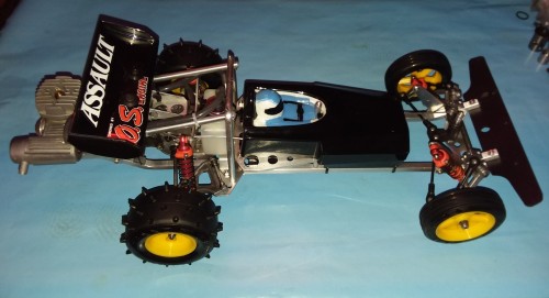

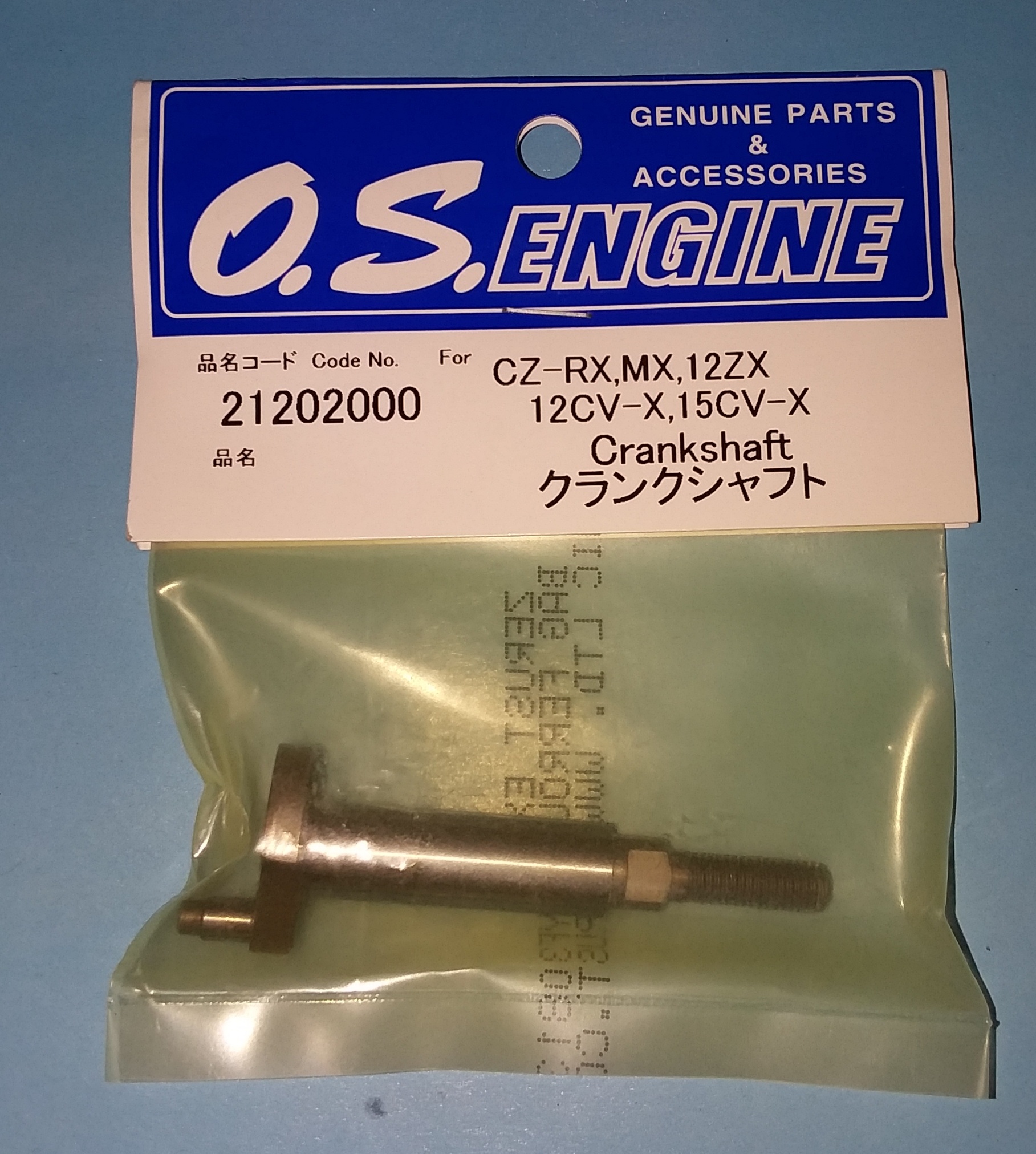

I cheated just a little, i put the engine from the "mint" car in while i am waitn on that crankshaft, hopefully have it tommorrow. (No i am not gonna start this engine)
I also borrowed the front body mount while i fabricate one for this car. I really want to to make a bumper mount glow igniter like the original. I will see what i can come up with. Shock parts will be in today for the "mint" cars shocks which i will borrow for the basket case until my new shocks arrive from japan. It will be on all four tires later today!

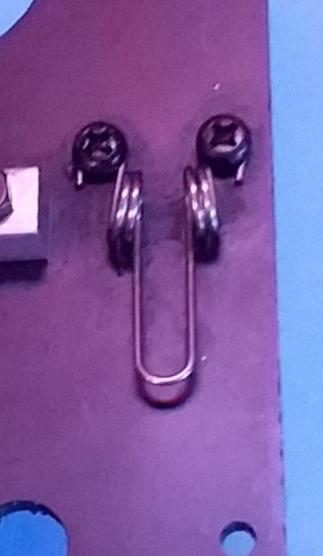

Anyone know what this spring is called? I need one

Well, I know what it looks like!
I'm not sure if they named it after that though...
Sorry everybody, I'm a 3rd grader.
If you go to Lowe's or Home Depot they have these slider drawer cabinets in the hardware aisle with all kinds of oddball fasteners and springs in there. That may be your best bet if no one knows.

I found one on ebay, bit pricey...its called a hammer spring, from a gun. Got a Traxxas glow plug lead comin for the wire

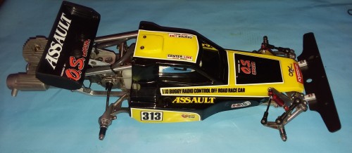

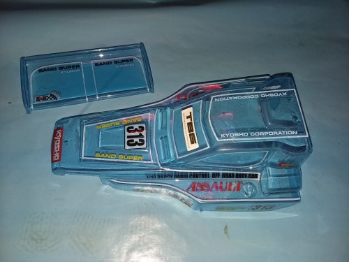

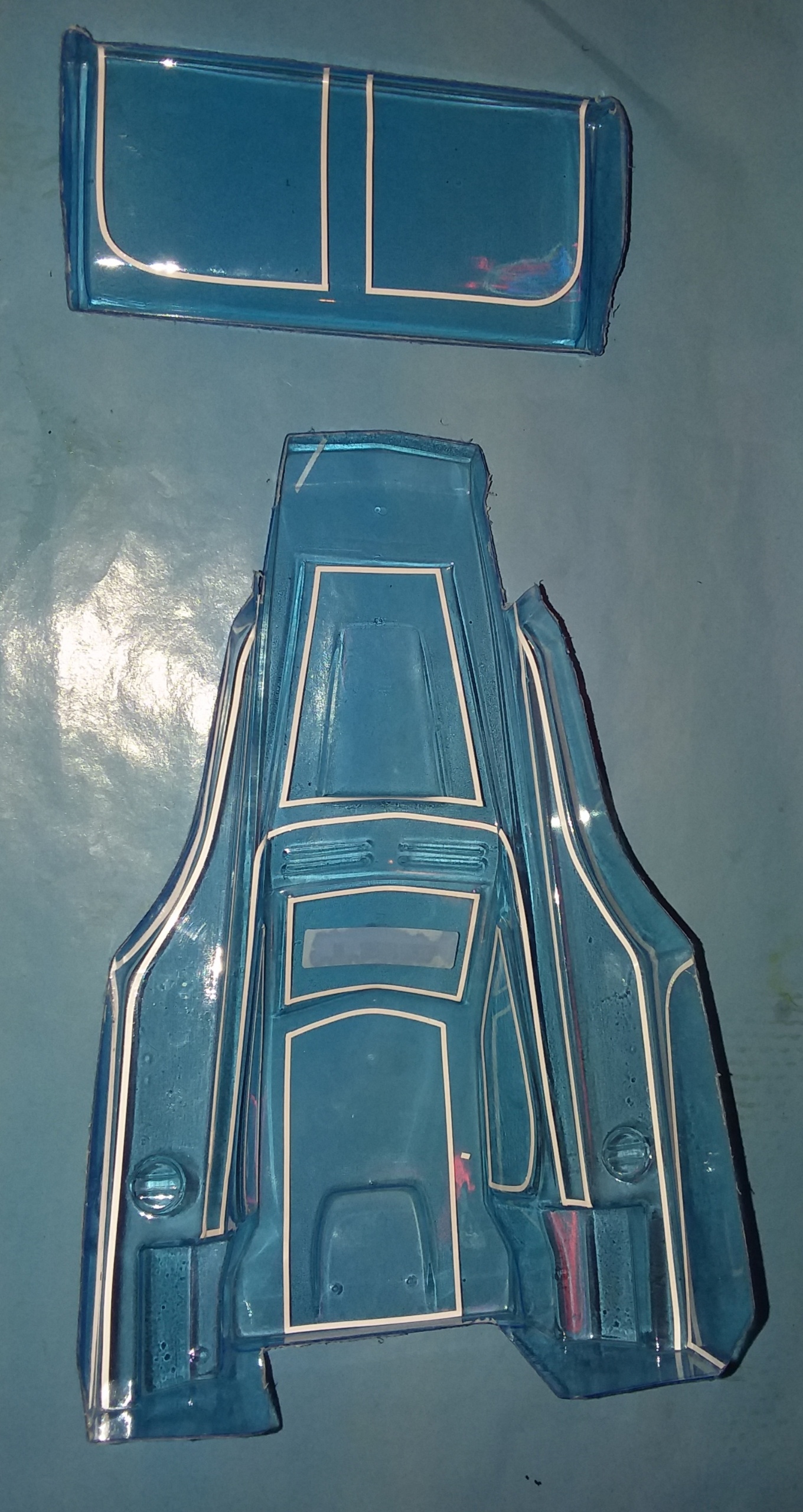

This is the new body i am doing with all stripes and decals applied on the inside

Hope this works, or i wasted alot of time and $

Make sure those stickers are really stuck down good or you will get bleeding

I used a hair dryer to warm them up after they were applied and pressed them good. The quality of these decals are off the hook. Great adhesion. The pinstripe not as good. If it bleeds i can go over outside of body.

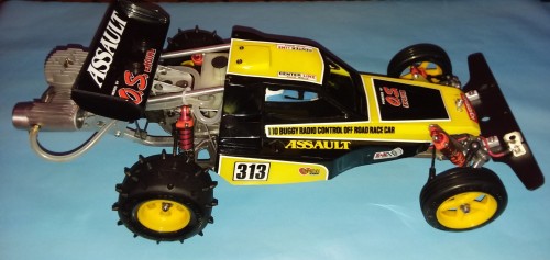

The engine ran perfect. Obviously its new so i had it set pretty rich. I ran 3 tanks thru it on the driveway just babying and running an oval checking temps, never went over 208 degrees. It did want to wheely if i stabbed off idle, so once its leaned out gonna need weight up front.
Couldnt believe i was driving it, engine never missed a beat after i got the needles set. got roughly 50hrs in the restoration. I wasnt driving on these original tires. Gonna get some good pics hopefully tommorrow for Marches "build of the month contest". I got part of the bumper glow igniter made. Spring on the way for other side. The pic below is after the 3 tanks today, once i switched the wheels back

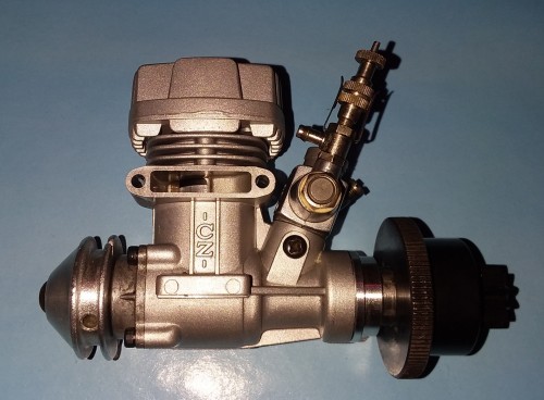

Unfortunately my CZ-2 seems to have no compression left in it. I'll be dismantling it again to check if the piston goes through the sleeve (tip from my LHS which I didn't know about).
