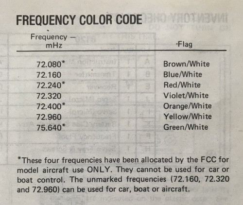

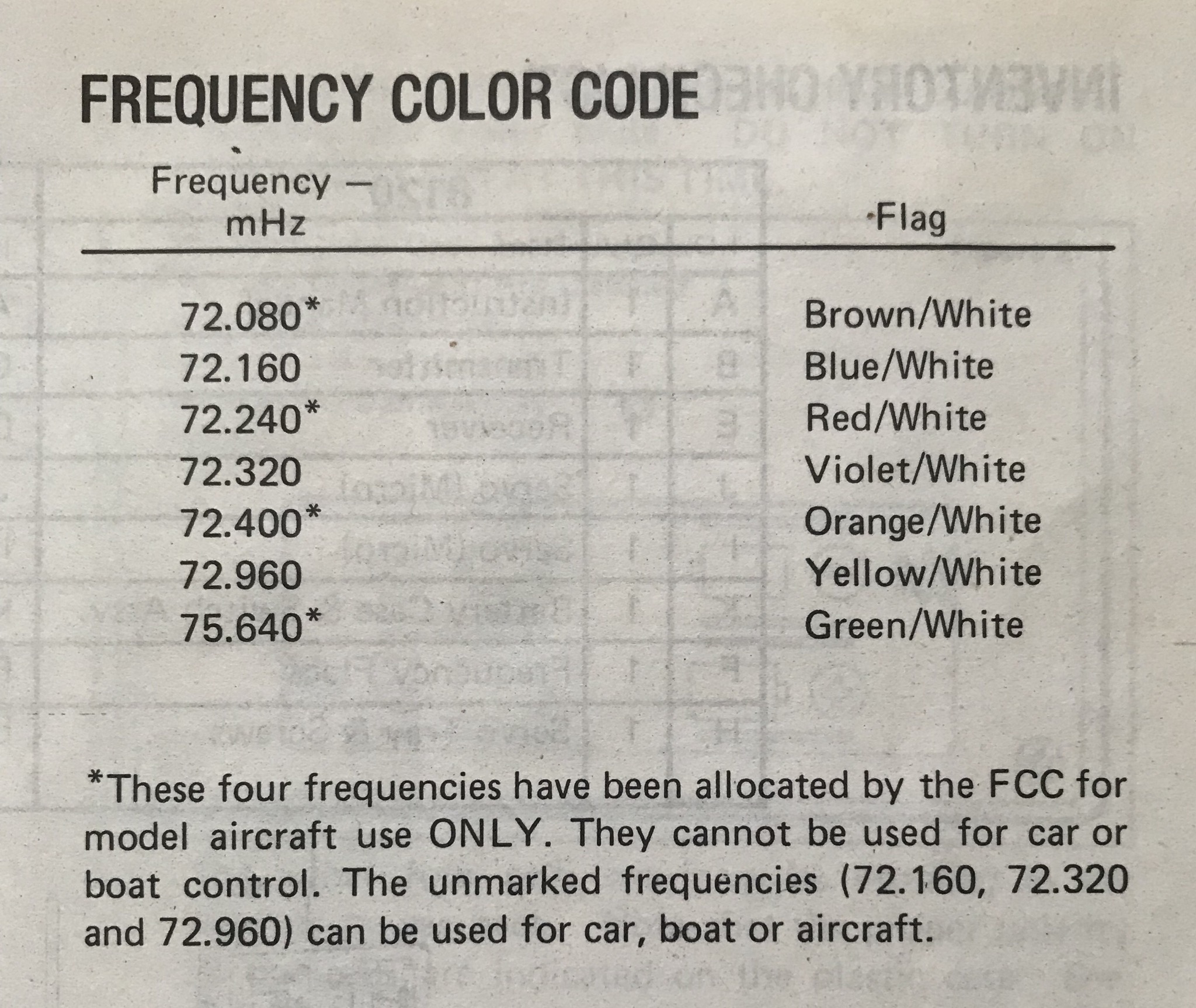

At some point, 72 became air only in the US, right?
75 was most popular at the club level, but I remember a lot of big time racers using 27mhz... maybe because of its international compatibility?
Posts: 12336
Been thanked: 3919 times
Re: 27 MHz vs. 75 MHz
Yeah I want to say by the early 80’s 72 was all aircraft
This is from the manual in an old Cox radio I own.
Interesting that there was a 75mhz aircraft only as well
