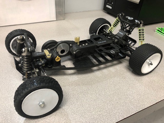

Might run at VONATS this year, haven't decided yet.

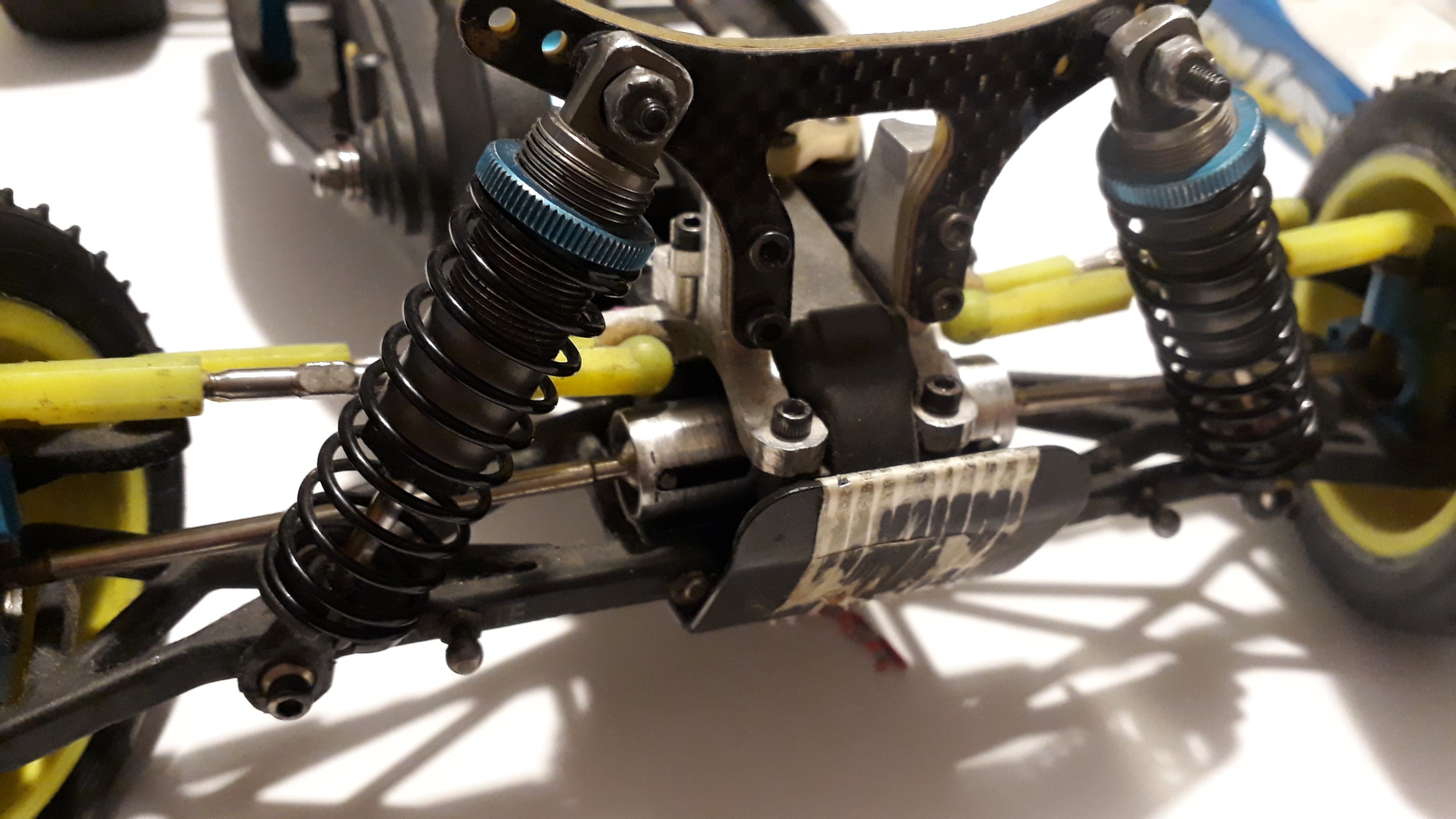

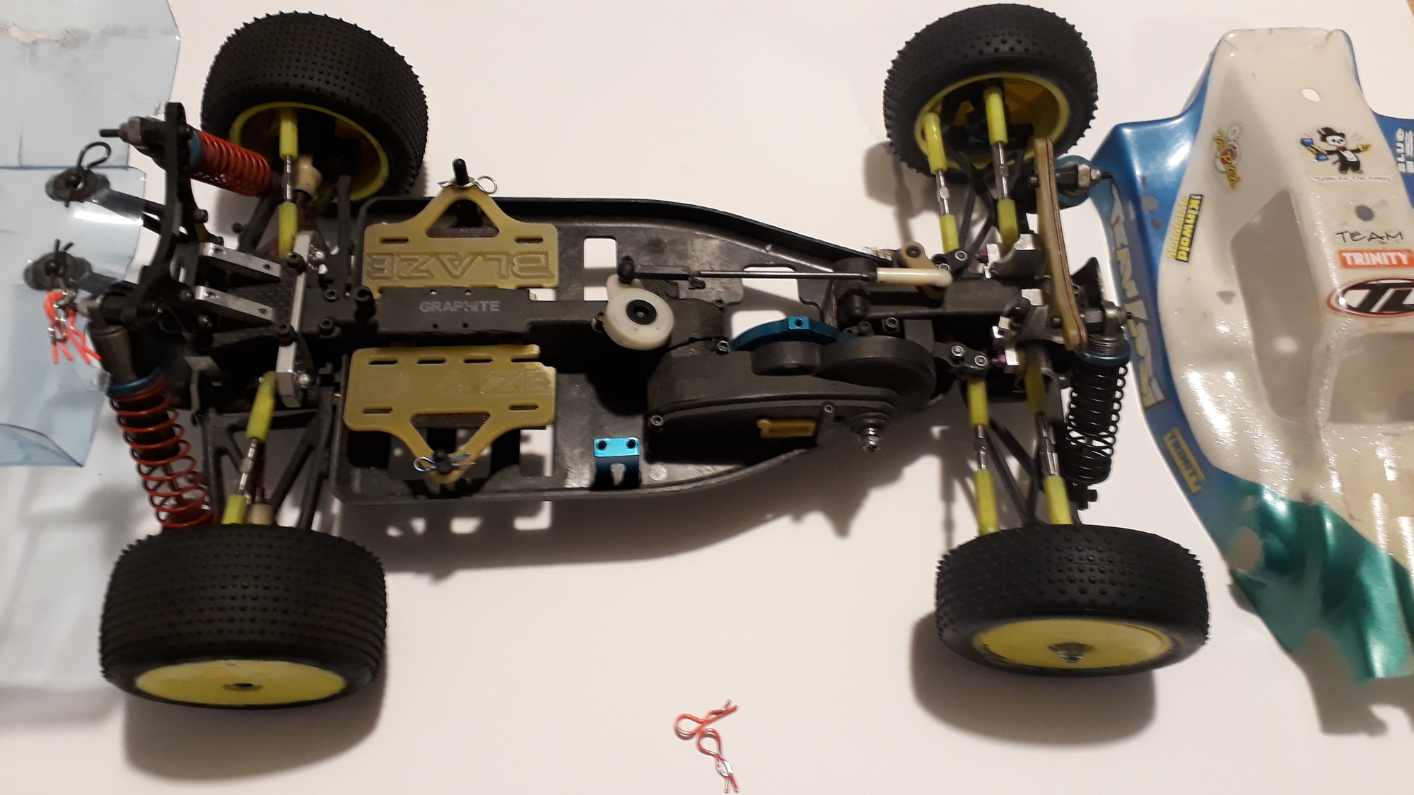

I have been very much into xx4 and all Losi cars few years ago. Generaly I started racing jest after Kinwald won WC in1997 and the Spashet diminated on road WC in 1998 . Till 2012 i raced my XX4 and suffered its all downsides with lipos and BL motors - especialy as we race in Poland at huge 1:8 tracks with big 2-3 meter high jumps or long 5-7m long flights .
It forced me to make some radical upgrades . I did not have time to share it on internet so those would be the firts pictures posted on the web- generaly all the mods did the job . If you like to se more let me know.

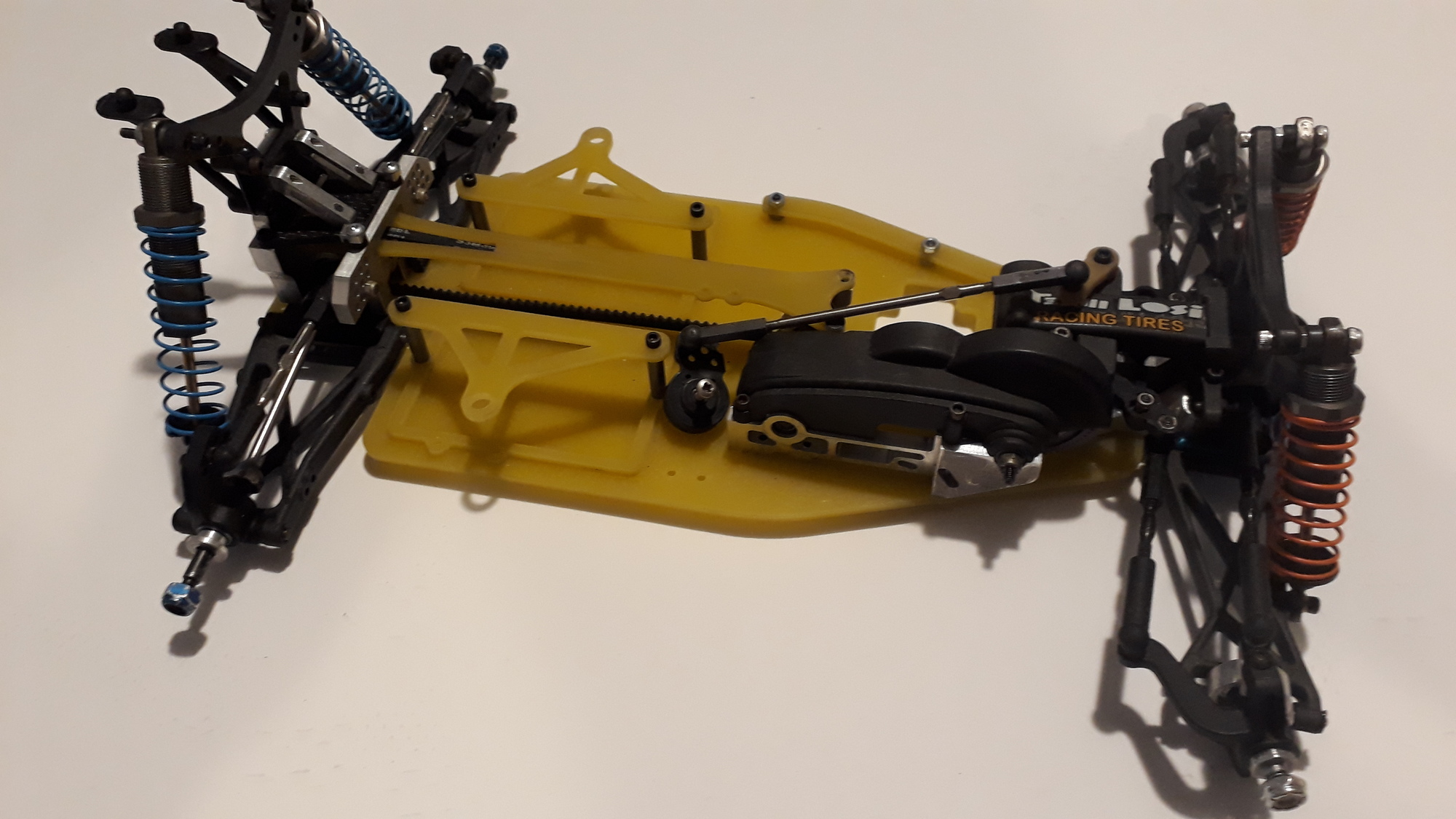

I also spent some time on my own interpretation of XX4 it was mentioned for carpet racing - but since itvwas ready i had no time for buggy racing as my first child was born. So this "creature" never hit the track.

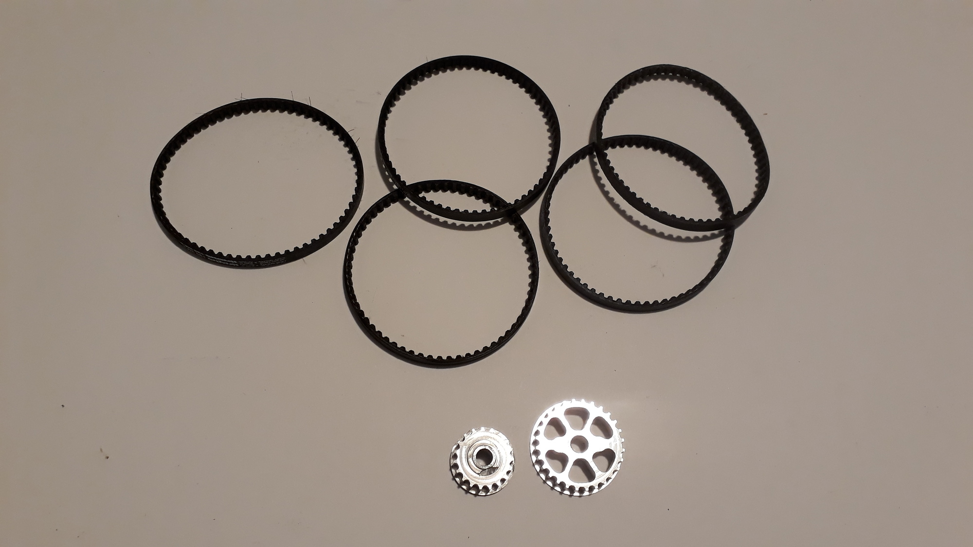

Mid belt was a real disaster at some point- when original belts were discontinued the all substitutes didnt last long in 2M module. I designed 3M belt pulleys machined them on CNC and changed mid belt to 3M - there was a small ratio difference but it was like 1% i dint notice it on the track ( probably this drive ratio issue forced Losi to use this stupid 2M belts
