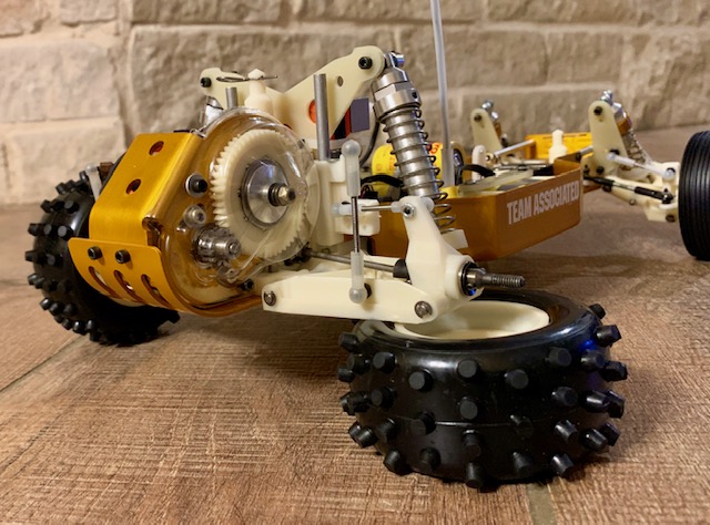

Started to make some corrections and finish some of the assembly and wiring.
